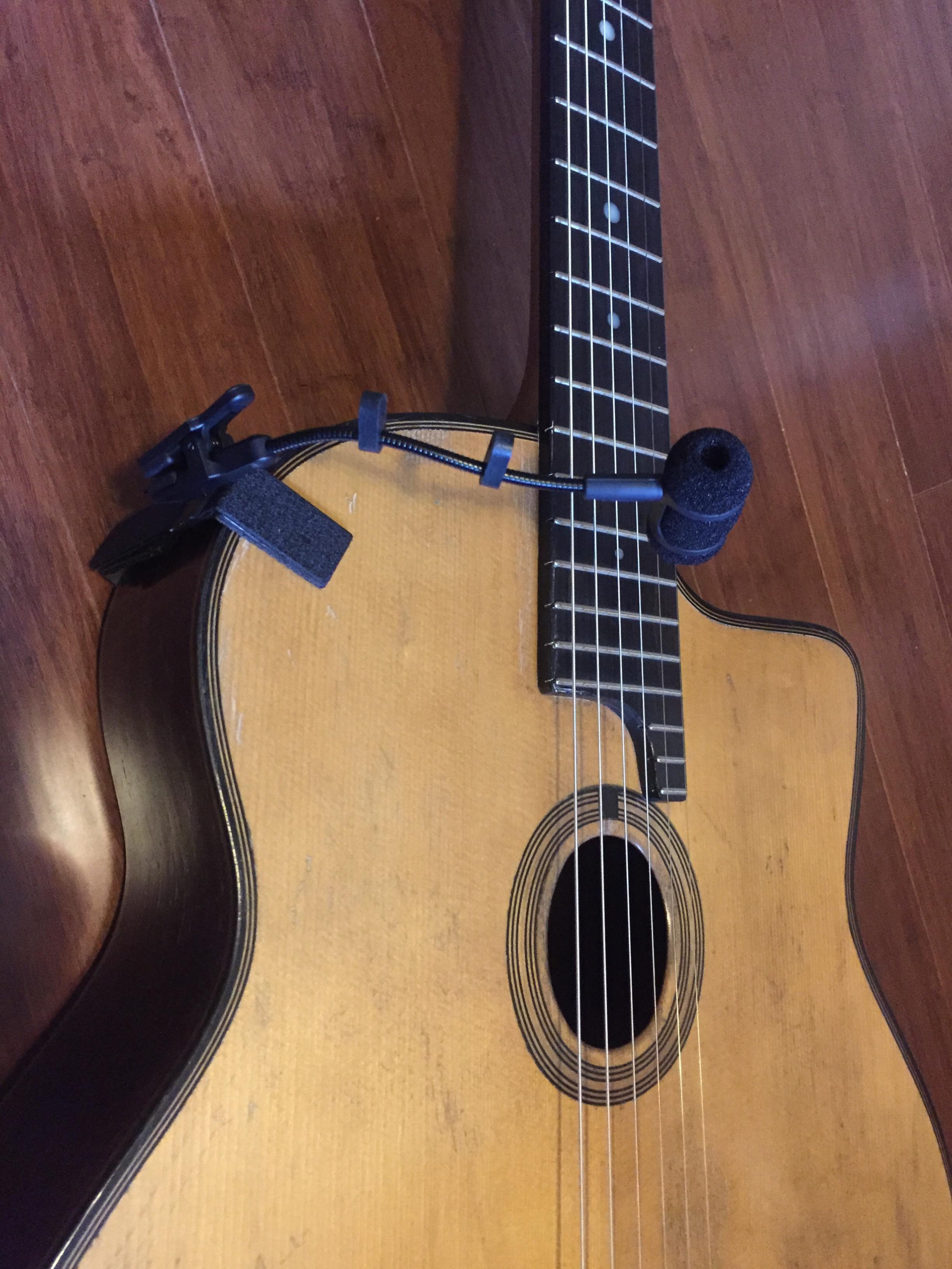

Fun project of mine I thought I'd share. A DPA-style gooseneck mount for my trusty Audio Technica AT831b held on with... suction cups?!
Picture attached and more details here: http://paniquejazz.com/blog/project-dpa-style-gooseneck-mount-for-audio-technica-instrument-microphones/

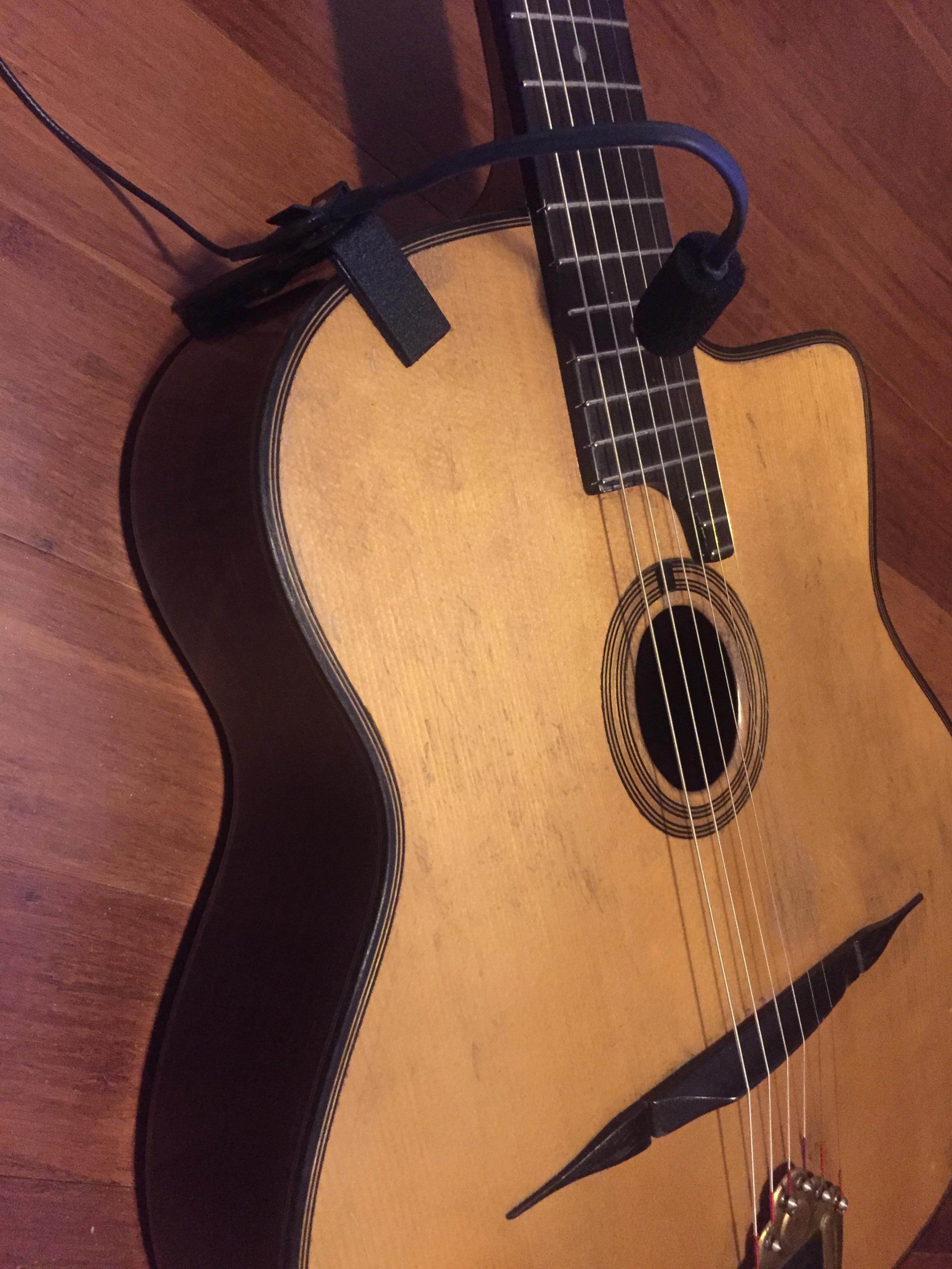

    I’ve got a working setup (see earlier posts and attached pic) but this is much more elegant. Just ant to be sure the sanction cups hold for an entire gig. Is it gig-tested? Ever consider constructing a spring-loaded clamp system like the DPA?
    Nevertheless, I’m ready to be a beta tester. How do I get one?

    Have not gigged on it yet, but will let you know. But as a trial I did leave it attached overnight with the microphone attached hanging in the vertical position, so it passed the gravity test :)
    My initial plan was to do a clamp-style but ultimately it's too bulky, more fragile and difficult to design. Thought I'd try the minimalist approach first. So far, so good.
