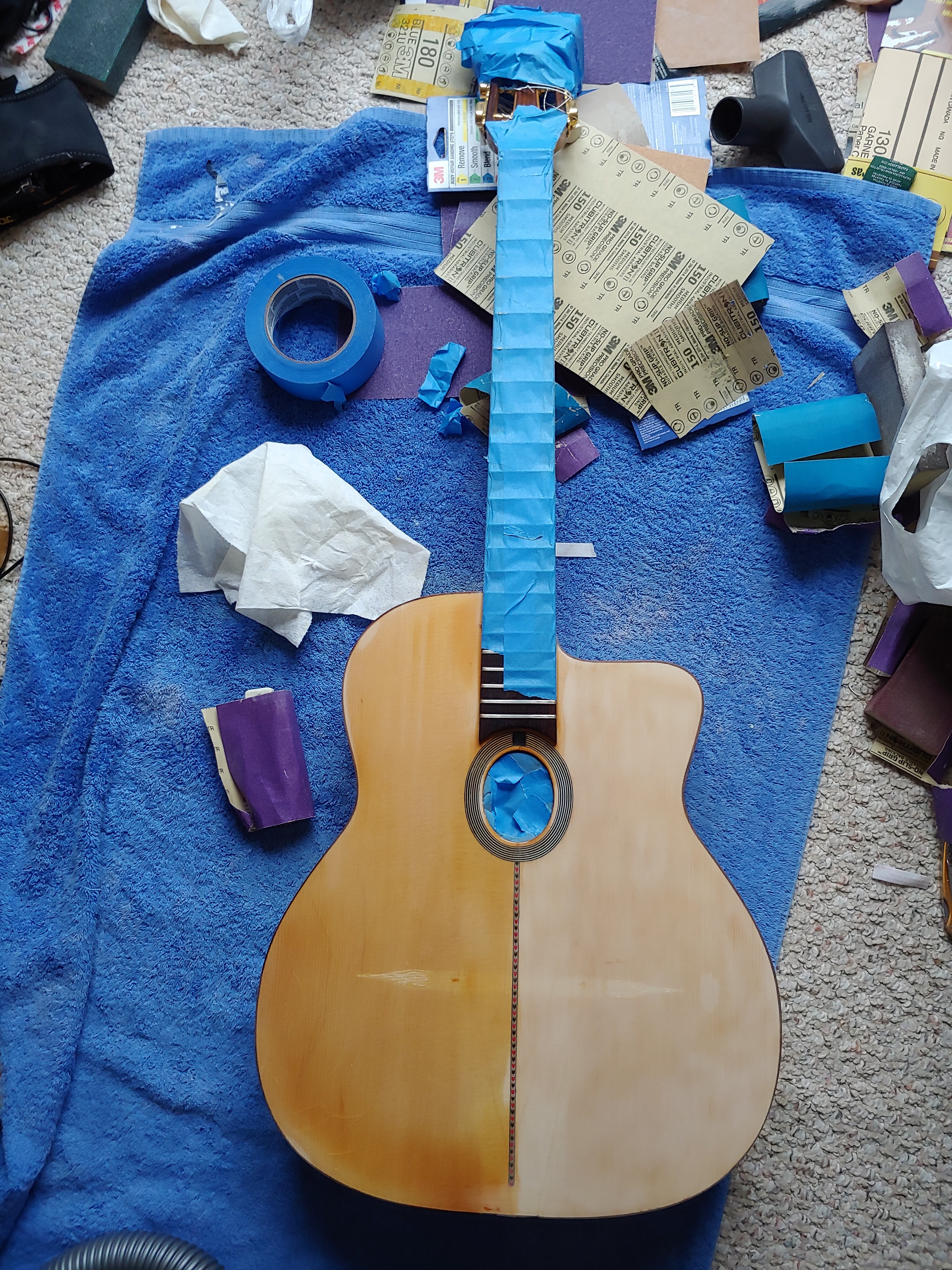

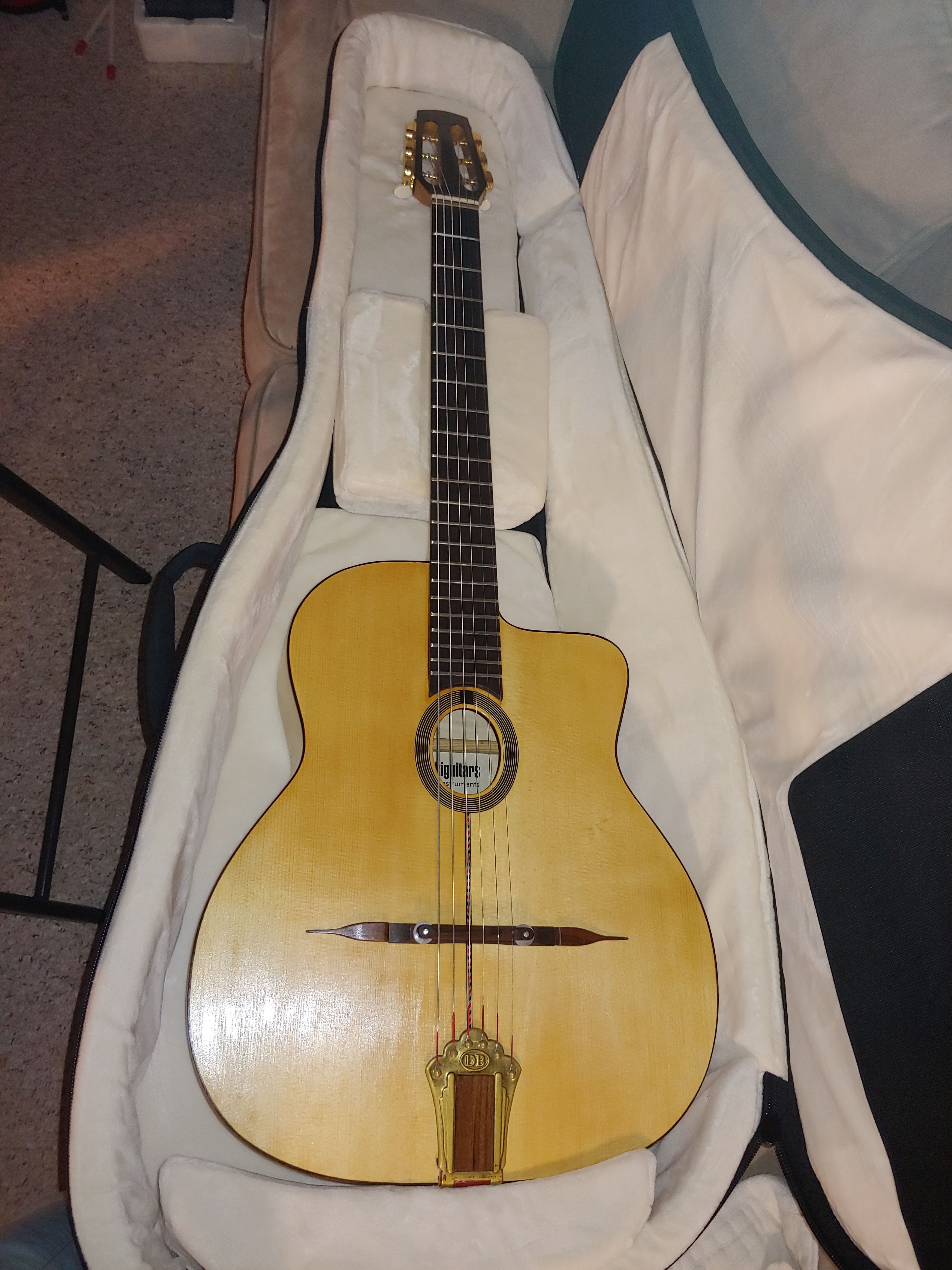

    That's pretty much what I did with my guitar. It went from a dyed red to a natural blonde. So glad I did it too, it's lighter and louder, looks are subjective. I was talking to Craig Bumgurner prior to doing it and he warned me about being careful with removing the stain but not the top wood. I felt like I was never in danger of thinning the top. There was kind of a clear line between the coats of lacquer then stain then wood.
    First one is the new finish and below half and half when the lacquer was already gone on both sides and stain was half way off on the left.

    Buco, if the color was easy to remove without taking off much if any wood I'd say your color was probably in the first coat of lacquer and not actually stain in the wood. Stain soaks into the wood and you have to take off too much wood to get it out and the top would probably end up too thin unless it was overly thick to begin with.
  • Posts: 5,986
    That could be. The top on this guitar was actually pretty thin to begin with and it didn't seem that I was taking wood off. The only place I know I thinned the wood is just below the fretboard extension as I had a hard time getting in there.
