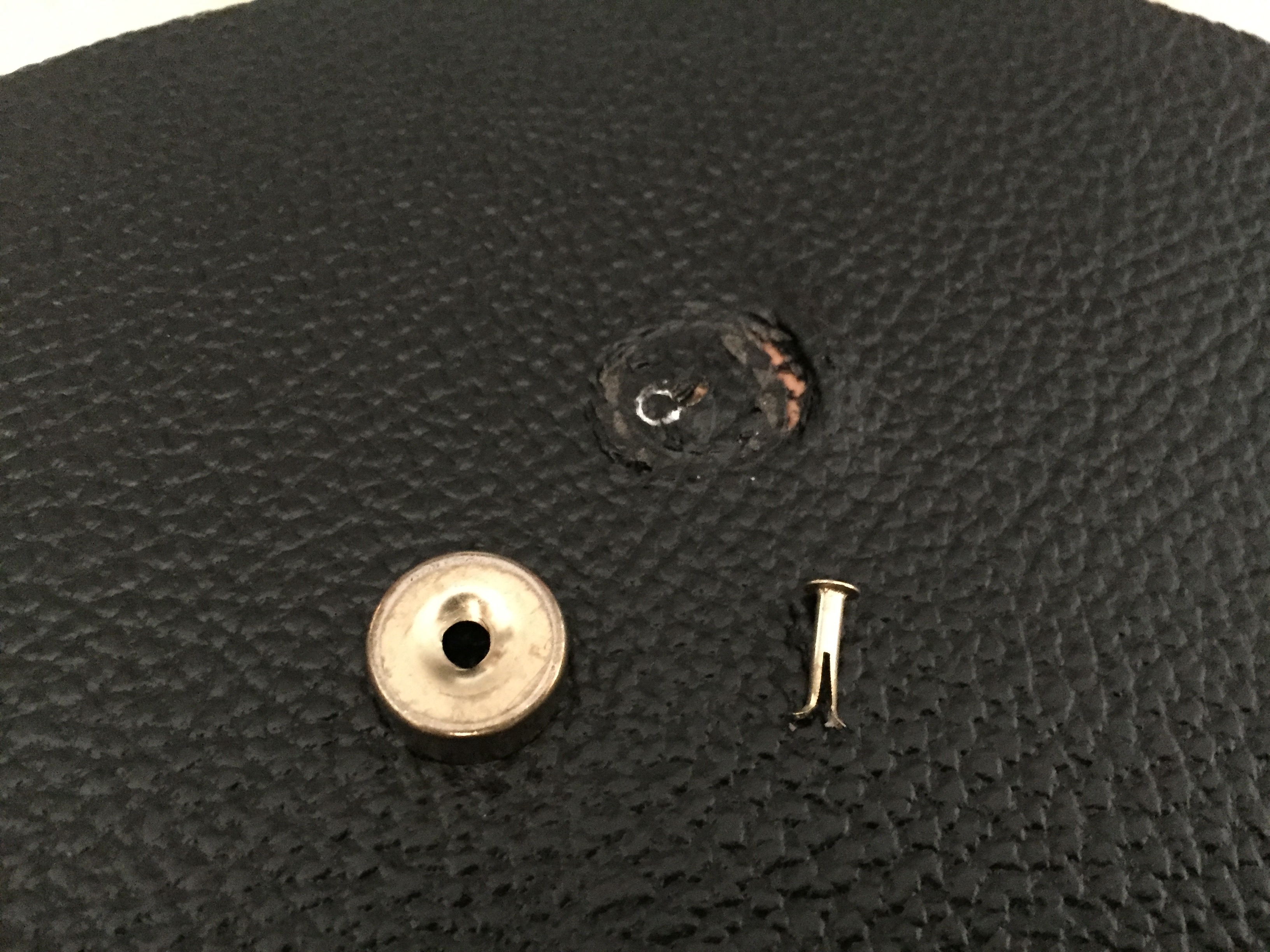

Went downstairs to my basement and found one of the metal case "feet" off of my guitar. No idea how it happened while it was just lying on its side so can only guess that it had been loosened from somewhere previously and just fell off down there.
Anyway, for you builders and tinkerers, any advice on how to repair something like this? The two prongs of the "rivet" thing are still there. Is it salvageable or does it need new hardware? Does this require pulling out the lining of the case to get at it? It is a Superior case that came with my Altamira. Tried looking on the interwebs but didn't find any videos that were showing something similar.
Thanks for the help!

    Here are the same photos from previous but in the body of the message not needing to be downloaded.

    Thanks Andrew. Yes that looks like it would work. Of course I'd need to be careful that the attachment screw just barely pokes thru the plywood on the case. It looks like the little metal ones on my cases are not screwed on but rather have some sort of barbs that hold them onto the case.

    I'm guessing the barbs you are talking about are similar to what mine has in the picture. It isn't a rivet but some sort of unique hardware I have little experience. That's why I was hoping someone else might have. Hesitant to use a screw as they back out and for similar reasons as your concern (namely, don't want them to poke through). I like the idea of rubber though. My guess is the metal is designed to help the cases slide against a metal truck bed, etc where rubber would grab and not cooperate. For those of us that keep them in our houses with wood floors and don't routinely toss them around a la "United Breaks Guitars", rubber would be a good option.
