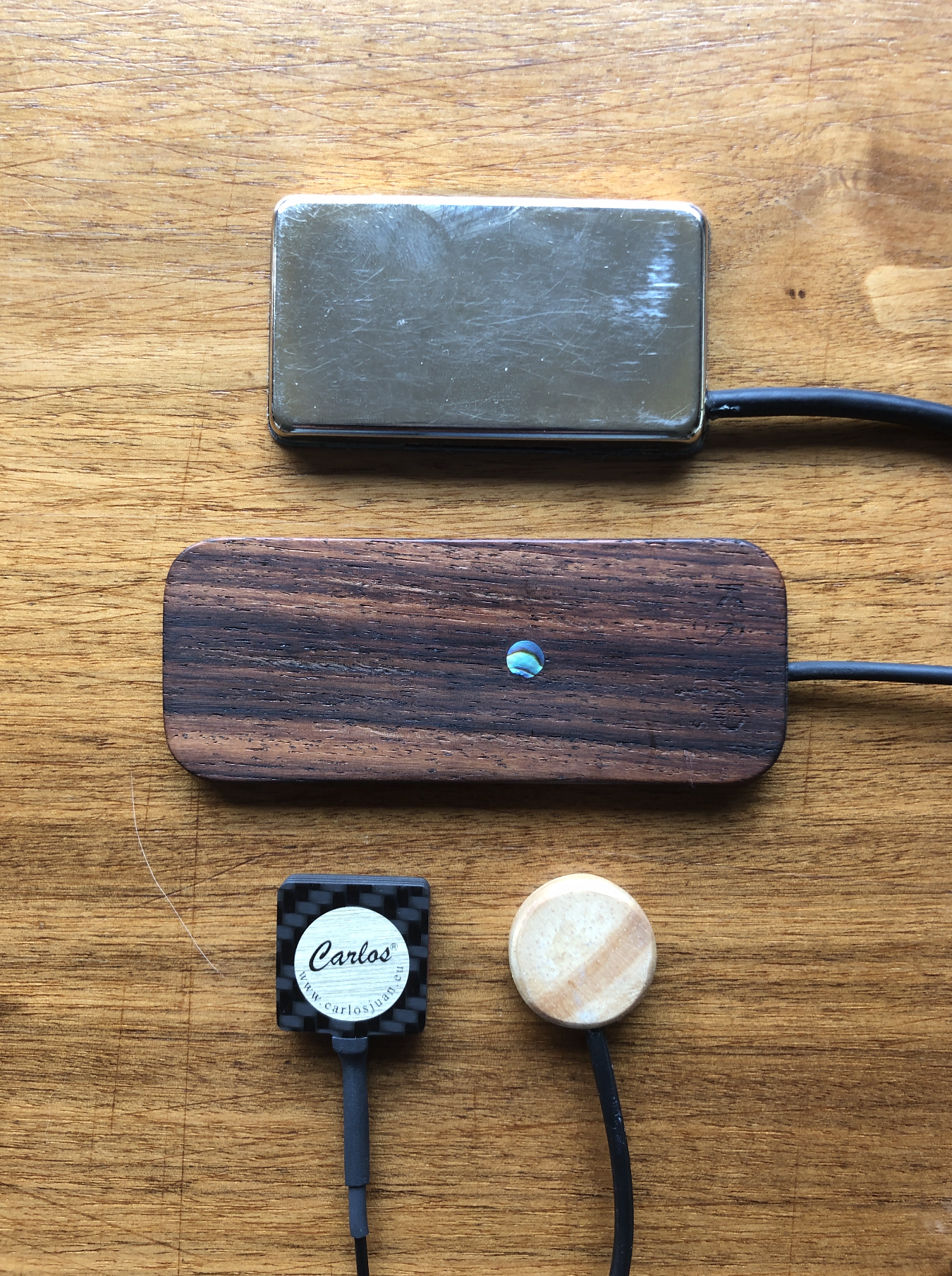

Hi All- I was wandering if anyone had experience on these two pickup systems and how they compare to the K&K Definity or Pure Macaferri. I’m looking for something with a more acoustic sound which doesn’t generate too much feedback in a tight setup. I currently have multiple systems, but always end up reverting to my Krivo Nuevo which is magnetic sounding. Thanks, Jim

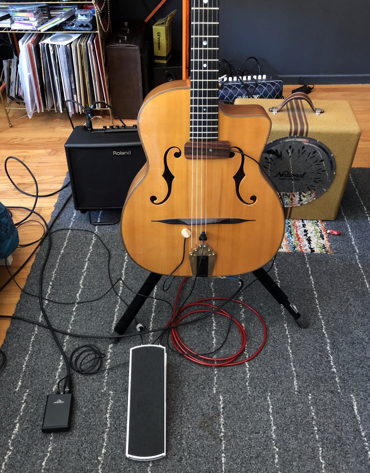

    here's my ideal setup: a single coil through a tube amp for lead playing, and a mic + piezo through an acoustic amp to blend the sources for rhythm...
    jk — just testing these all against eachother!

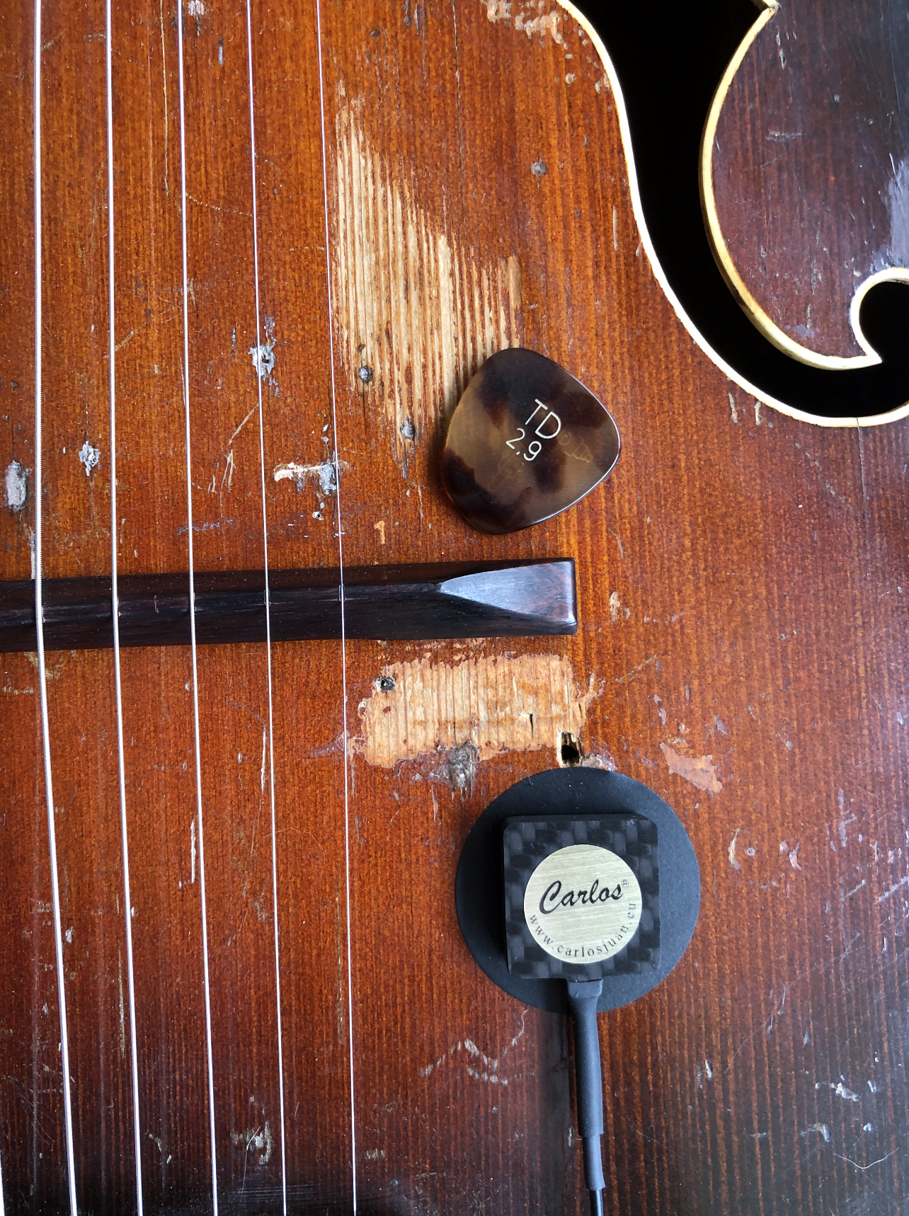

    I have both the carlos and jokko's pickup. I like the carlos sensor better, but mainly because of the way it gets mounted. there is a low-tack sticker that you apply first, to protect the finish. on the back of the pickup, you use stronger double sided tape. because it's square, you get pretty good contact with the guitar top, and the tape holds it evenly in place without worrying about damaging the finish. for the manouchepicks mic, you just use putty, which i don't feel transfers the sound as evenly. i suppose you can mount the manouchepicks mic in the same way (which I might try), but out of the box they both take a lot of fussing with to find the sweet spot.
    I played an outdoor gig recently with the carlos cs through an AER compact 60 on my DiMauro, and I thought it worked well. I have another guitar with an internally mounted schertly dyn pickup, and while it sound decent acoustically, it is a tad bass-y and "wet" as michael mentions.
    overall, I'm happy with the carlos cs...but each guitar is different, and each venue changes. i find that i never use the same solution twice in a row (even in the same venue), as i'm always experimenting, switching things up, playing with different tones, etc.

    Everett - what do you use to switch between your magnetic pick up / tube amp and the mic and piezo / acoustic amp? I was thinking of using a similar set up.
    Bucocass
    Posts: 163
    @TDog I usually just use one or the other. I've tried really random things: using an a/b box, muting it with a tuning pedal, using volume pedal to bring it in, etc. it's all a bit much...i feel like i'm in a shoegaze band.
    I like the peche/stimer style that has the volume pot on the pickup. But I play 75% rhythm and 25% lead, so I just stick with the more "acoustic" pickup.
