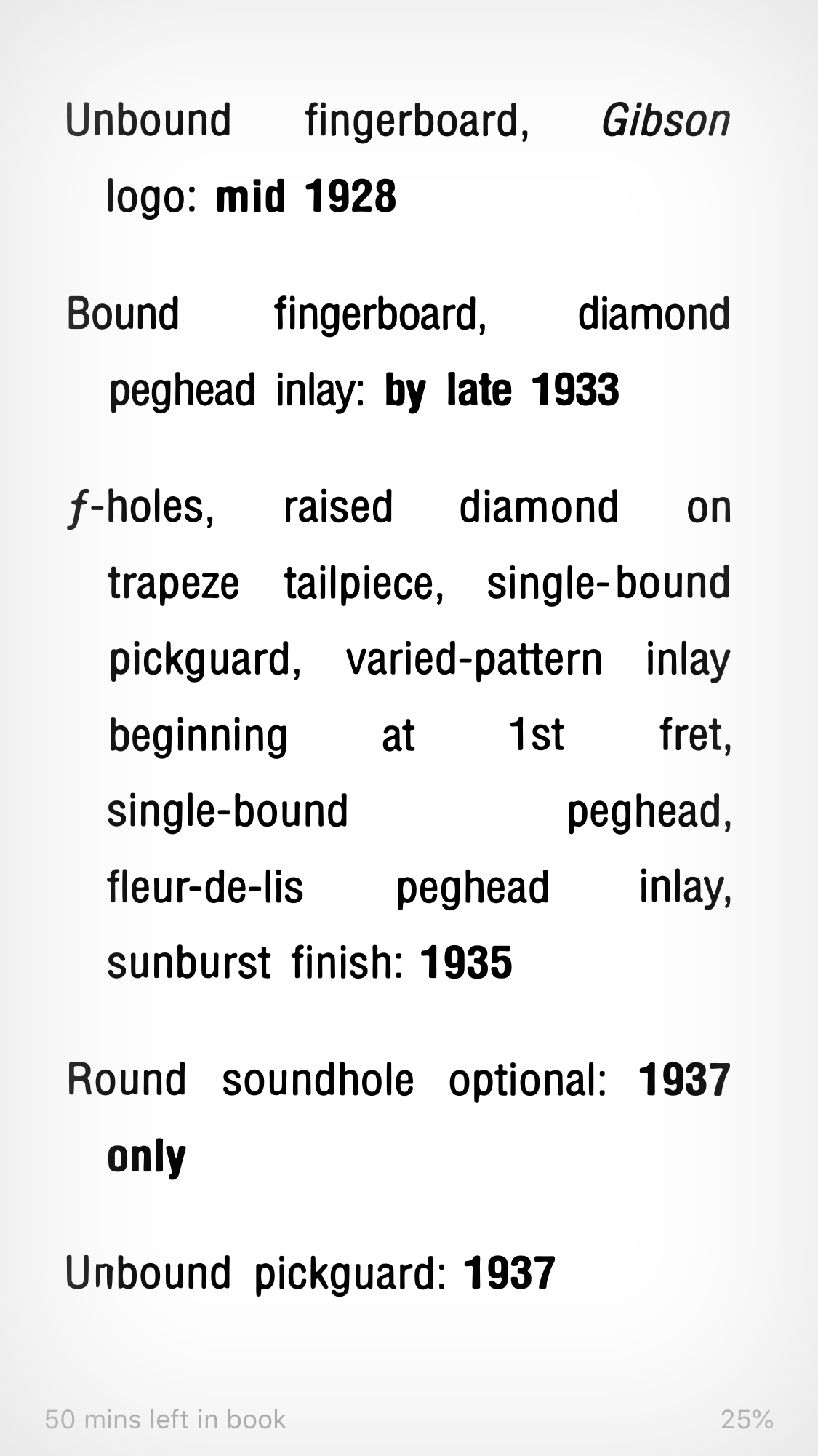

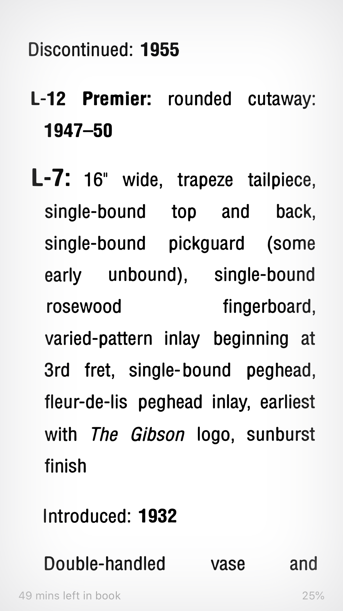

    I still can’t properly distinguish the “f” hole ‘34 (early ‘34 with 16” lower bout) L-4 and the same year L-7. Between the Gruhn book, the Gibson catalog and the internal label, it’s confusing. The “Nick Lucas” position markers, and the headstock design seem to be the biggest clues.
    My Label says “L-4”, but it appears to have the Gruhn and Nick Lucas marks of an L-7.
    Any guidance?

    The label says “L-4” and it is a rosewood fingerboard, but both the catalog and Gruhn’s book don’t state that the Lucas inlays were on the L-4.
    maybe I should talk to George Gruhn himself, or take a trip to Nashville.

    I could be wrong but my understanding is that it is a matter of year. The 16 inch guitar you describe was the L-7 until 1935 when the 17 inch guitars were introduced, including the 17 inch L-7. Rather than abandon the 16 inch f-hole L-7, that guitar was renamed as the L-4 in 1935. There were a few detail variations made as Gibson often did. For example, I had a ‘35 L-4 with an ebony fingerboard although the catalogs said they were rosewood. Nice guitars!
