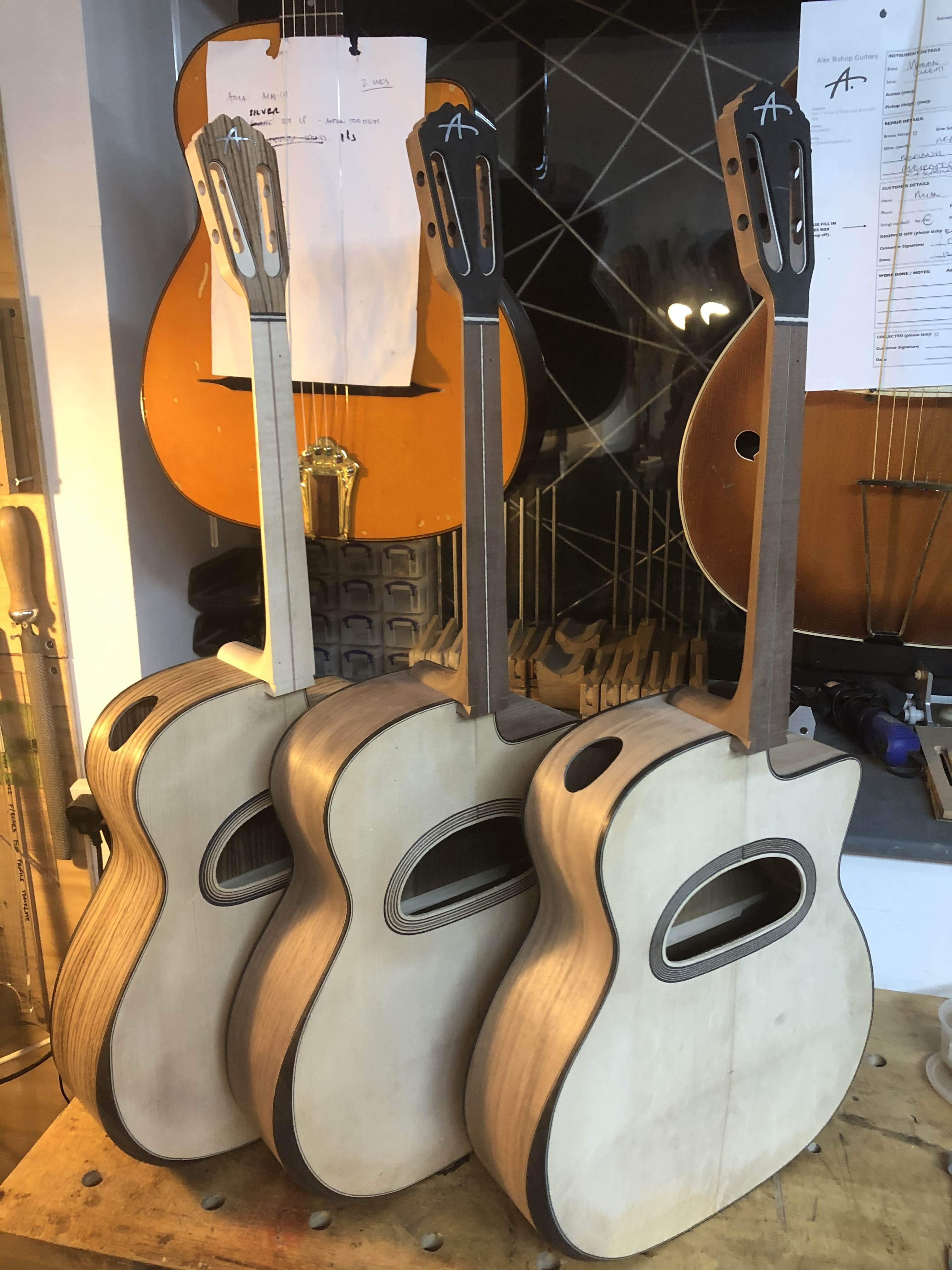

I'm currently building three gypsy jazz style tenor guitars at the moment, all are D-holes, 584mm scale length tuned CGDA (non-reentrant tuning).
Does anyone here play much tenor guitar in this style? What tunings do you use, and more importantly what strings do you use??
I'm hoping they will work well with strings found in the usual gypsy jazz sets (savarez argentines, D'addario gypsy strings etc), but would love to hear some first hand experiences.
Thanks,
Alex

    Interesting project! Do they have the same body as 6-string, looks like it?
    There were actually a bunch of selmers built like this too, but history wasn't so kind to them. Tenor guitars fell so much out of fashion that many of those old selmers have had their necks torn off and replaced with 6-string necks (kind of a shame if you ask me...)

    @Wim Glenn Yes the body size is similar but not the same, about an inch narrower at the waist, but not too far off. It's based on the original selmer tenor, but not the Eddie Freeman one - which I think was the same as a six string full size body. Not sure how they made that work with the thinner neck though.
    Posts: 1,729
    @alexbishopguitars Thanks for sharing your works in progress. Are you just building these on spec or do you have buyers? I ask not as a buyer (Only tenor guitar I've seen was played by Sims from Harmonious Wail), but it is interesting to see you have a few different wood choices going on here both for the neck and for the back (and presumably sides) as well as soundport options. It also appears that you have built in the bevel on the lower bout for all the instruments. I have seen that on some of your other models. Is that something you are planning to do for all your instruments now? Does it affect either the tone or the stability of the guitar or are there any specific bracing/support techniques required when building that in? Is it much more difficult to execute? Thanks!
