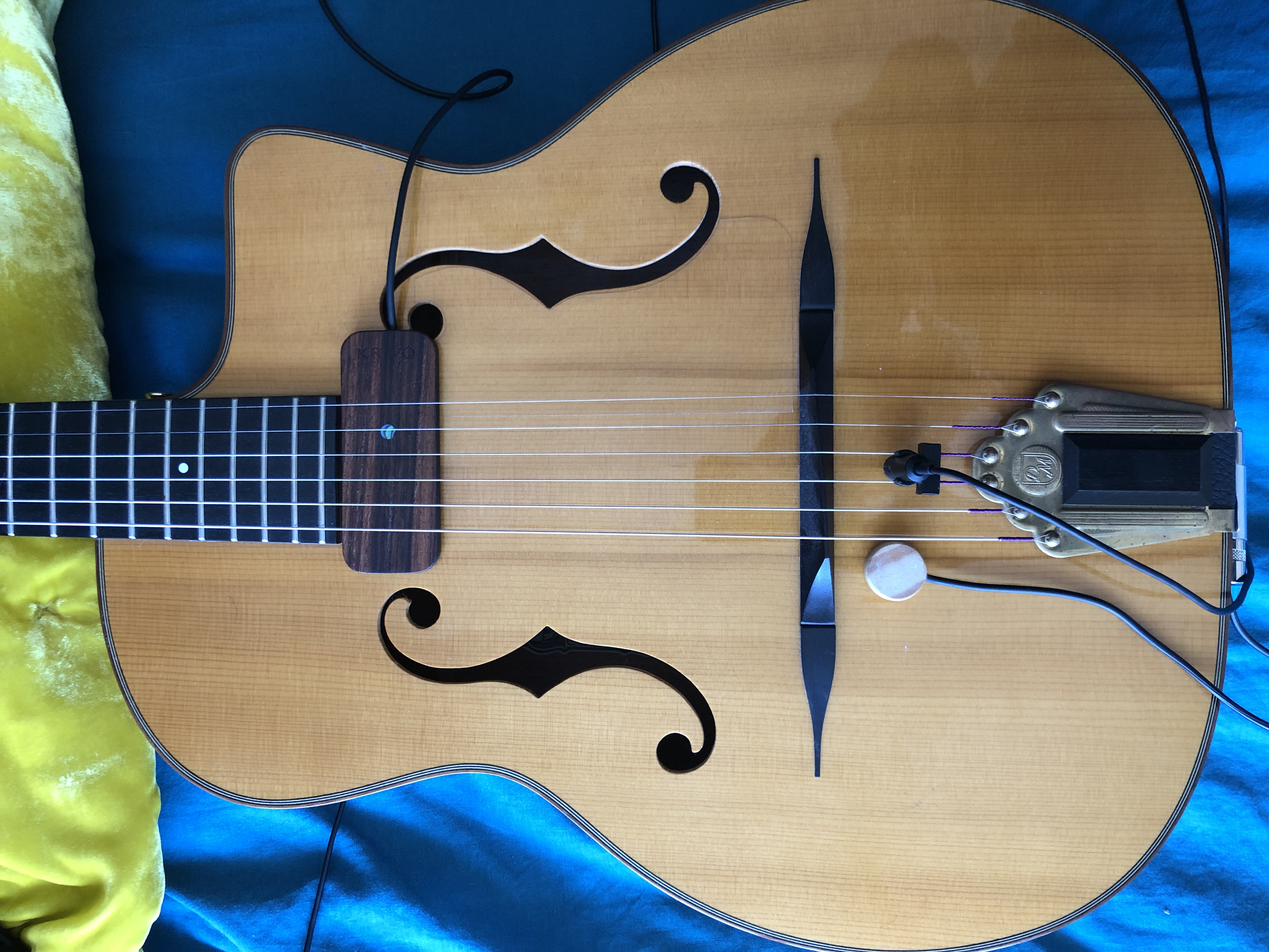

    some ridiculous combinations going on here...for testing only!

    This is another similar guitar made for me in the Di Mauro 'Chorus' style by Tony Petrarca a few years ago and the Krivo is the only pickup I found that fits. I usually play it 'unplugged' anyway but I like to experiment with various pickups sometimes to look for a variety of tones (usually just through a Pignose portable amp).
    Many people claim the Shadow AZ48 is the best jazz style end-of-fingerboard floating pickup and certainly it is my #1 for a couple of archtops but it is a tight fit on this guitar. It measures 11.3mm thick but because I did not want to drill holes in the fingerboard sides I tried it using the putty that came with the Krivo and it is just a little too close to the strings. Depending on neck angle and bridge height if you have even just 1mm more height than I do it would fit and that is what I would recommend.

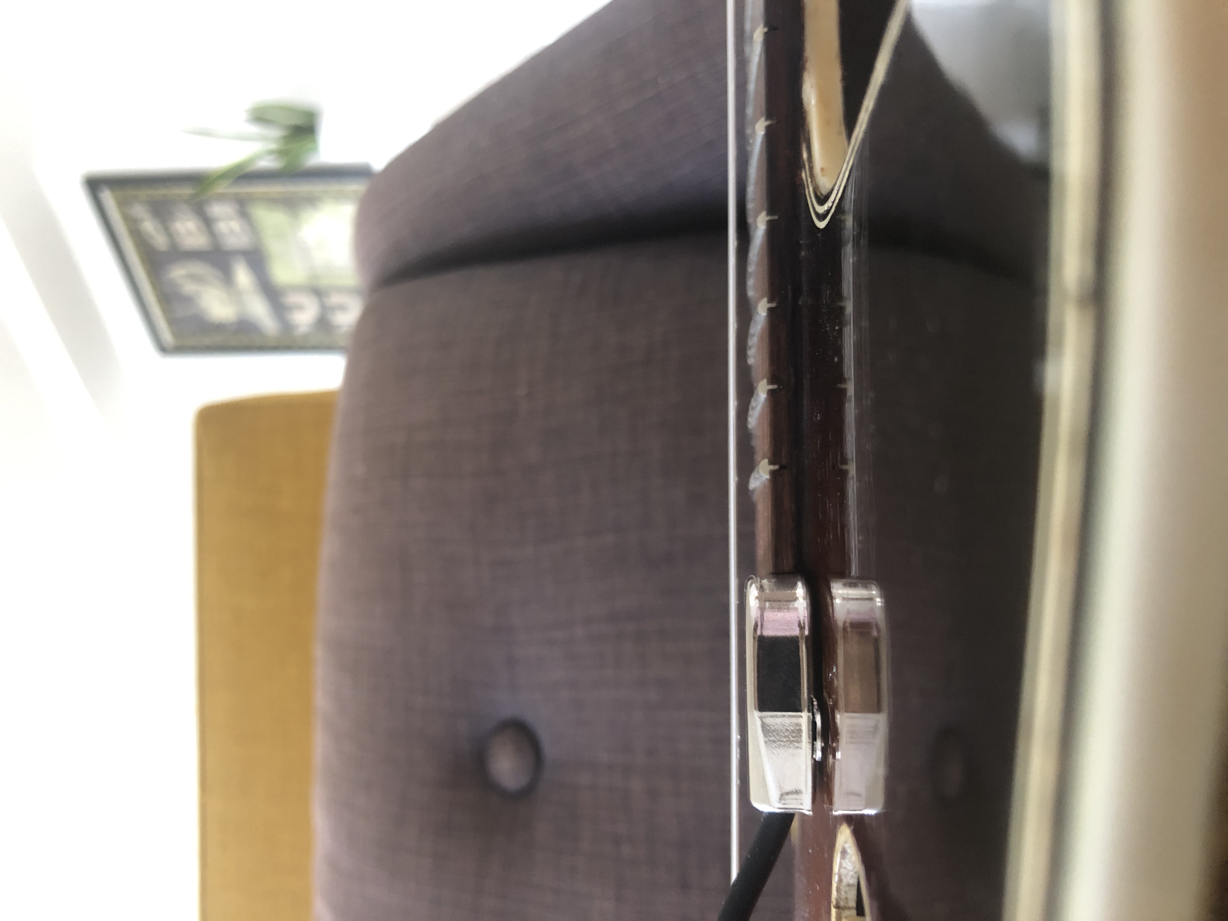

    For reference:
    first set of pics: Miller Fleche d'or
    second: reissue Dearmond
    third: Krivo nuevo
    Krivo is the thinnest by maybe 1.5mm. Then the Miller. Dearmond has barely any string clearance. The Krivo is pretty convenient, and it somewhat blends in with the sunburst top. It's also the lightest, so it doesn't deaden the top and it has some microphonic characteristics to it. The Miller is the best sounding if you want that single coil through a tube amp early jazz sound. It also has a mini volume control which is great, and it looks killer.
