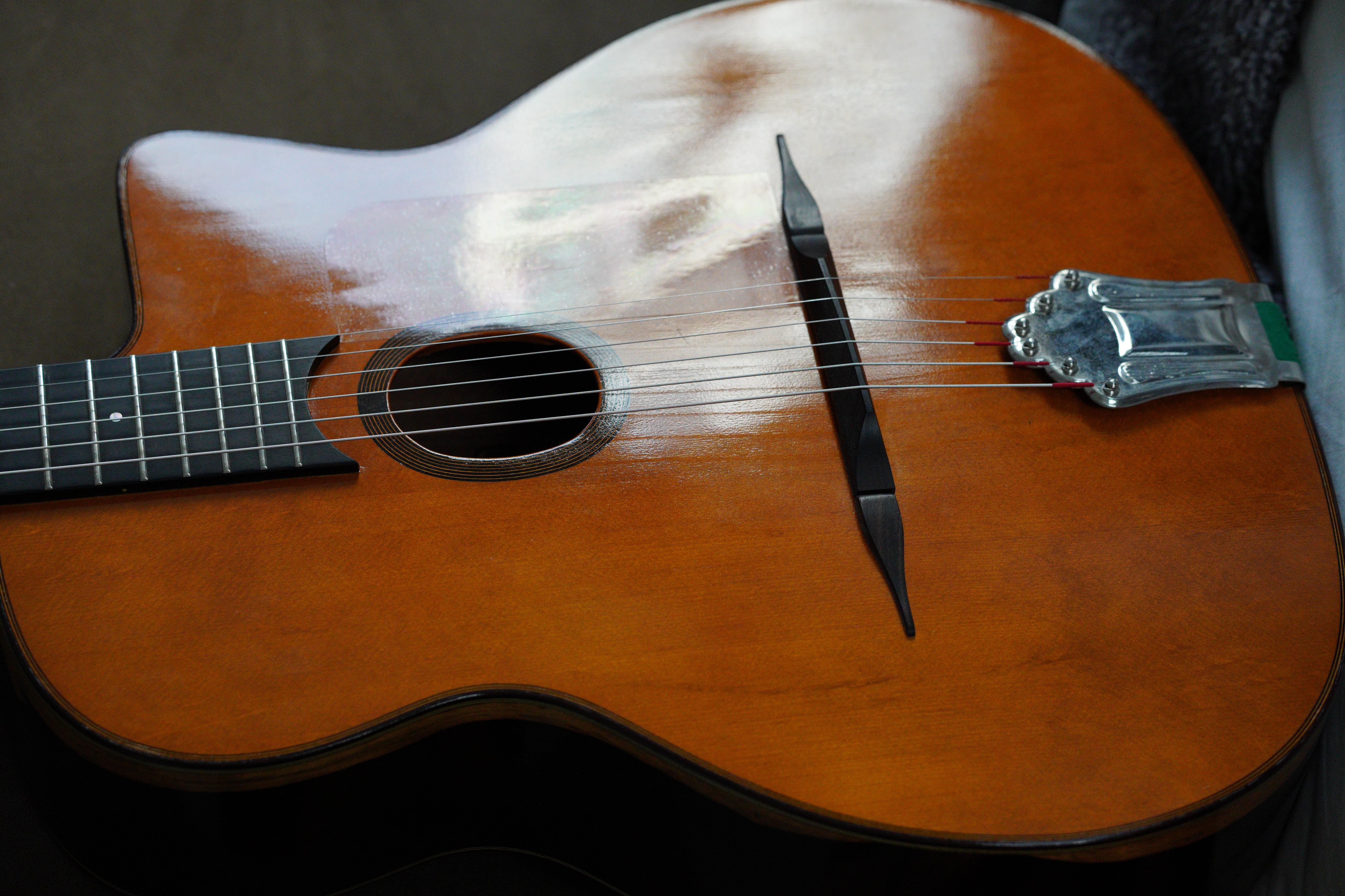

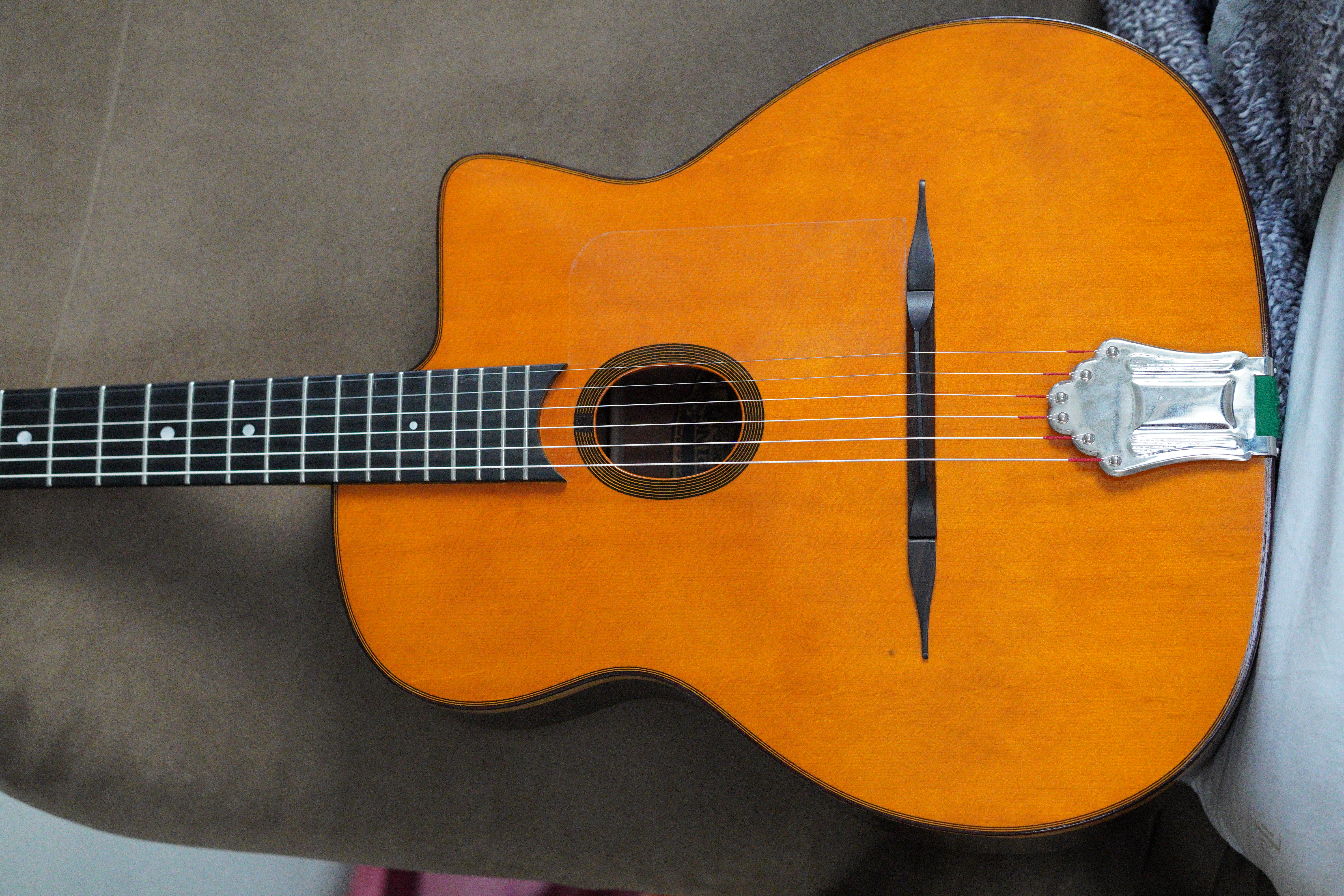

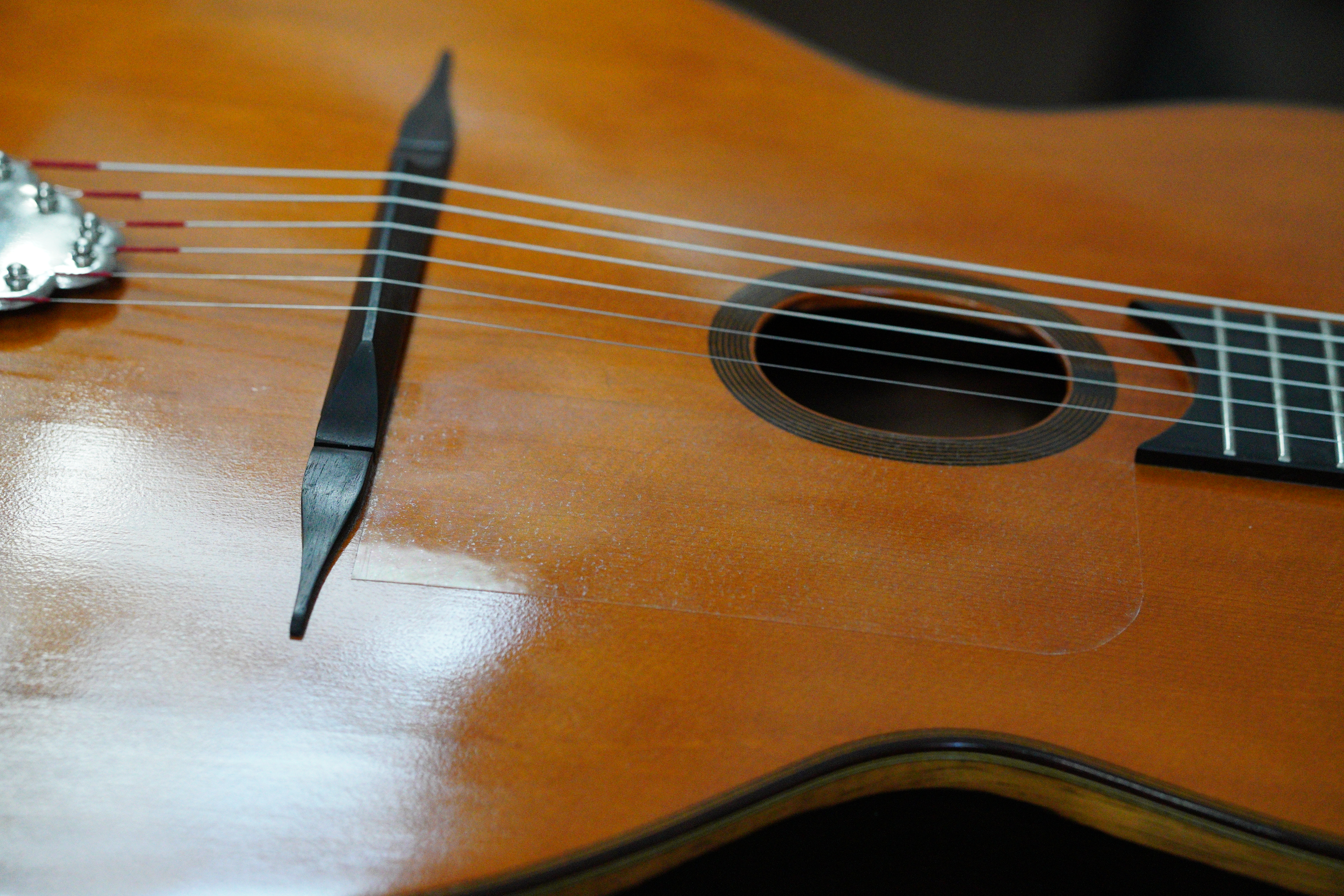

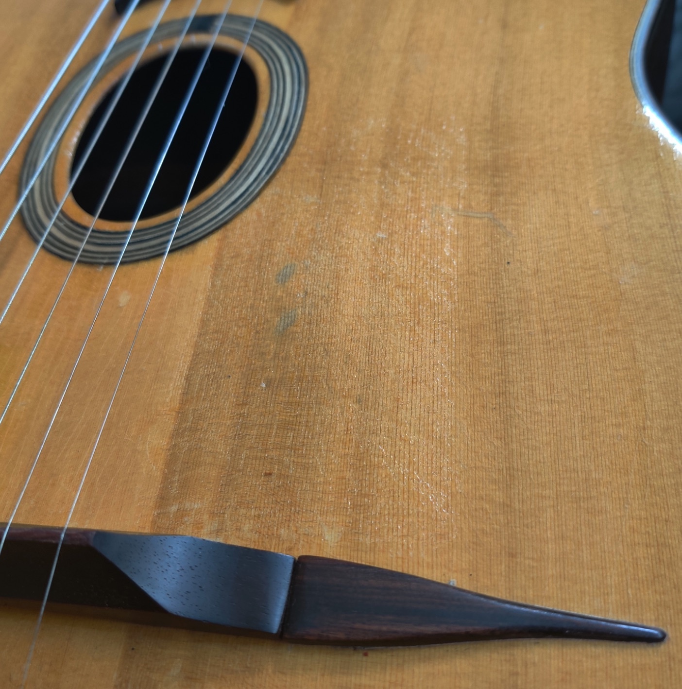

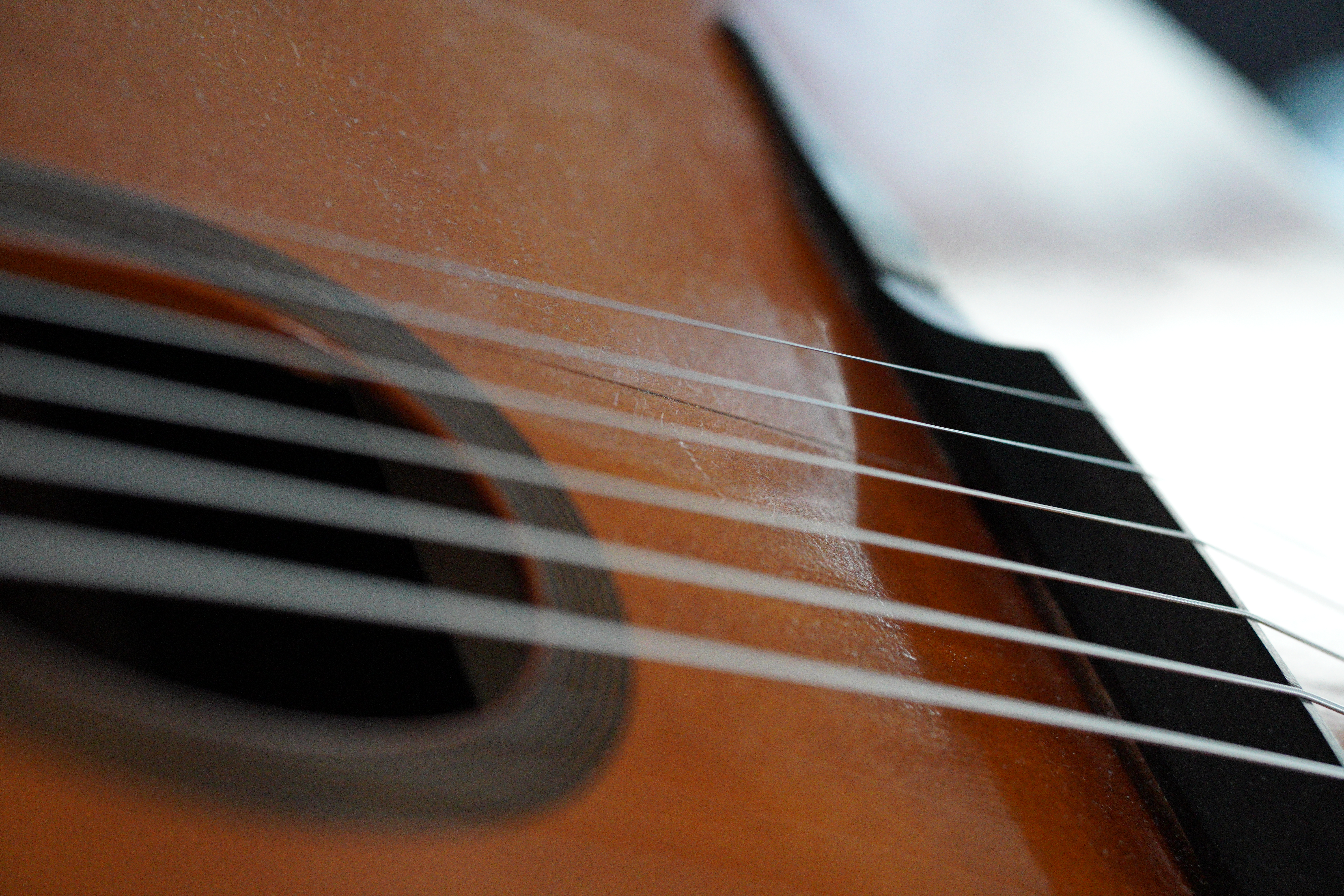

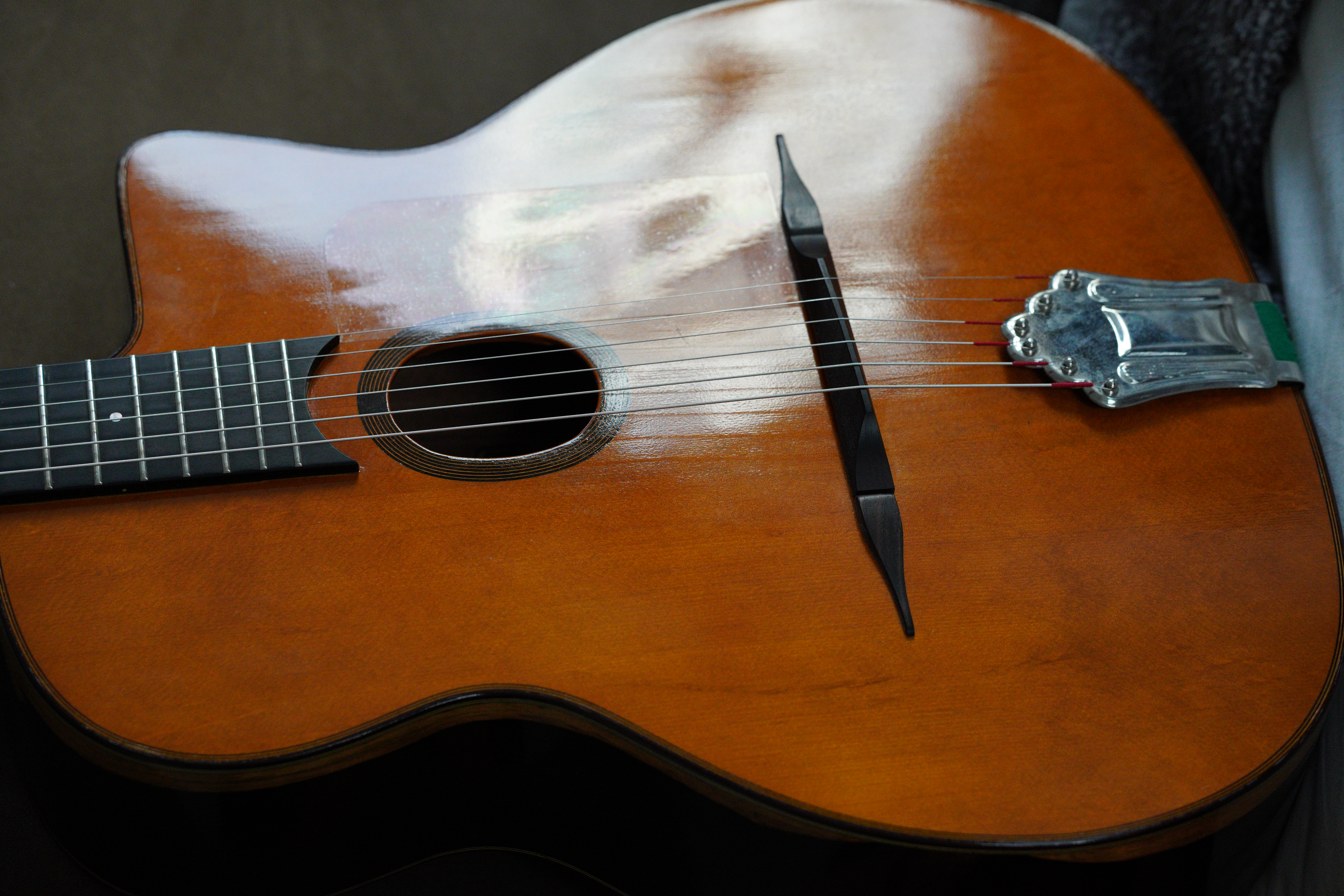

    Appreciate the suggestions for the cell phone covers (I have done this a lot in the past, actually) but the finish is so roughed up in that region that putting a clear guard over it wont stick and will look bad with lots of air pockets.
    Plus the finish seems so fragile that removable sticky things actually seem to pull up finish! In fact, that's part of how it got so messed up. I was trying to remove an adhesive clear guard. Not sure why. It's perhaps the most brittle finish I've ever encountered. Not sure if this was due to how the guitar was stored or treated by the previous owner. Pictures attached, maybe you can tell me why.
    The guitar is a 2012 Lebreton, so it really should not be old enough to be cracking the way it is. But maybe it's a specific kind of polish that is susceptible to that
    I suppose it's really just a cosmetic issue and the guitar still sounds wonderful. Might actually look pretty cool with some scars. But this stuff can get under your skin, as you know.

    Posts: 1,636
    Wow Vic if that's your idea of a "very gnarly issue", then you would really hate my guitar! :D
    This Lebreton looks (and sounds) lovely, an ugly wooden pick guard would be a disservice. Just my 0.00000038 BTC ...

    @V-dub Sounds really good and not just the guitar. And I agree with Wim Glenn about his guitar. My is 3years old and look's like from Django all ready. :D But my very thin semi gloss lacquer helps to look not that bad..actually I like it. High gloss is less forgivable sometimes, but I still like the look of your guitar from the picture and video!
  • Posts: 5,755
    I'd try to a little refinishing just there, light sanding and touch up. I'm not buying into the "scars" talk either so it would bother me too.
