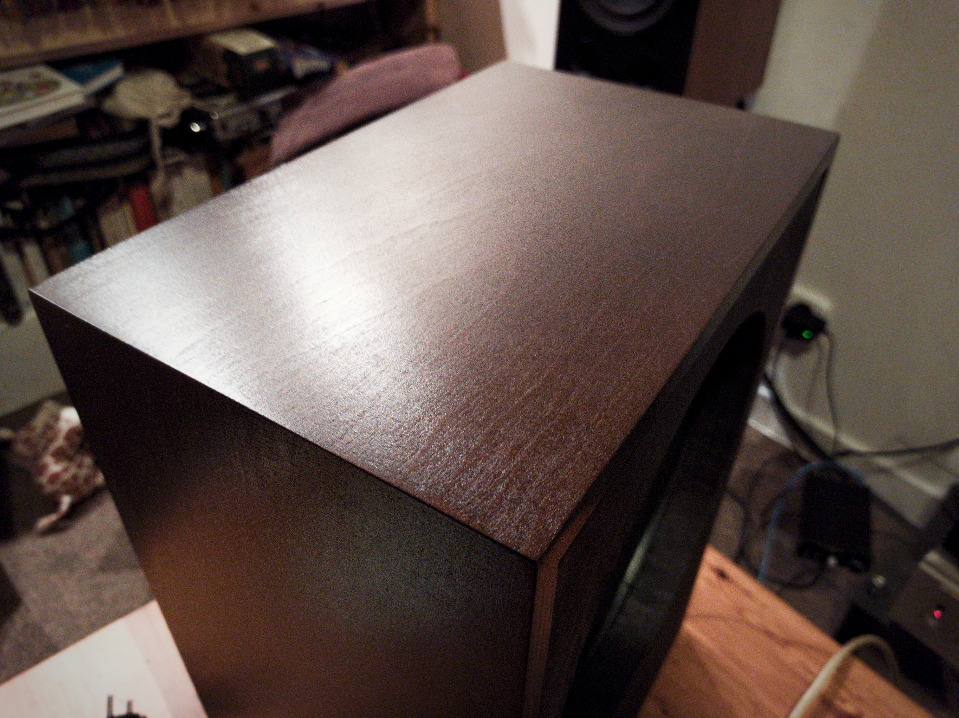

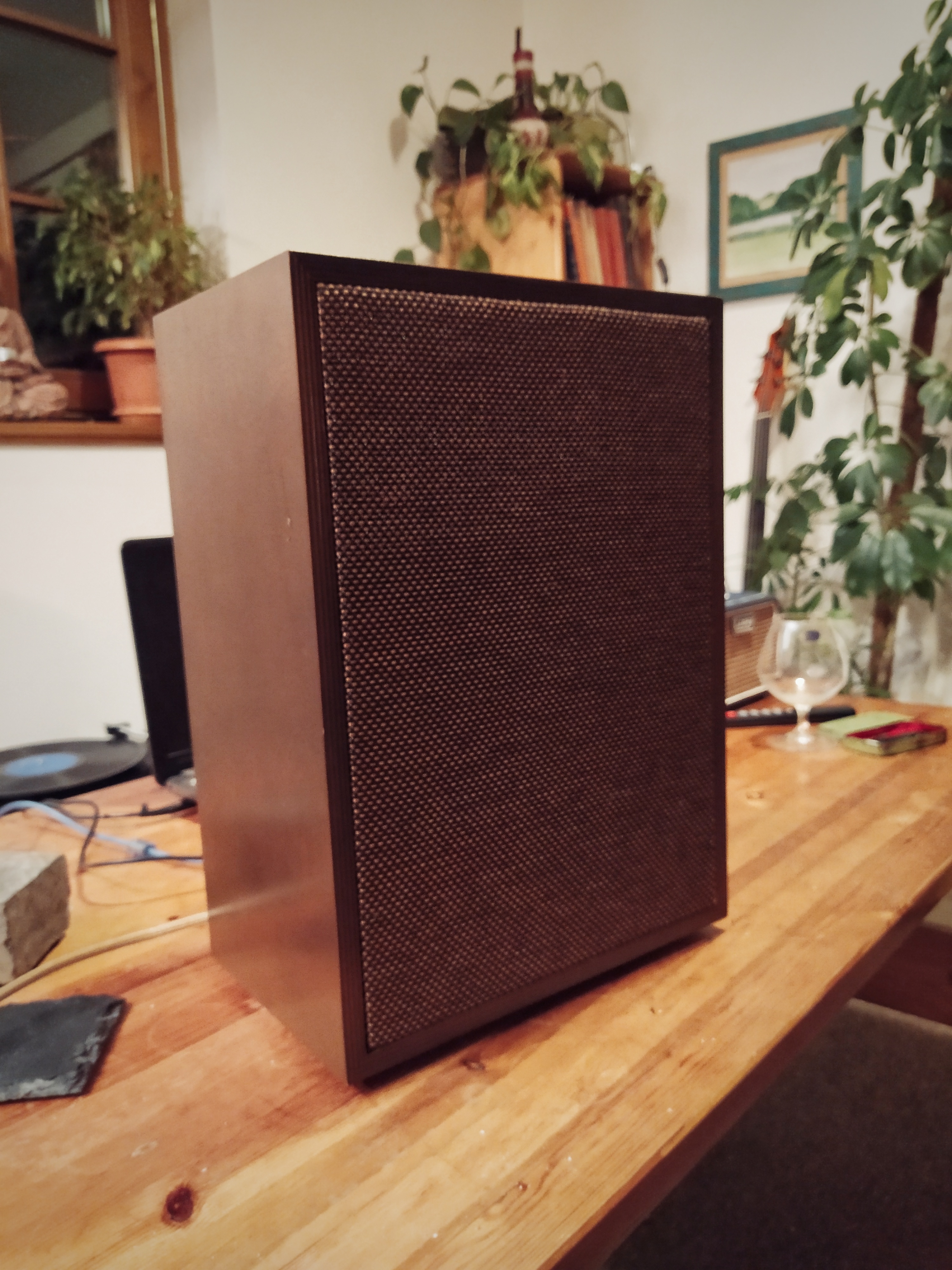

    Thanks you all for help me understand this. It was exactly what I wanted. I don't need too much power for my events. 5w seems to be ideal. I finally tried first go with my new amp! It's just unfinished beta version without lots of details. Just wanted to know how the sound sounds like. And results? Way much more power than I expected abd better. I'm not sure if overdrive is that bad for me. I like dirty old sound and it's sound like this. Just two issues. Sound seems to be mabye too dark for my liking. Probably because of choosen speaker? They said neodymium without metal highs. But little bit more open sound would be nice. But I tried it inside of small room with lot's of textiles around. So acoustic wasn't ideal. Today I will try it outside. Or can speaker cable make a difference or mabye I tried it too low volume or china tubes? But don't get me wrong. The sound is much better than I expected. And second issue is that power tube rumble...make sound by vibrations. When I hold it it's stopped. So maybe some spring holder or bad tube?
    @Lango-Django It's look amazing man and interesting story! Many thanks for your offer. But I still have this textile grill in my head. Amp looks like my old hifi speakers I had in my childhood. So little bit nostalgia too.
    And some photos of my unfinished beta version amp:
    rudolfochristBucoBillDaCostaWilliams

    @Lango-Django The labyrinthe looks awesome. But it makes sense just with a cube i think. And my looks exactly like previous photos...because it is it. :D I posted the site just because it's look so nice and it's inspirating. I'm really satisfied with the look of mine. It could be much worse. :D Now I have to do just a few small details. Like cover to knobs, holder, few screws and so on...
