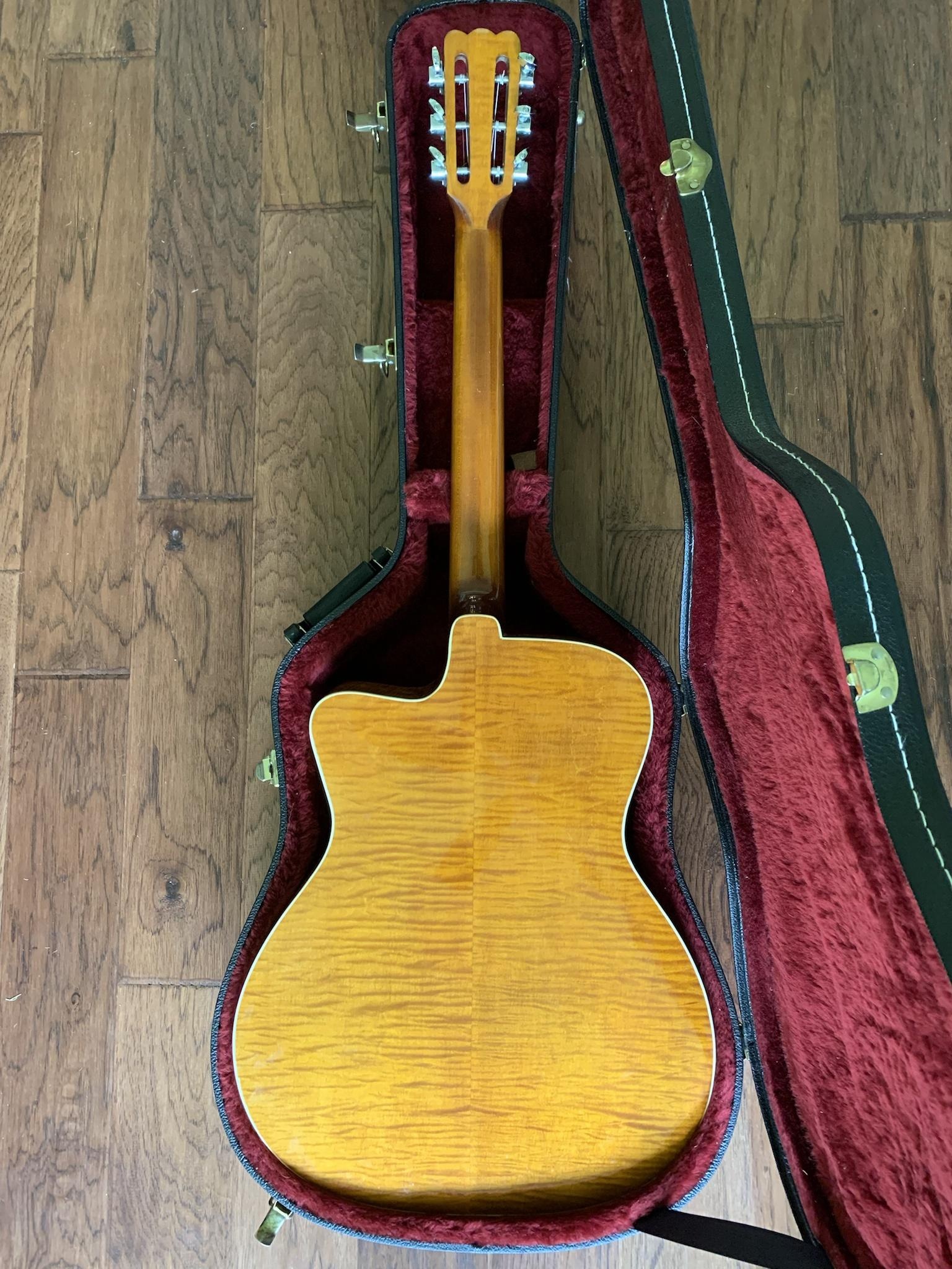

    The Patenotte has returned! I sent it off to be fixed up by @Craig Bumgarner, who brought it back to life with new frets (Jescar EVO 47104), new bridge and his own custom tailpiece. I had considered going with a Selmer style, but I wanted a visual reminder of Craig's involvement. Plus, I love the design and thought it was fitting for this particular guitar, as I see the cutouts as wings--a subtle reference to the butterfly inlay. Craig worked some magic and I'm so glad everything came together well. Everything feels and sounds just right. Thank you again, Craig!
    This one is hard to stop playing! The feeling I have playing it matches my expectations and memory from way back, which is a welcome relief. It's so nice to have a short scale (645mm) 14 fret cutaway in this style!

    Is it in good of a shape as it looks on pictures? Even if I zoom in everything looks mint. Like a few years old, almost never played guitar.
  • McQMcQ Fayetteville, ARNew
    Posts: 75
    When I got it it was almost unplayable, the frets were extremely low and flat--no crown. The bridge was really dodgy. And the fretboard itself was not in great shape. Rough inlay edges, one of the inlays had come unglued. So all that was fixed by Craig. There are some minor blemishes in the finish here and there, but now it really is in excellent condition!

    Nice. I always liked Patenottes, much under-rated, for some reason the (not Sicilian?) name never registers on the guitar snob's likes list.
    I did not see any 'before' photos but the condition there, the flame maple back and sides and the fab' inlays all add up to a real gem!
    The tailpiece I would suggest is influenced by a design often seen on Di Mauros but yes. it suits this guitar too.
