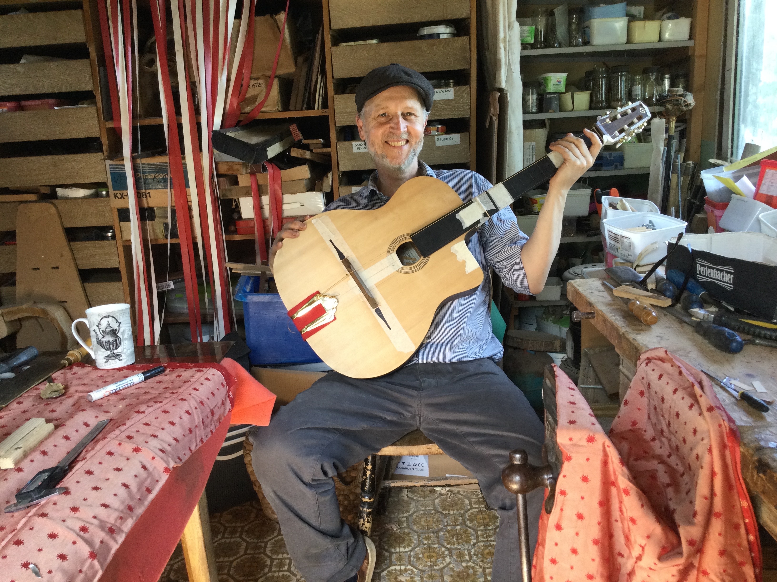

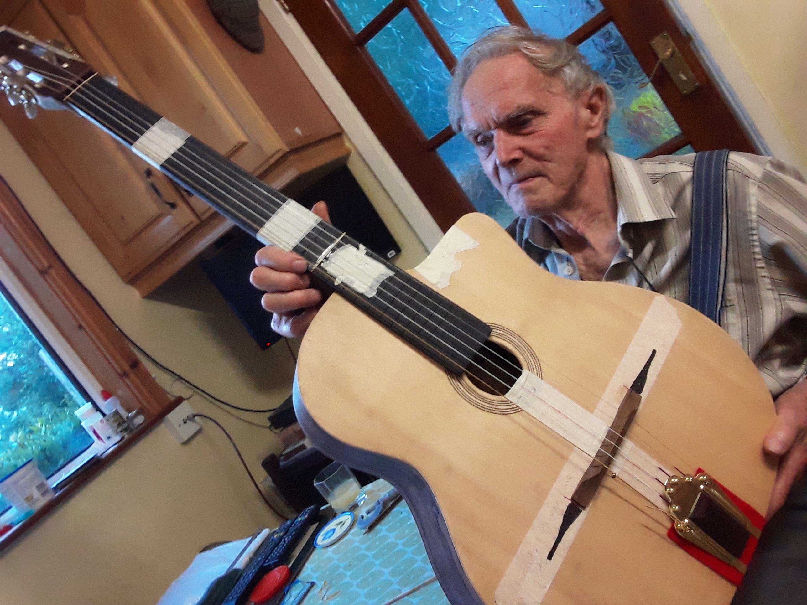

    IDK how everyone does it but I glue the fingerboard to the neck. Then fret the neck but not the part of the fingerboard that extends over the body. Then I "dry fit" the neck and taper shim (wedge) to the body (shim the dovetail joint if necessary). Make sure the dovetail just tightens perfectly as you get the fingerboard/taper shim to mate flush up against the sound board. Next I glue on the taper shim to the bottom of the fingerboard extension once I know I have the dovetail perfect. Next I glue up the neck to the body and let that cure up at least a couple days before I carefully fret the part over the body.

    The tape is for 1. keeping us aligned to the 'centre' line through the body (without having to pencil the wood). 2. holding the fingerboard on the neck temporarily 'cos spots of hide glue take too long to grab when you want to put it on and take it off numerous times.. and 3. when we were trying to set the neck angle we were using the bridge height, a straight edge and an extension from the fingerboard with a small block of wood on the end of it equivalent to the height of the 'frets + action' to rest on the bridge, it was going to be helpful if the bridge didn't keep falling off so I 'hide-glued' it onto the masking tape! (the lower edge of that strip of masking tape was also making the pliage line more visible at a glance).
