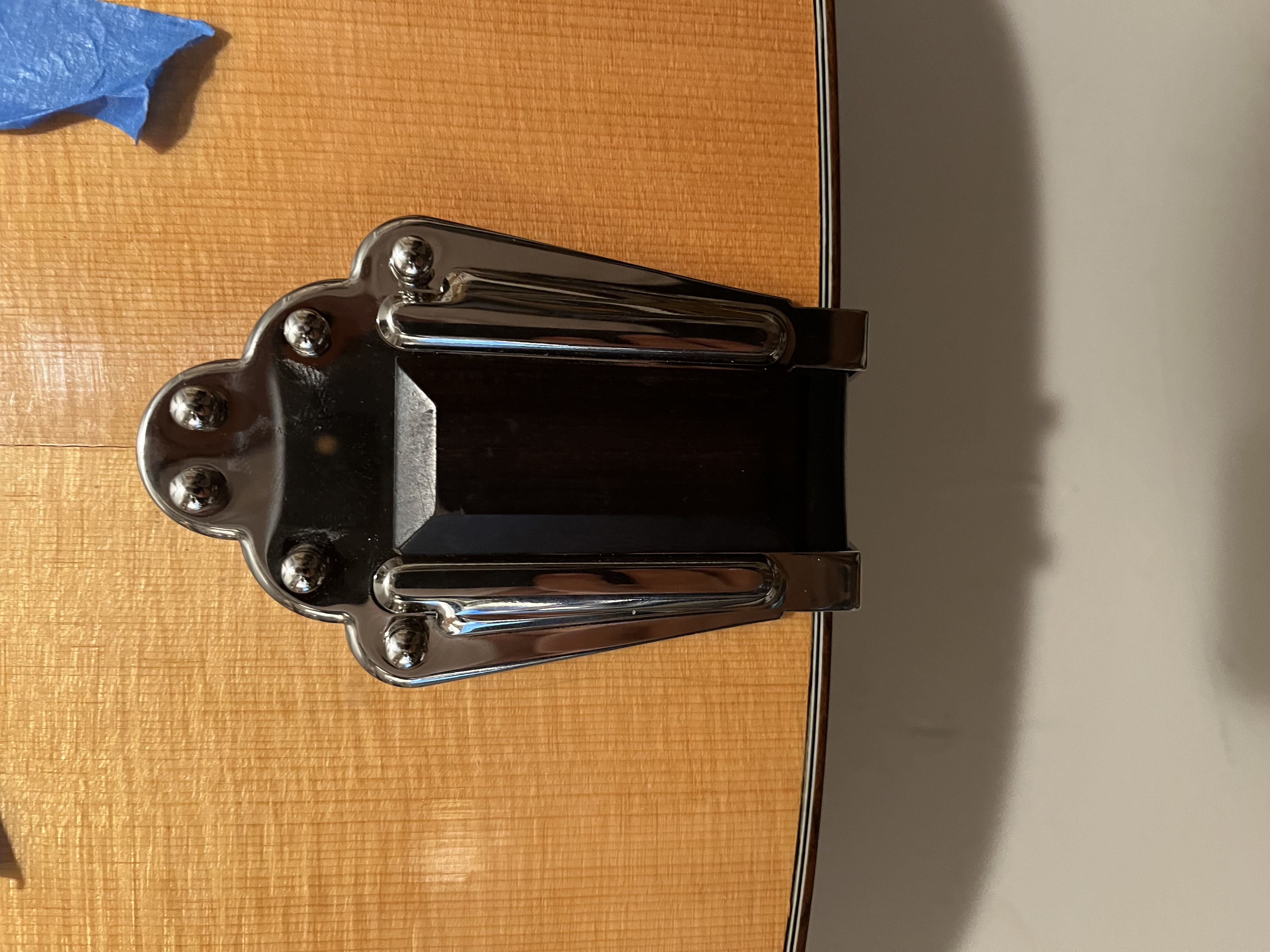

Of course, it was strung with the wrong strings. They looked like possibly electric strings. I installed a set of D’Addario Gypsy Jazz 10s. Sounds really nice, but not really as loud as a cannon like I was expecting or hoping for. I eventually tried some Argentine 11s after replacing the cheap tailpiece with a much better one. It is much louder and really sings with authentic gypsy tone. (The cheap tailpiece was because the guitar had been fitted with a piezo bridge pickup; probably a Bigtone, which works surprisingly well, with no peizo “quack.”)

    Looks great! Is this the new tailpiece or the old one? I think you could go better still with a nice handmade brass one. You could also clean the fretboard! Fine 0000 wire wool between the frets to get rid of that finger gunk. A great guitar for a great price.

    Yeah I am going to clean it the next string change. The new tailpiece is chrome plated brass that my Luthier friend got from France. It is pretty heavy duty and it really added to the tone.

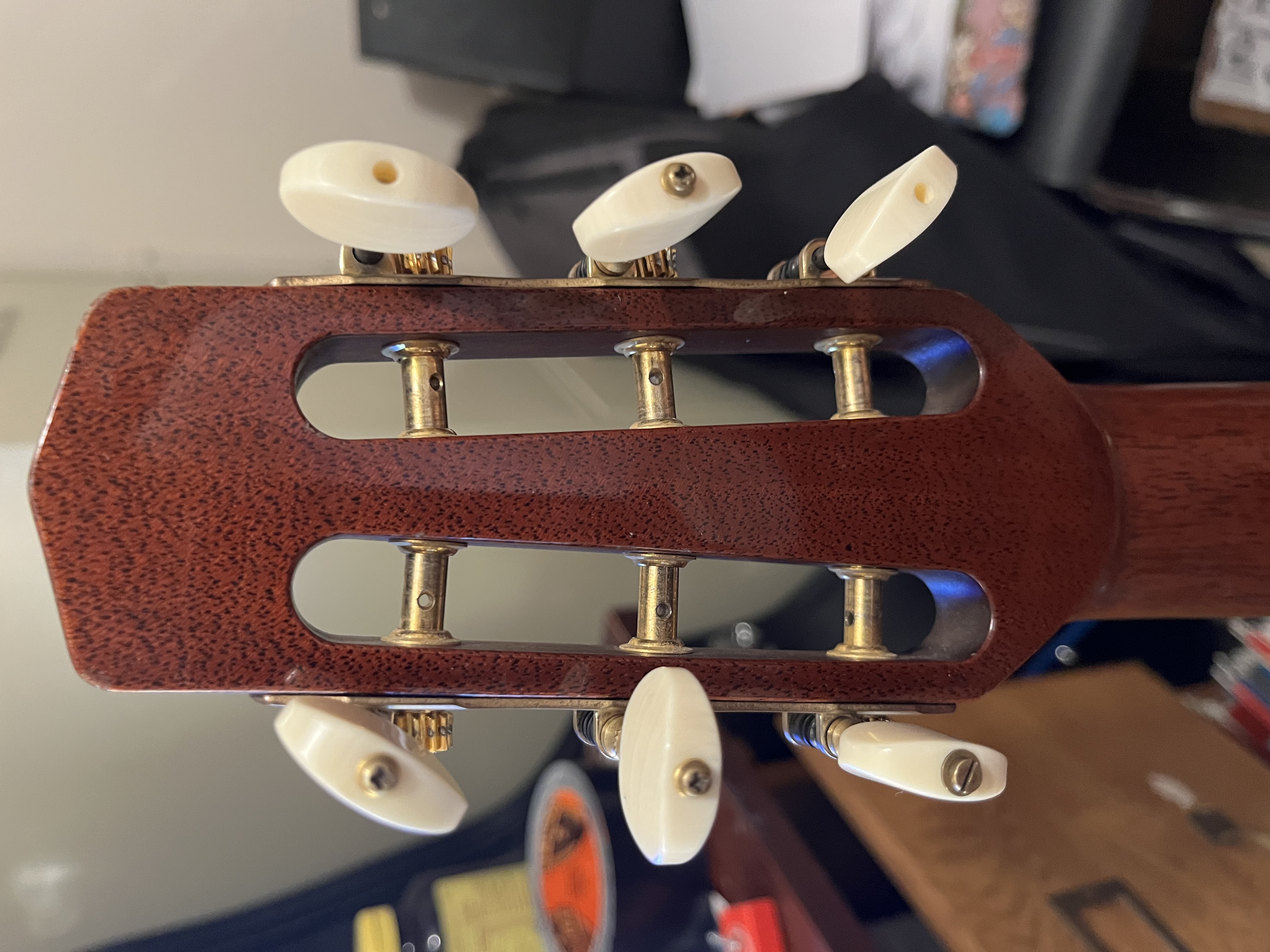

    There were some screws and barrels missing from the tuners and **** found great replacements to restore and keep them all original.

    Is it one of the Dell'Arte made in San Diego? Is that some kind of device attached to the "lower bout"?

    One more observation - the tailpiece cushion looks like it's Gorilla Tape! Get that off!!! Find a nice piece of leather to go in there.

    Yes, it was built by John Kinnard. If you mean the blue thing, it is just some painters tape to hold the bridge in place as I was installing the tailpiece.

    You have a very good eye! 😁 The Gorilla Tape is temporary until I find a proper piece of leather.😎

    Is that Swietania mahogany neck? If so that’s cool. Lighter instrument, like.
    Edit/update: Yes, that’s a mahogany neck.
  • rsclossonrsclosson New
    Posts: 55
    I wish I knew exactly what the neck is made of, but I honestly have no idea.
