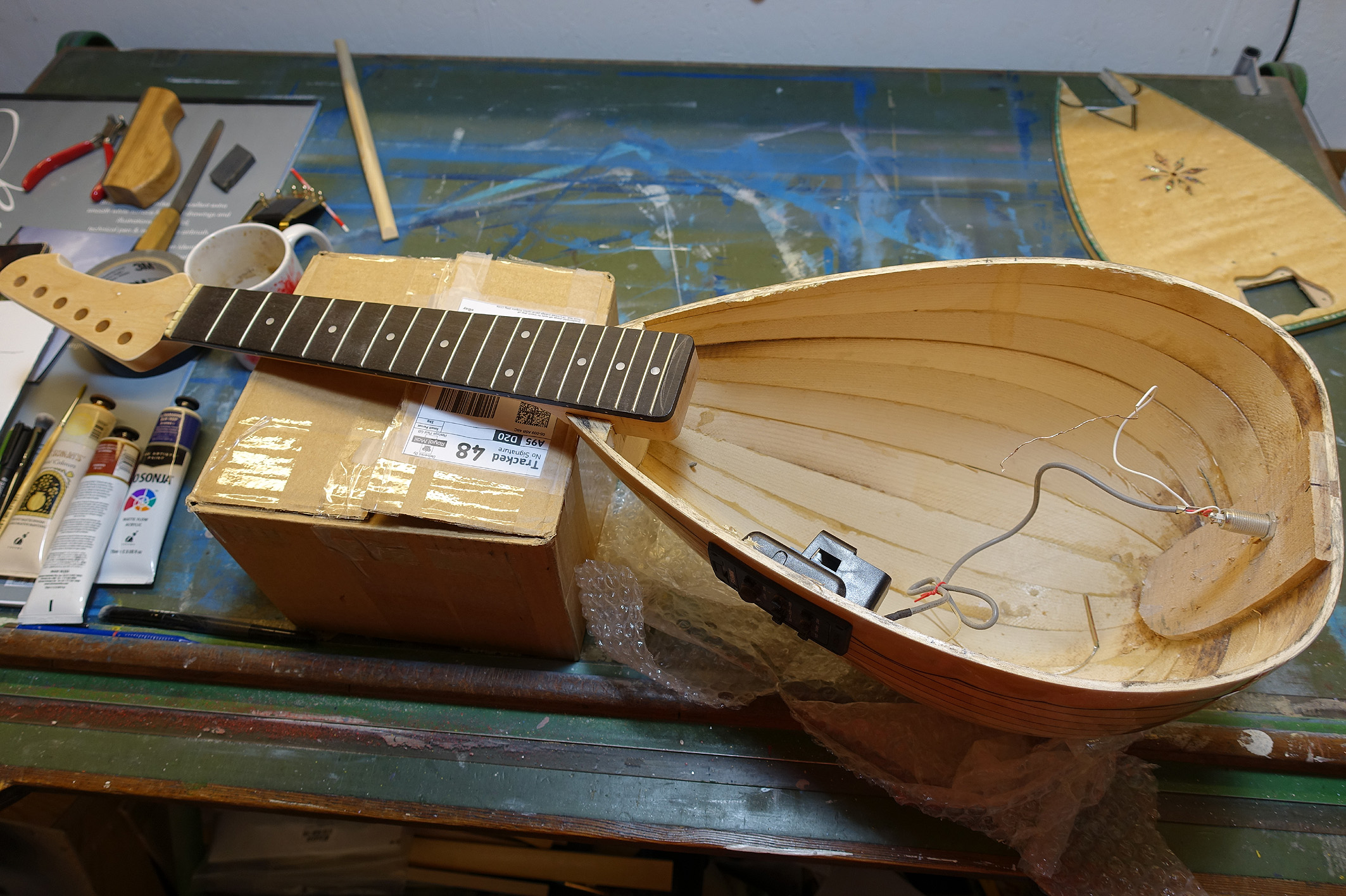

A few more photos. The second one shows where the bridge will be. As you can see, the body is actually nicely made and very light. The top however is just ludicrous and is half the weight of the entire instrument. The Fishman Presys could work ok as it is, but I will solder on a good Bigtone that I happen to have spare and assume the Fishman preamp will handle it ok. Do you think that's correct?
I think that will work. I've never seen a Saz top built like that. I can't imagine why they'd layer plywood under the top.
Will the neck angle work out okay with the shorter scale length and floating bridge? The bowl itself looks nice. I'm a little surprised it isn't paper lined but it looks like the ribs are pretty tight.
Boy, you're not wasting any time. That's so weird that they made the top so overbuilt but overall it's a nice craftsmanship.
I'd say bigtone will work fine with the existing preamp.

I will make the neck angle work. There'll be no arch to the top. If need be, I'll add a shim under the tailpiece like Gitane have done on some of theirs.
The butcher-block construction might have evolved from bad luck shipping instruments unsuccessfully ;O)
