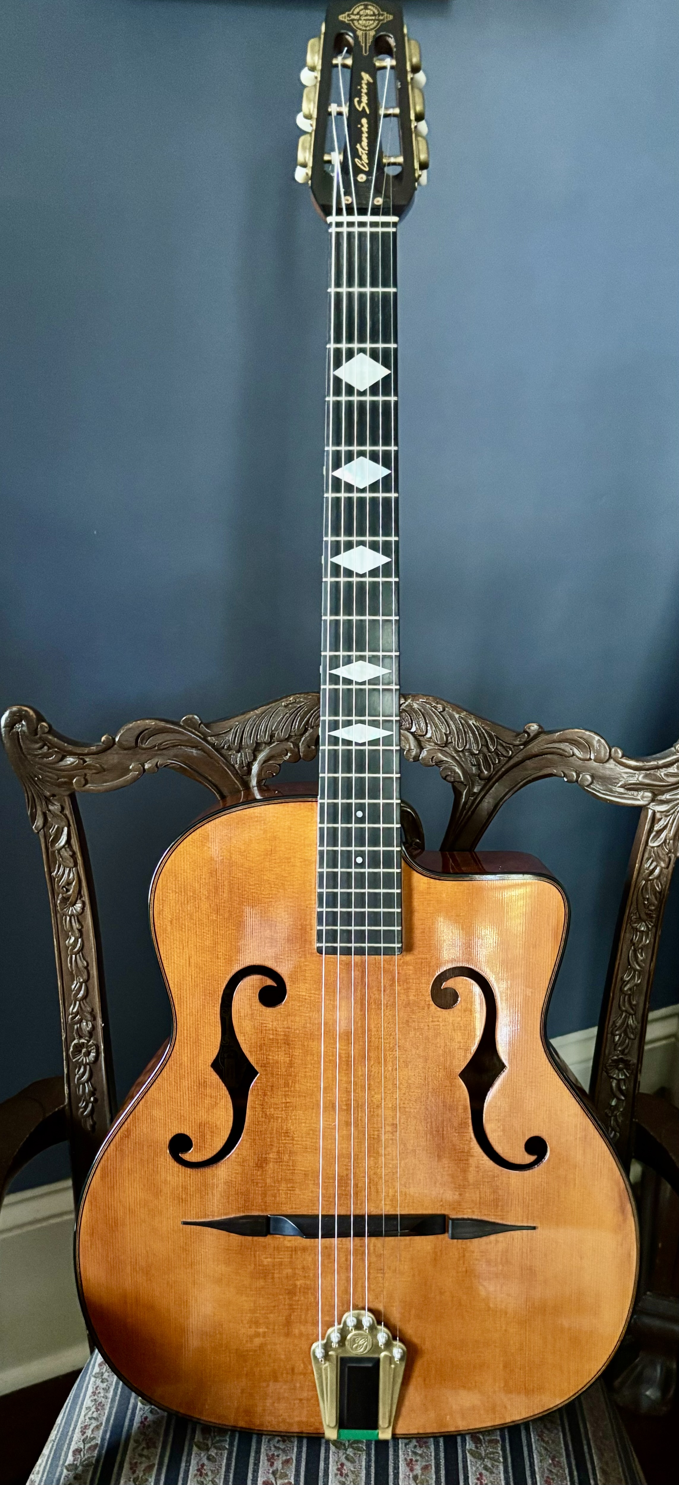

    I did just trade for F-hole gypsy guitar and picked up a JWC Catnina Swing (pictured below). It’s a booming rhythm machine that gives me a lot of low end without having to work very hard. I string it with Argentine 11’s to brighten it up a bit, and if I consciously move toward the bridge for solos, it really sings.
