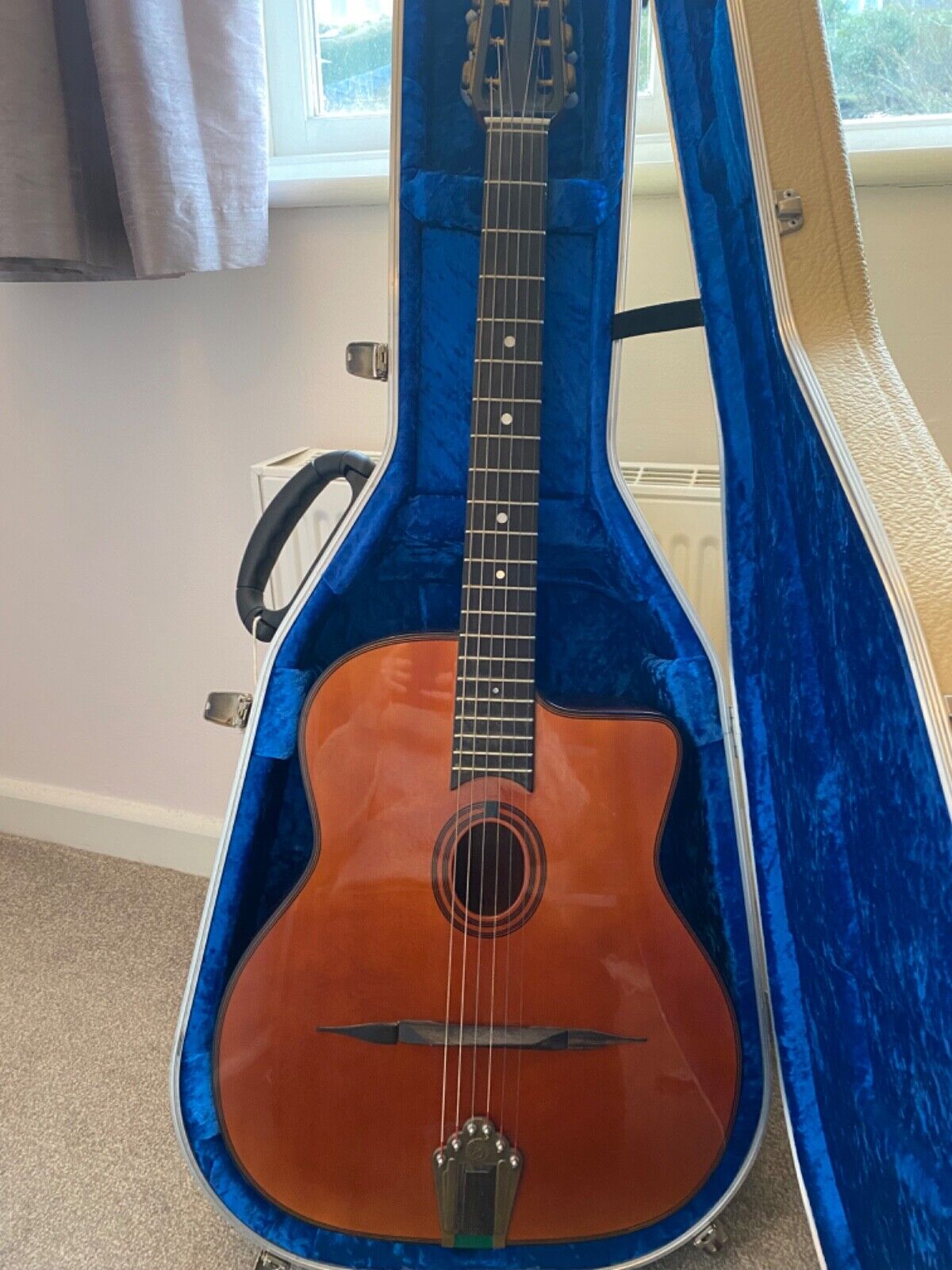

    Ok thanks!! I'm right at the novice end of the spectrum, so all tips and advice very welcome.
    Posts: 729
    Looks good, what did you finish it with?
    I'm of the (hopefully somewhat educated) opinion that finish has minimal effects on sound as long as it's quite thin. Pore filling should have a meaningless effect (or at least, UN-quantifiable). There's a million different ways of pore filling, french polishing people usually use a slurry made of shellac and pumice (I've never done this so I don't really know how it works). I use epoxy mostly. Or nothing. Or something else. People definitely use joint compound, sometimes dyed.
    If you used oil to finish it though, you're kinda done anyway. Pore filler won't stick to it. Just enjoy the guitar.
    Finishing sucks ass, for the record. It's every single luthier's least favorite part of guitar making.
