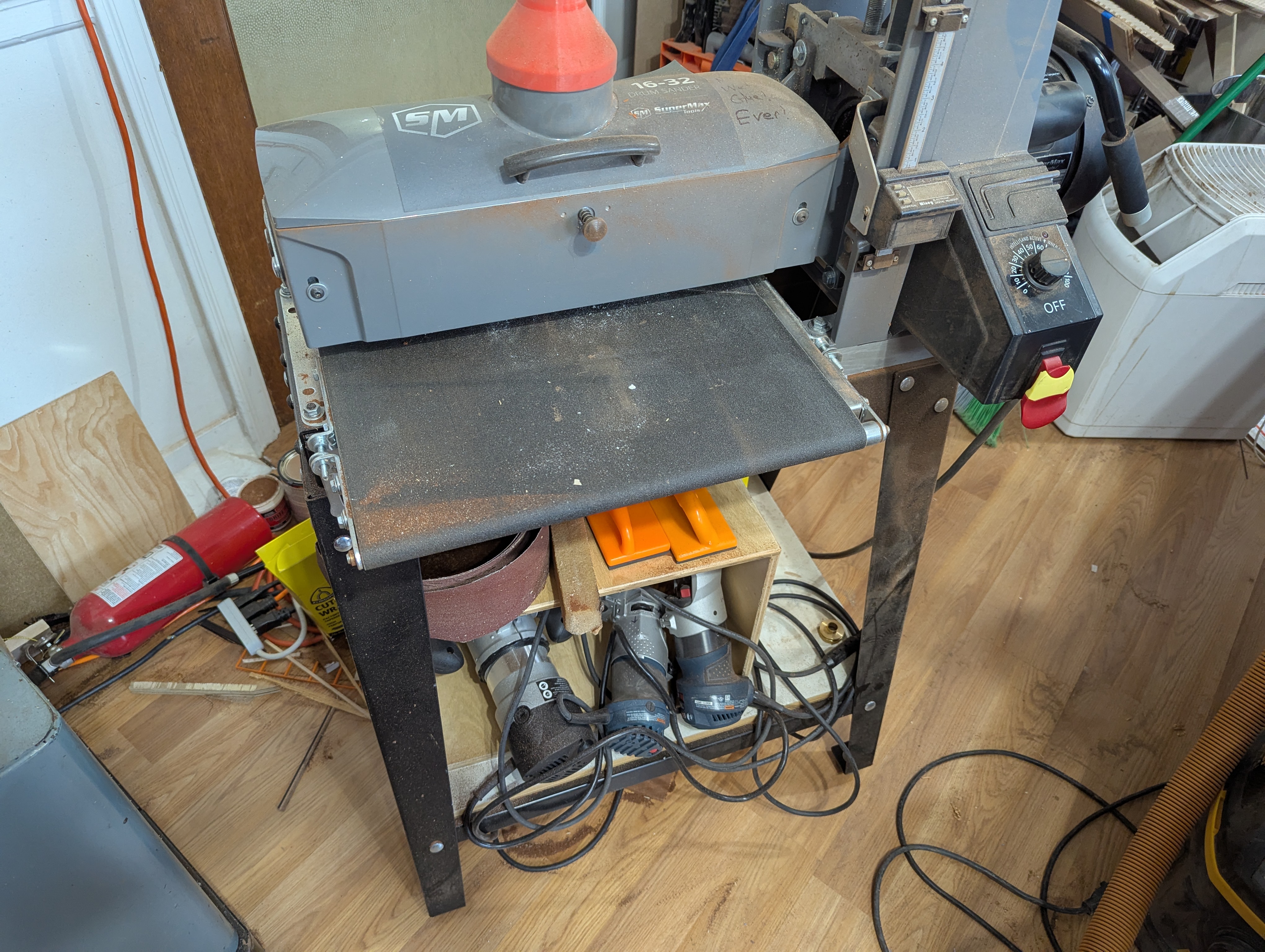

    Thanks for the vid. How do you thickness them? By hand or do you have a wide thickness sander?
    Posts: 662
    Once I had $1500, now I have this. Pretty much essential for me. I have been doing some thicknessing with my CNC but it is super easy to destroy a top on it. Fast though.
    Bones
