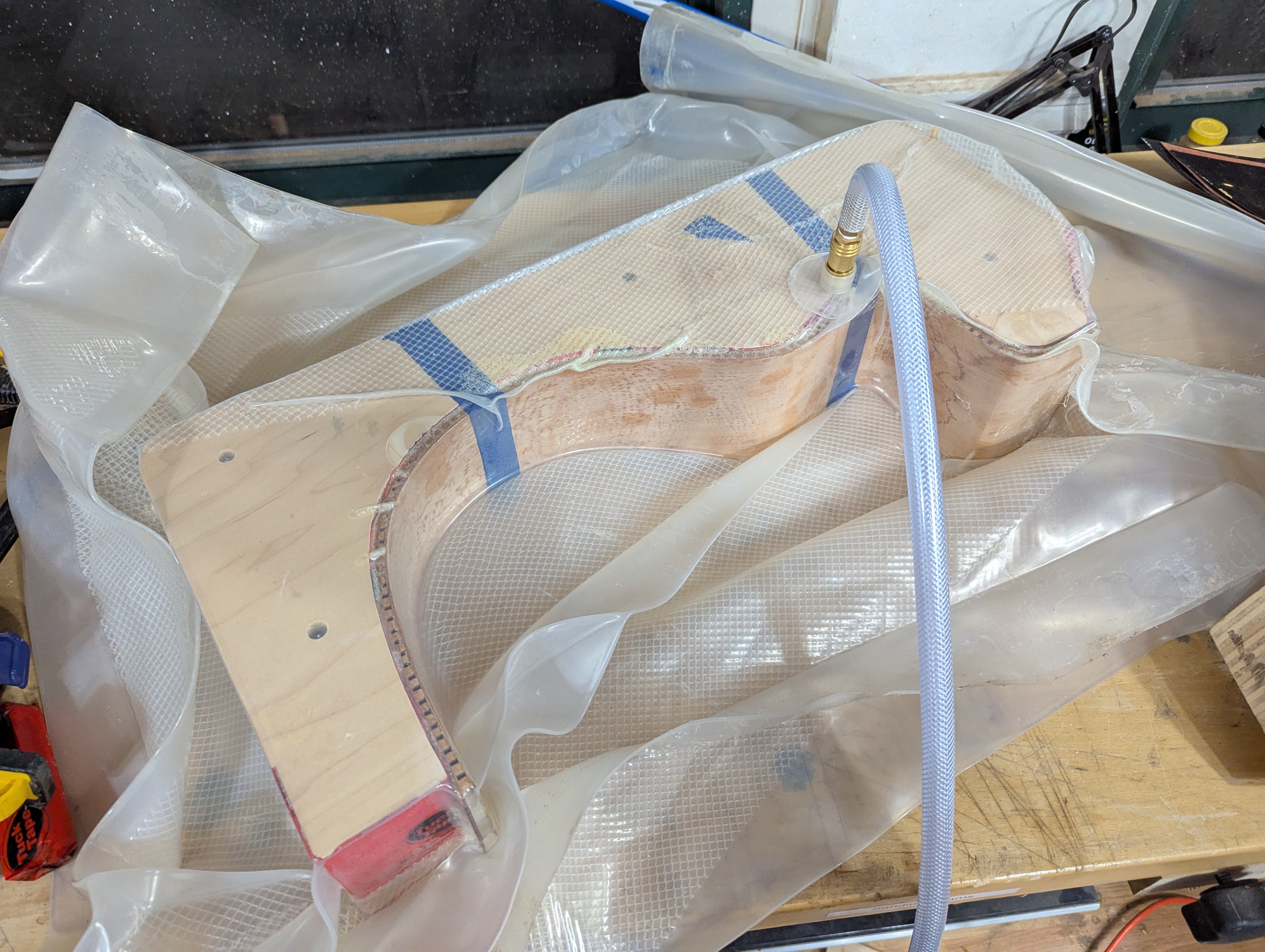

    Posts: 695
    Here's me vacuum bagging the last side of this batch of 3. There's a fun vacuum time lapse for @Buco
