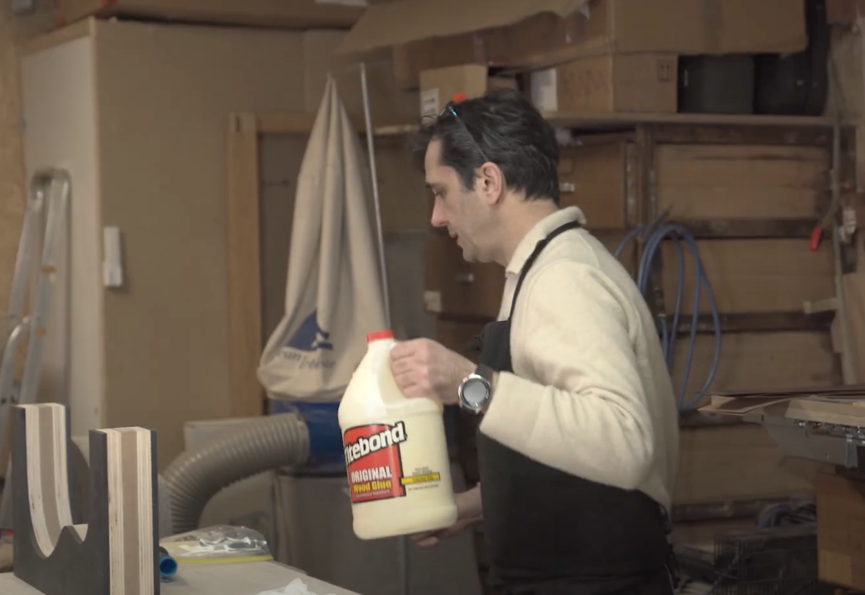

    They shoulda just put a "hide glue" label over that jug. That picture is kinda funny.
    Posts: 435
    FWIW, the two restoration experts I know well prefer hide or fish glue for rebuilding vintage instruments. There various structural/maintenance reasons for that preference, and maybe (in the case of, say, old Martins) sonic ones.

    Hide Glue has amazing qualities. #1 most amazing is that it's reversible which puts it into the sort of art restoration space, everything you do should be undo-able. I think it genuinely is physically harder than yellow glue like Titebond, but I would be willing to be that zero people could hear the different if you could blindfold test someone on two otherwise identical guitars. I would bet a large amount of money on that. For repairs it is cool because of the reversibility. It's essential for violin making because violins are made to be taken apart. If you have to take a guitar apart, something very bad happened.
    Hide glue I think also has a high melting temperature once cured than titebond. Or at least it's somewhat less likely to creep at high temperatures, like in the back of a car.
    But lots and lots and lots of really high end luthiers use Titebond for everything. Some people use a mix. I will used either hide glue or epoxy for braces for the most part (epoxy while I'm experimenting with carbon fiber, hide glue otherwise, although I did use titebond recently for one of my vacuum bagging experiments).
    Ultimately I don't think it makes any difference in sound, whatsoever. You shouldn't leave your guitar in a hot car, regardless. I guess maybe I think there's a teeny tiny chance hide glue might be slightly superior for gluing braces but if I really examine it in my head, it shouldn't make a difference. It's kind of fun to use it for some stuff though.
