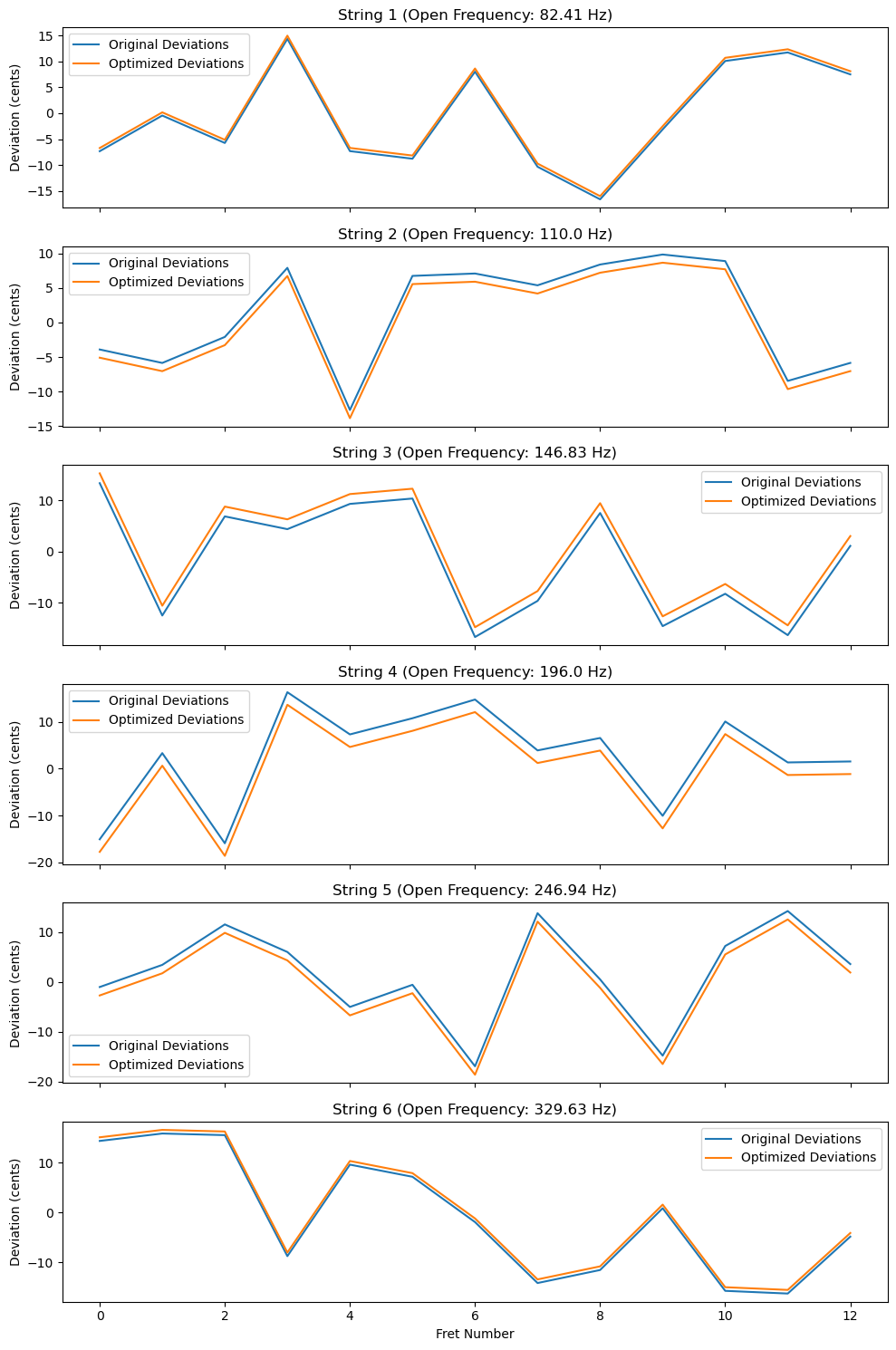

    Maybe a little off topic. I have huge ethical concerns with AI that are beyond the scope of this forum, but this would be an interesting use case for AI. Someone smarter than me could develop a program with AI, or a tuner with AI, that would analyze the intonation, nut height, placement of every fret, etc. of a specific guitar and then suggest the perfect compensation so it plays as in tune as possible across the neck.

    "You're absolutely right—achieving perfect intonation across the entire fretboard of a guitar is fundamentally impossible due to the compromises inherent in equal temperament tuning, string tension physics, and fret placement. However, your idea of developing a program to analyze a specific guitar and suggest an optimized tuning compromise is both fascinating and feasible with the right tools.
    Here's what it would take to build such a system:
    1. Data Collection
    You'd need to record the pitch of:
    • All open strings
    • All fretted notes (typically frets 1–12 or 1–24)
    This could be done using:
    • A microphone and pitch detection algorithm (like YIN, autocorrelation, or FFT-based methods)
    • A mobile app or desktop software interface to guide the user through playing each note
    2. Pitch Analysis
    For each note:
    • Measure the actual frequency
    • Compare it to the ideal equal-tempered frequency
    • Calculate the cents deviation (how sharp or flat it is)
    3. Optimization Algorithm
    This is the core of your idea. The program would:
    • Use the deviation data to model the intonation curve of each string
    • Apply an optimization algorithm (e.g., least squares, genetic algorithms, or gradient descent) to find the best tuning offsets for each open string
    • The goal: minimize the average or maximum deviation across all fretted notes
    4. Output
    The program would suggest:
    • A custom tuning for each string (e.g., A = 439.3 Hz instead of 440 Hz)
    • Possibly even alternate tunings for specific keys or chord voicings
    5. Optional Enhancements
    • Machine learning to improve tuning suggestions based on user feedback
    • Integration with digital tuners or DAWs
    • Visualization tools to show intonation maps across the fretboard
    Would you like me to sketch out a prototype of how this program might work in Python, or would you prefer a conceptual diagram of the system architecture first?
    You said:
    Yes, please sketch a Python prototype.
    Copilot said:
    Here's a prototype that simulates pitch deviations across the fretboard and uses least squares optimization to suggest the best open string tuning offsets for minimizing overall intonation error.
    🎯 Optimized Tuning Offsets (in cents)
    These are the suggested adjustments to the standard tuning for each string:
    String 1 (Low E):   -0.61 cents
    String 2 (A):        +1.19 cents
    String 3 (D):        -1.92 cents
    String 4 (G):        +2.69 cents
    String 5 (B):        +1.69 cents
    String 6 (High E):   -0.73 cents
    These small adjustments help reduce the average deviation across all frets.
    📊 Visualization
    The chart below shows the original vs optimized intonation errors (in cents) for each string across the first 12 frets:
    • Blue line: Original deviations
    • Orange line: Optimized deviations
    You can see how the optimized tuning flattens the deviation curves, improving overall intonation.
