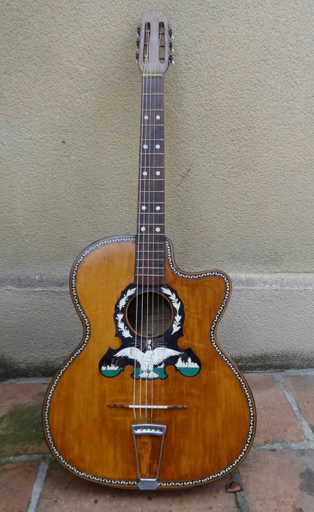

    A rather beautiful and rather rare Carmelo Catania "Model 18" , - perhaps the firm's most decorative model. For sale, you know where, and at $4,000 USD / £3,000, I'd need a lottery win to add it to my humble collection.

    Yeah, I too had seen and admired that one. Could it have been the most decorated Carmelo yet, possibly made to show what they could do for an exhibition or to special order? Hard to believe they would have made many this fancy, and yes, I too could not justify that price, much as I like it.
    With all the expert luthiers on here one wonders how all that inlay work would affect the resonance of the top, any thoughts?

    It would be bad. Very bad.
    It's not only that the top is inlaid, it's that it looks like the actual top is Mahogany joined at an angle.
    I mean, there's always surprises, but the reason everyone uses spruce is because it has a very high stiffness to weight ratio and the density is ideal for making lively guitars. Mahogany is a lot heavier, so less ideal by a long shot. Mahogany inlaid with a bunch of other junk, even worse.
    Maybe it sounds amazing but I'm guessing it sounds like a pile of crap.

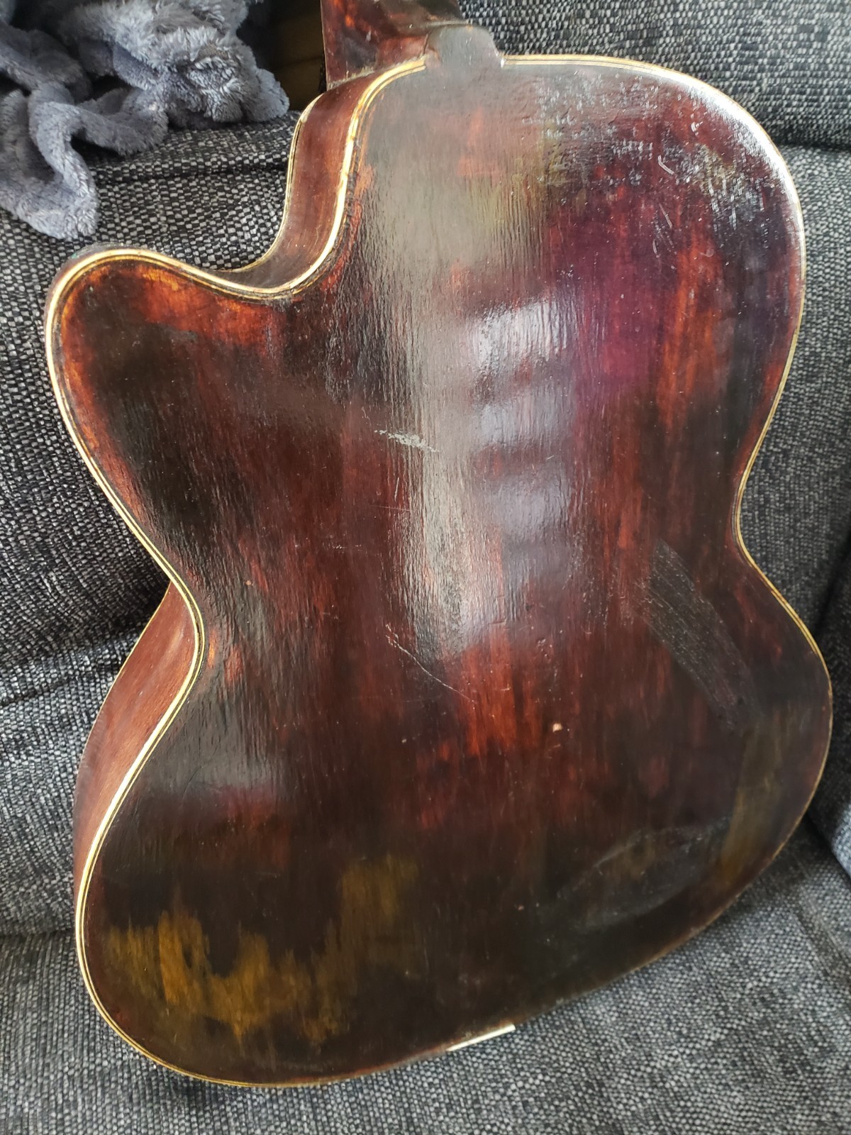

    Here is the guitar. Everything fixable, but I need to think carefully about the neck. There is a slight twist. It would be ok as it is I think, but I'd much prefer to have a nice straight fingerboard - I want this to be a playable guitar! As it is, the bridge sits directly over a brace (thoughts on that please). The scale is long at 680. There is no radius to the fingerboard. I could plane the fingerboard flat and add a slight radius. Could I make it a 13 fret join, and reposition the bridge slightly forward? There is plenty of space to do that on the fingerboard.
    The tailpiece looks original - no other holes underneath. Machine heads need switching round!! but they work.
    Any other thoughts? It has a huge bombe to the top!
