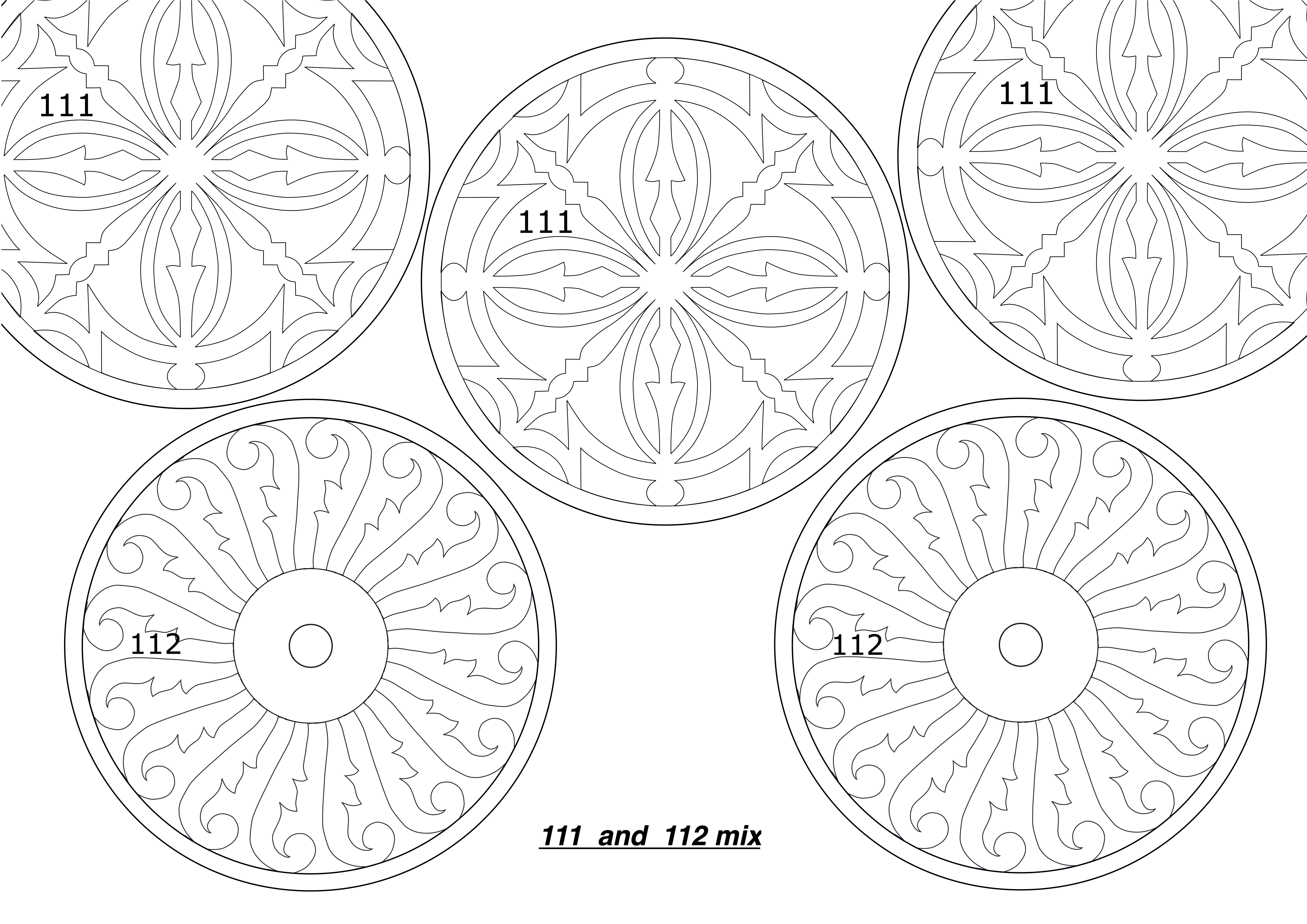

Of course I reckon your guitar needs super decorative soundhole rosette, pickguard and elbowguard - I have the templates, including both rosette styles ;-)

As I’ve said earlier, I think the black caulk on your sound hole decoration is volcanic dust from Mt. Etna set in resin 🌋🌋, (Stradivarius favoured the volcanic dust from Vesuvius for the finish on his violins 🎻),and I really hope you choose to reinstate the central rosette, elbow-rest and pick guard , as in the following picture…

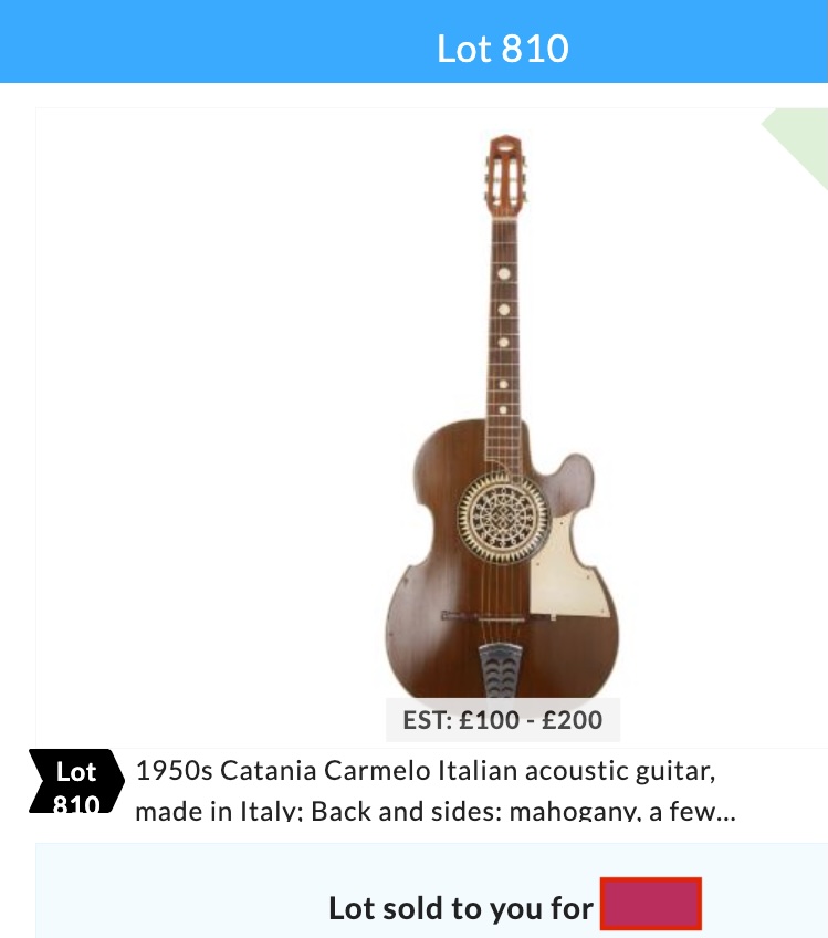

Oh great! Same BIG inlays as my Caponetto. Love the body shape!
You didn't fancy the black non-cutaway guitar as well? Possibly a lump of junk, but the soundhole decoration was rather nice.
