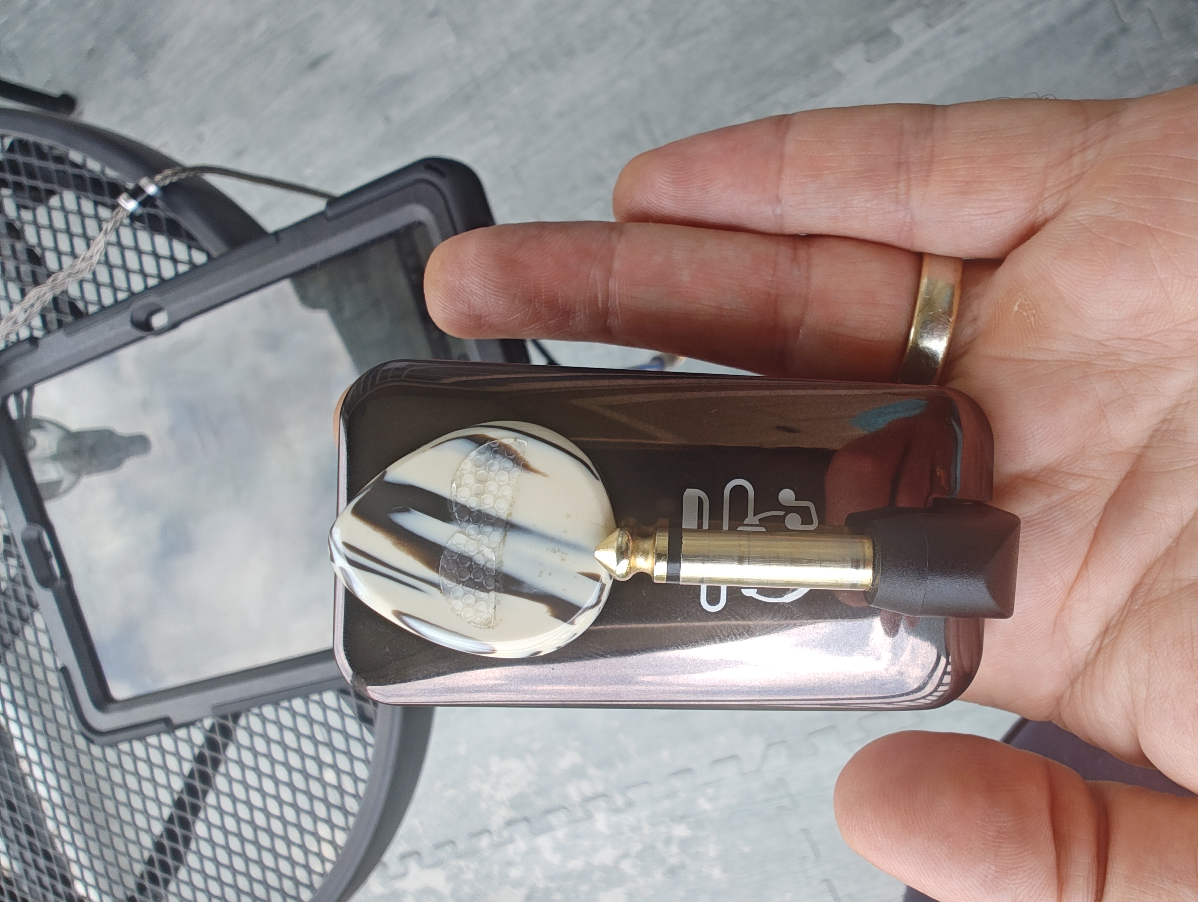

  • Posts: 5,817
    This is a headphone amp but that's roughly the size. Slightly bigger than a humbucker, I'd say it's 1/8" wider and 1/4" longer.
    There are smaller and bigger than that. $200 sounds like a top end. Even the ones at $30 on Amazon get surprisingly good reviews.
    I like the idea of mixing it with a mic.
