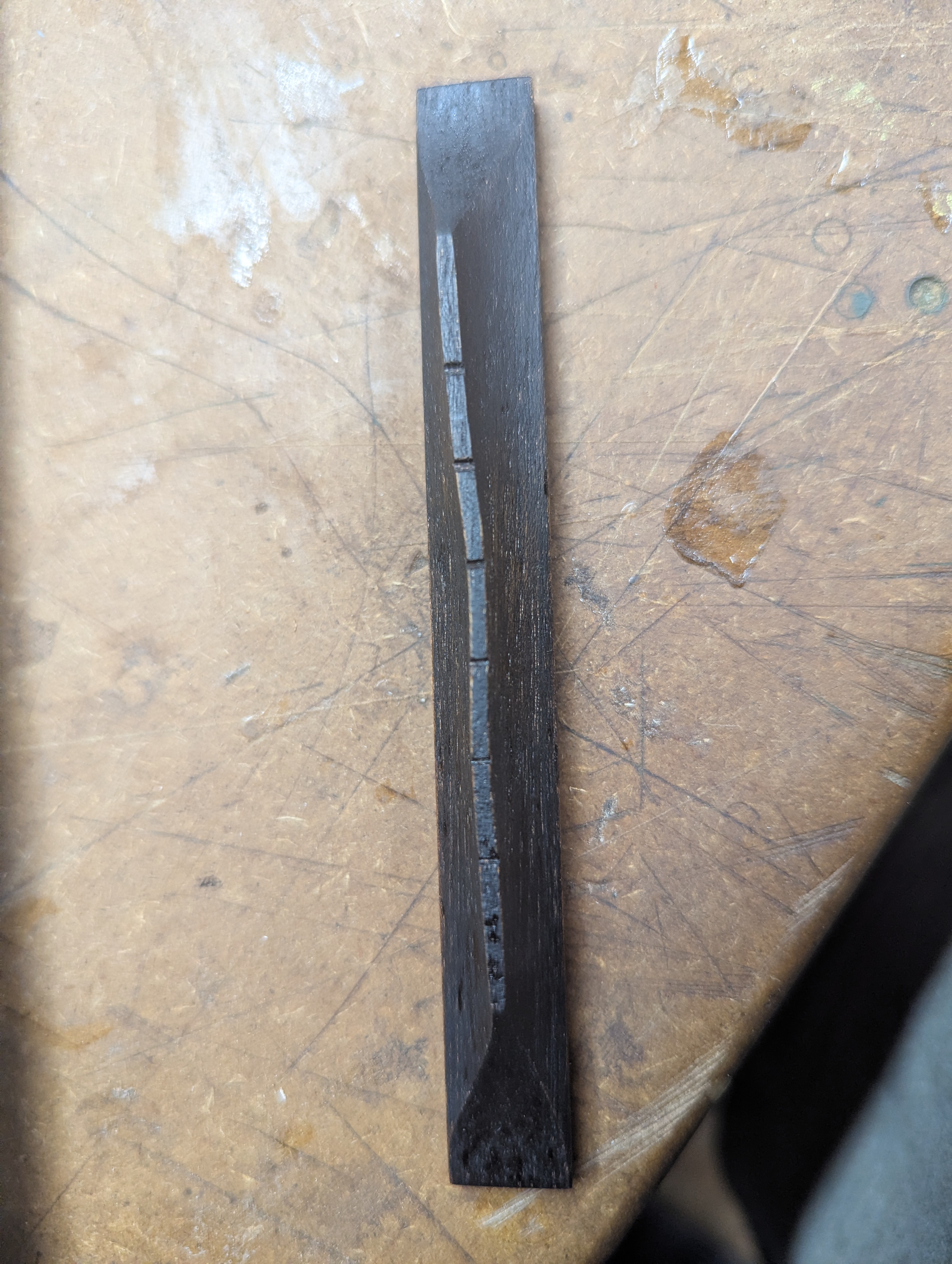

    I'm pretty excited about this, I've been wanting to do this for a long time. Fully compensated Selmer bridge. I moved my bridge around to figure out the correct string length for each string and designed a bridge in my CAM software that puts each string at that distance.
    Gonna string it up tomorrow. This is a test one in ebonized Sapele but this stuff is strong.
    It looks a little funny but I was ending up with my bridges tilted to get close to decent intonation.

    Wow, that’s cool!
    paulmcevoy75billyshakes
    Posts: 662
    Thank you. Sometimes I wonder a bit how much learning CNC has slowed me down, at this point it definitely hasn't made me faster. But in this specific case this would be difficult or impossible to do by hand. At least, not by me.
    These pictures are terrible, it looks much cooler than that. You'd not know that I was a semipro photographer in a past life. I'm going to make another one today out of Wenge and that stuff ebonizes really nicely.
