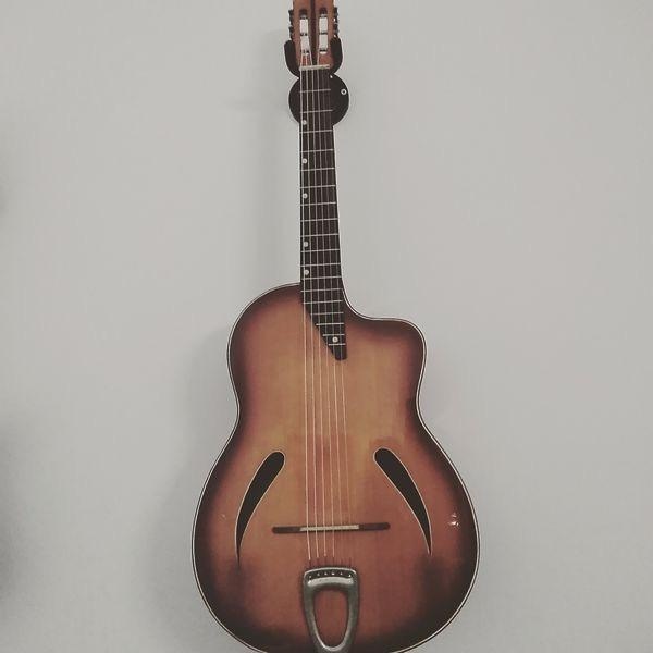

    I steamed the neck butt-joint apart and straightened the bowed neck with a couple of carbon fire rods, refret is done - tricky in the soft pearwood (?) fingerboard - but I still need to level & crown. I'm trying a bolt-on conversion to correct the neck angle, final angle adjustments with strings on (then glue down the fingerboard extension).
    I'm still convinced mine is a P.Bucolo, I'm fairly sure the rare "Ikea Klumpa" guitars were actually made by Busato...

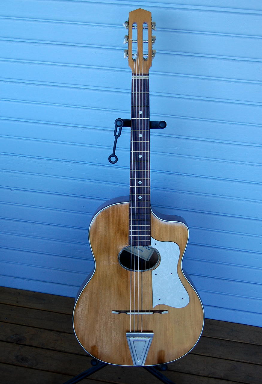

    And the Bucolo(?) / Napoli(?) is up & running: the clock/painting is a guitar once again ;-)
    Still some finishing work to do, I'll post a wee video once its 100% sorted.

    Finally got around to fixing the Bucolo and this is what the neck joint looked like once I removed the fingerboard, yours was missing the dovetail completely.......

    Still having trouble loading photos; here goes another try.....Finally got around to fixing the Bucolo and this is what the neck joint looked like once I removed the fingerboard, yours was missing the dovetail completely.......
    ah yes, that worked.
    So while I am winning I may as well add another showing after the carbon rod was routed and glued in.

    Yes, all done now. I posted that photo to show that once I had removed the fingerboard there was an obvious dovetail joint on mine whereas Andy W had previously posted photos of his showing what appeared to be a plain glued butt joint. We had thought these were the same guitar by the same maker but there is a big difference in construction.
    As for mine, yes I removed the back to reglue a brace, cleat a couple of cracks, reglued the heel block in the right place, straightened the neck, reinforced with a carbon fibre rod, reglued the fingerboard and refinished the body by cleaning and sanding old flaky finish (it was rather tired), using a few coats of shellac to fill the grain again and add sheen then a couple of coats of nitro to add a protective finish.
    Then all the frets needed was a light crown and polish and I refitted all of the original hardware; the bridge, tailpiece and scratchplate. I refitted the tuners too (I don't know if they were original, probably were going by the fact that there was no sign of any old screw holes), but a couple of them were so stiff it was hard to tune so I replaced them with a generic set.
    With a 43mm nut width and a scale length of 622mm it is smaller than most, light weight and very easy to play with a bright clear tone; I doubt Michael would describe it as a 'cannon' but there is enough volume for normal use.

    Posts: 639
    Chris - re. my posts of Feb 1st - - are you not buying my ""P. Bucolo- Catania" = "Antonino Napoli - Catania" possibility ??
    - that little Chitarra is surely out of the same "former" / same workshop, despite the cats-eye f-holes ??

    I agree one can see a similarity but I am not convinced. The shape of the cutaway and the rounded shoulder does look similar but the Napoli appears to be longer and narrower overall.  That may be just an optical distortion due to the different soundholes or colours too, so you may be right.  Then again, ownership of a shape, a mould or former is not proof of anything either, I am certain many shared designs came from different makers (maybe some luthiers even made and sold the moulds on) I have a stack of mdf profiles in the shed taken directly from a Di Mauro that I will get around to using one day to make my own, of course they will not be Di Mauro guitars.
