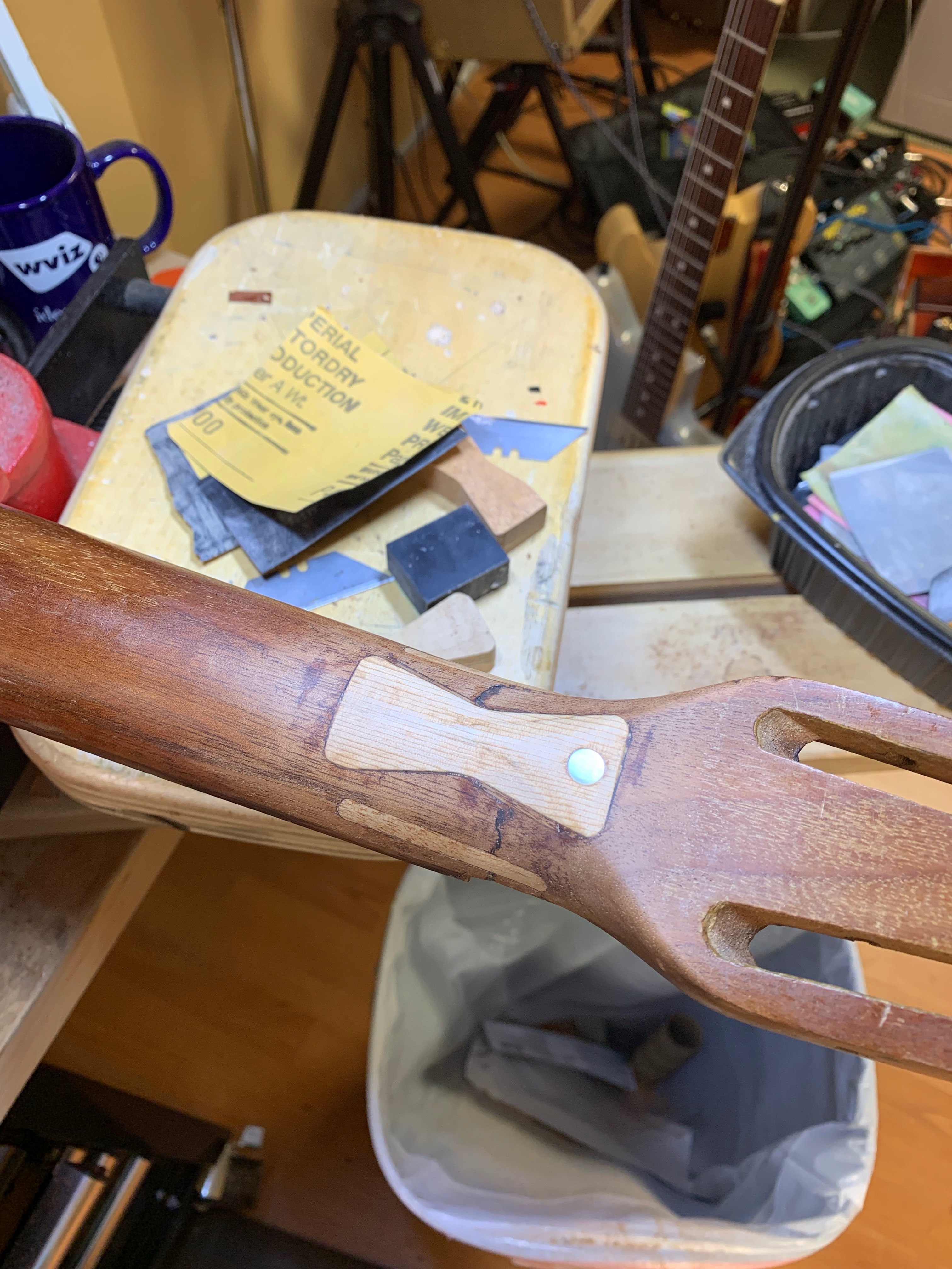

    I just discovered this thread on my repair of Andrew's DiMauro. This one took a lot of planning. The finish on the DiMauro is thin and transparent, so any repair was going to be visible. The bowtie inlay seemed to be a good choice with great strength and good appearance. For those of you interested, here's a video of the repair I posted to Facebook.

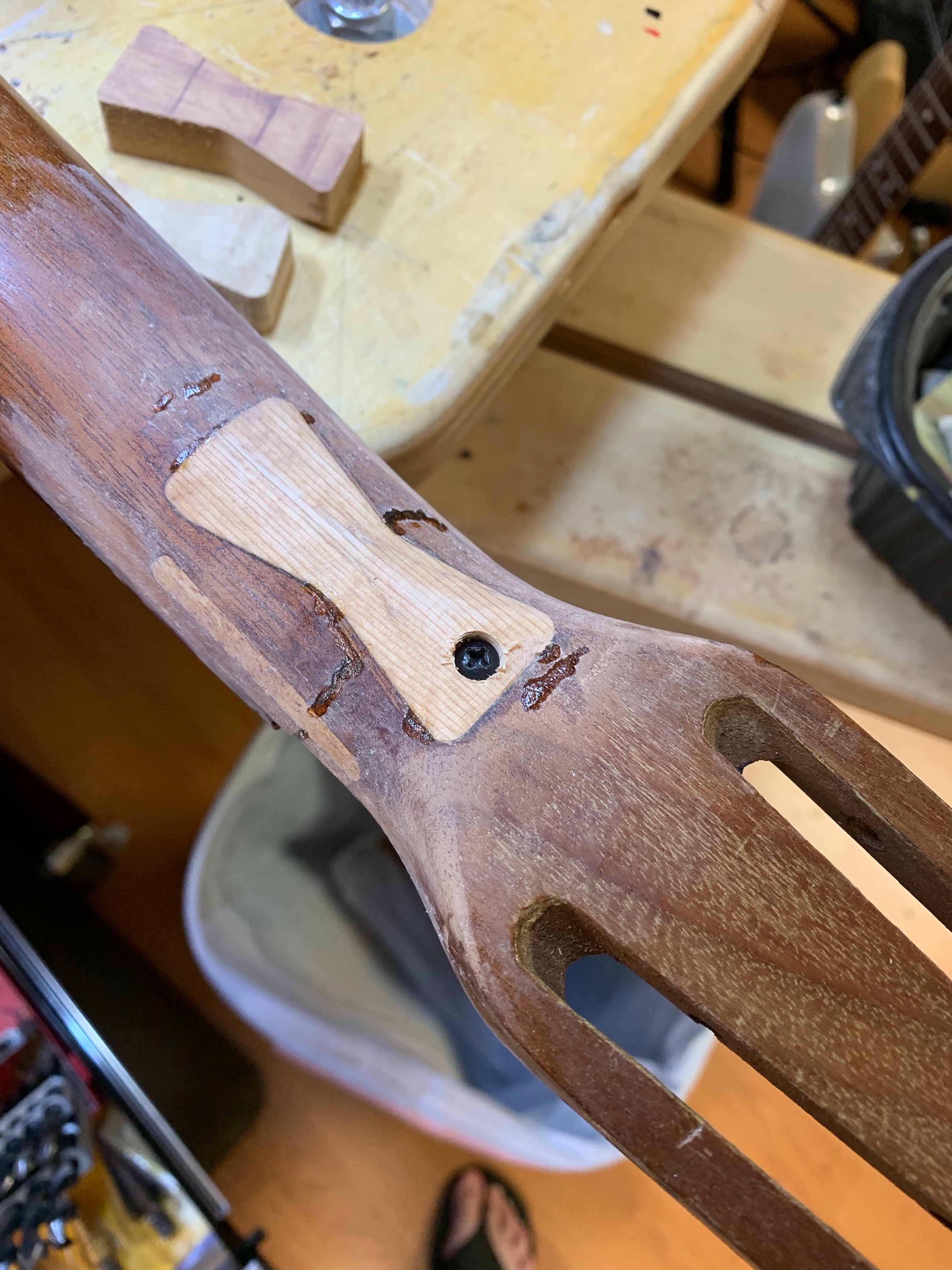

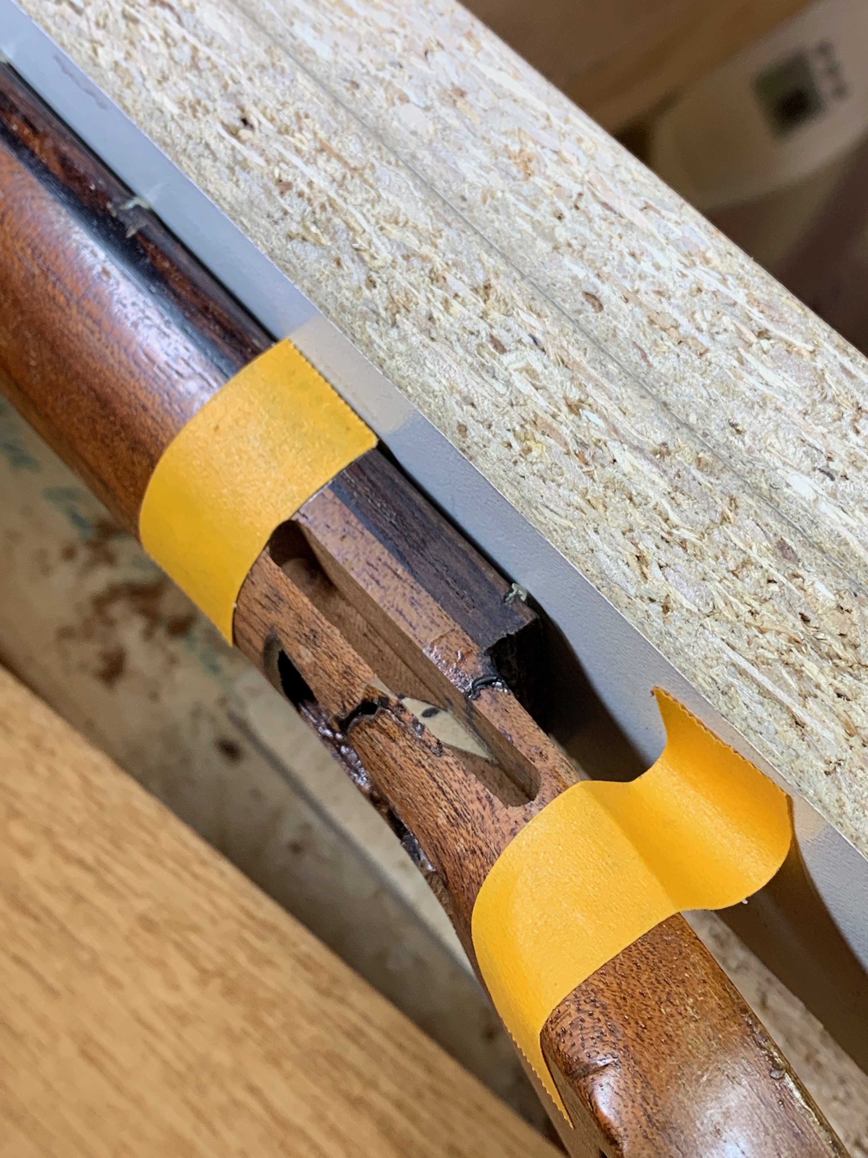

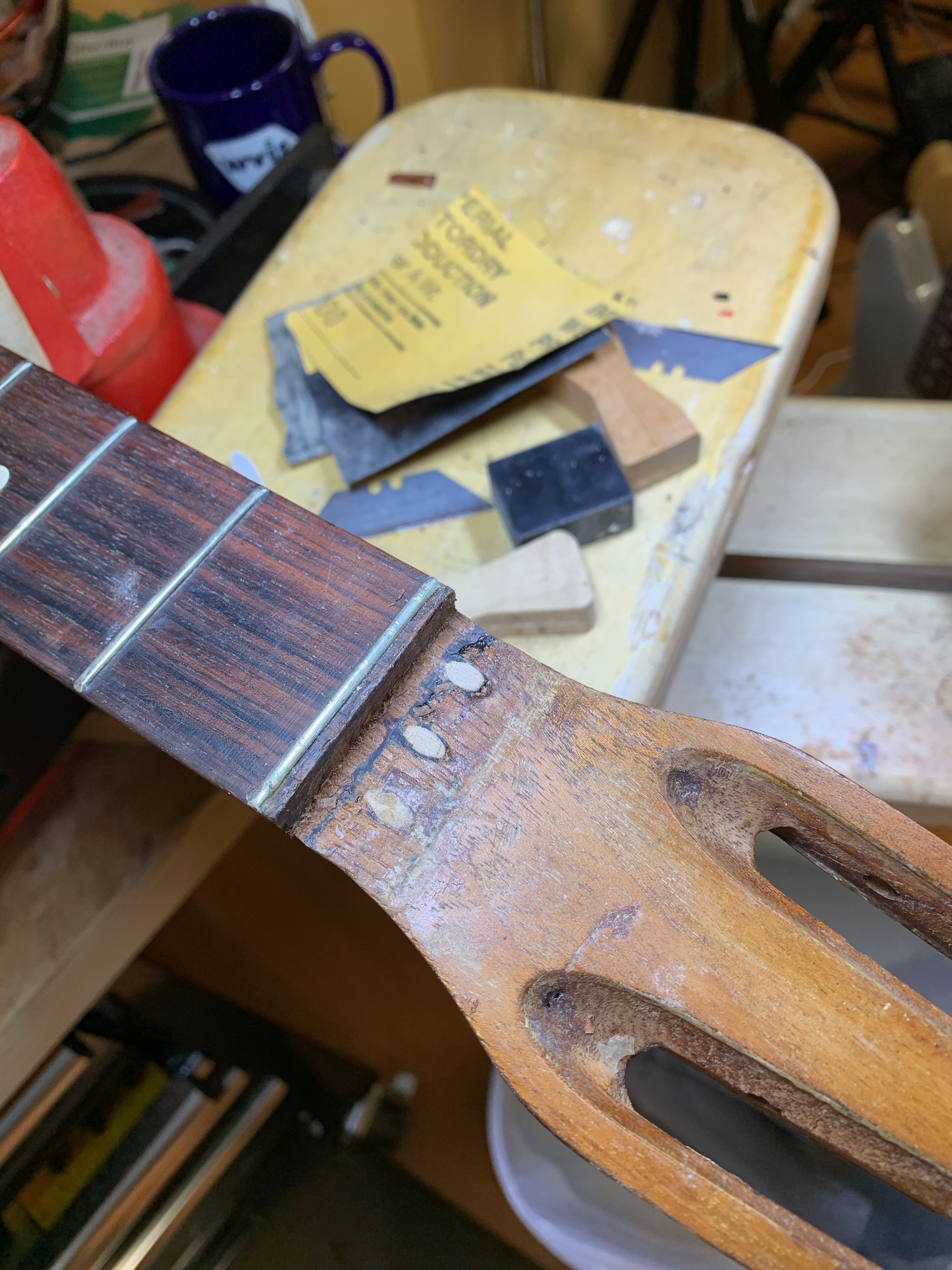

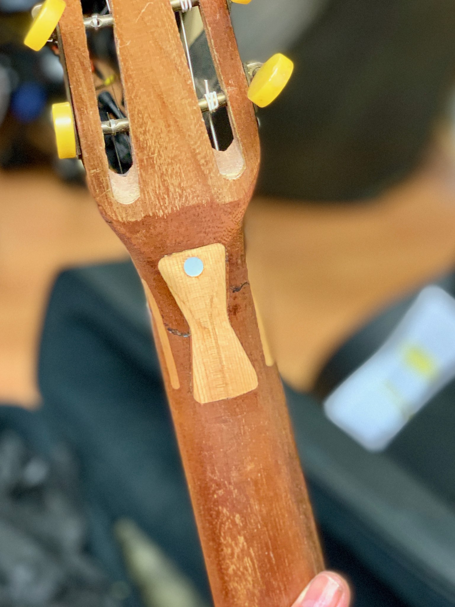

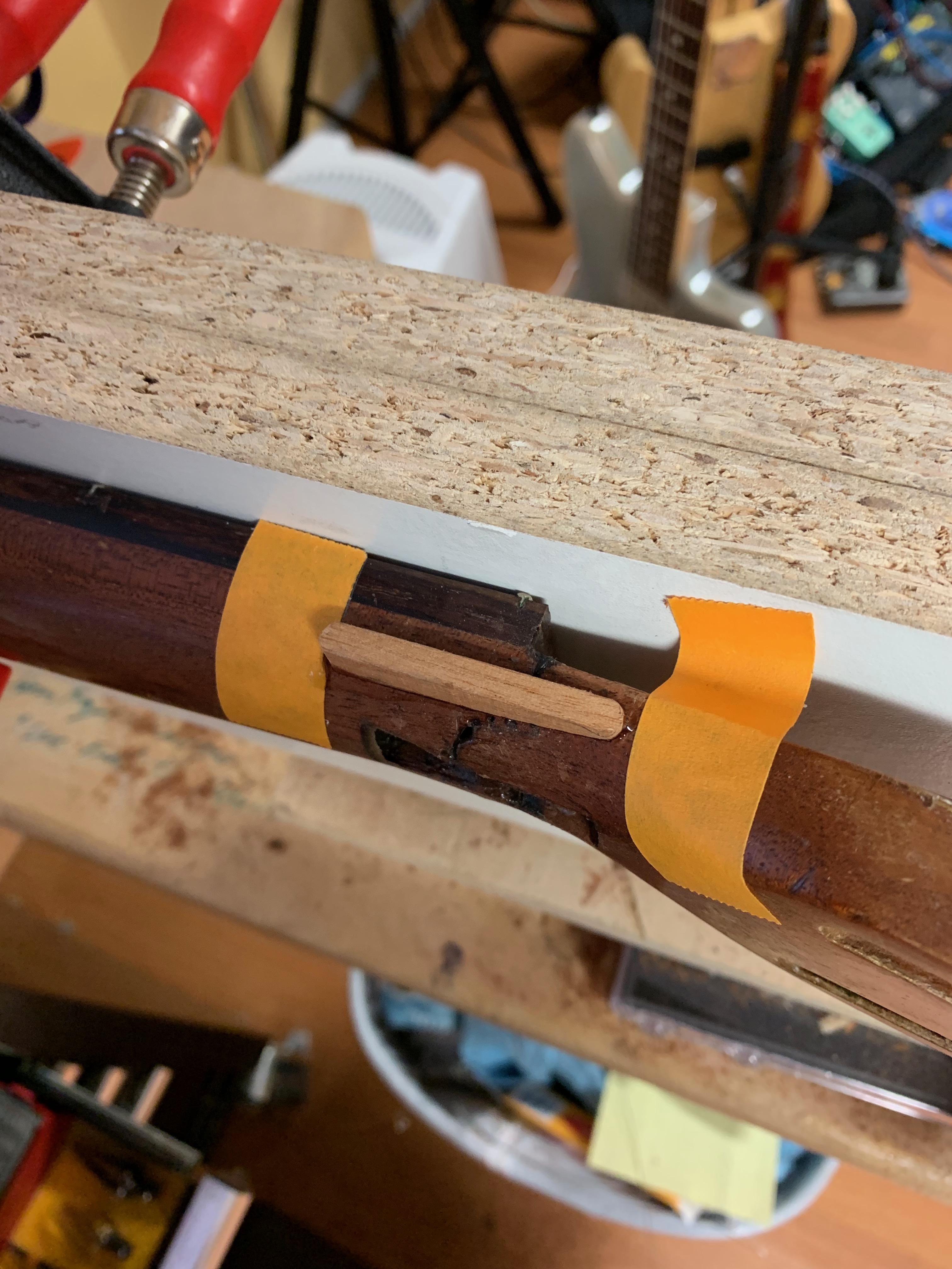

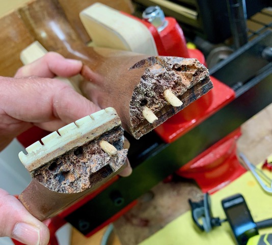

    Well, the DiMauro is back from the shop - hopefully permanently. Jim first completely disassembled the mystery repair. The three short dowels were ineffective at best.
    These are out of order...
    of course Jim has to replace the dowels even though they weren’t helping much...
    A larger spruce bow tie with a screw...
    Two lateral

    Is this a recent repair? I thought it was broken last year. Perhaps it is a repair of the last repair? Is it cost prohibitive to have a new neck made and installed? I'm sure there are a few guys around who could do that, Martin Tremblay comes to mind. Good luck!
    Posts: 542
    This particular instance of repair was just completed in August (2019). A repaired was attempted last year but it just didn't hold up.
    It was a particularly bead break, vertical across the grain such that the glue joint was essentially a butt joint with all kinds of leverage working against a very small gluing surface.
    My luthier, Jim Kozel, disassembled the entire break, removed all the old glue & dowels from the original attempt at fixing (before I bought it). He then redid the repair from scratch, adding a lateral spline on each side of the break in addition to an enlarged bow tie spline on the back of the neck. The resulting Frankenstein neck seems a lot more stable - we shall see.
    I did consult with Martin Tremblay, but we agreed that the repair plus shipping back and forth to Canada would be very expensive. I'm pretty sure it would not be worth having a custom built neck made and reset. These DiMauro Modele ****, while nice sounding, are not particularly valuable.
    If this doesn't hold up, I'm done - it will become a decoration...
