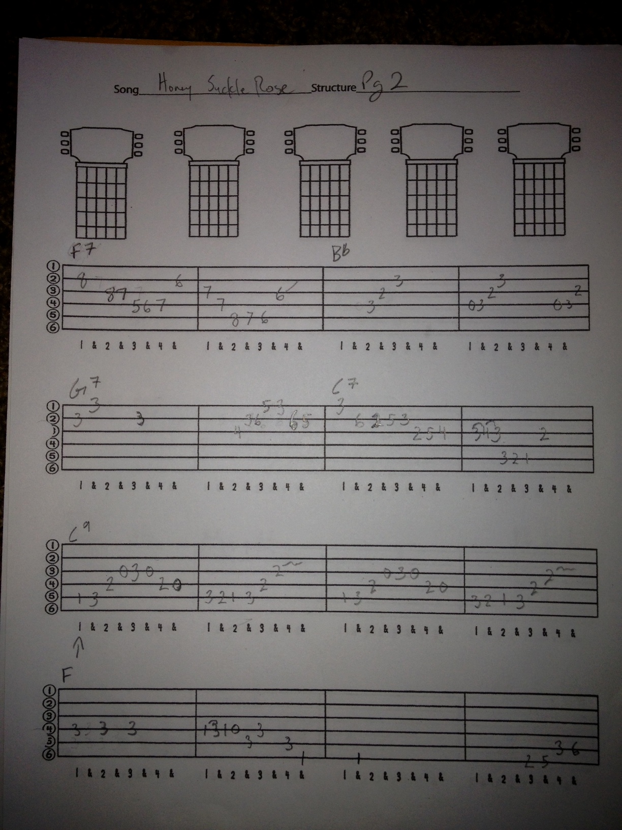

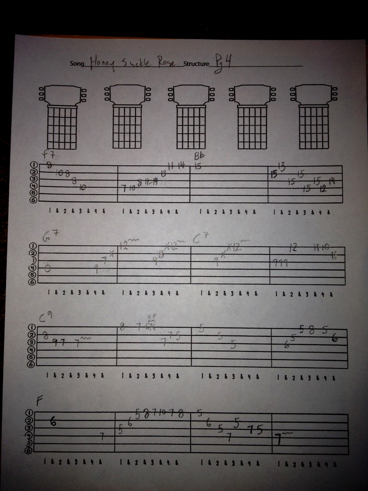

This is my first attempt at tabbing out a solo, and I've attached photos I took of the pages to this post. Please feel free to print it out and give it a test run.
Also feel free to critique my tabbing job.

    good job. some of the positions in your tab would not have been usable for django (he would play more horizontally) but they feel fine for 4-fingers. i've attached a pdf of the transcription, which might be a bit more palatable to other members - because the jpgs were upside-down, too dark, too big.. i've corrected these things somewhat and sharpened the image. thanks again for sharing your work.
