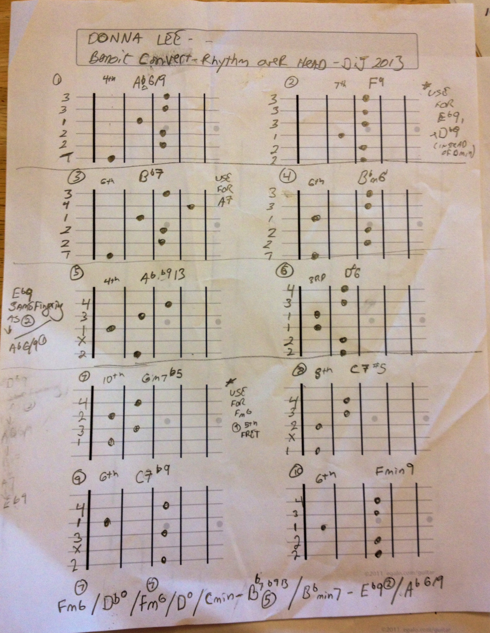

  • These are the chord forms I see Benoit used. I did it awhile ago by ear and never wrote it down, but these should be all of the chords you will need. Mind you, I am assuming you have the chart for the tune. I did not write down every single chord in order...I noted when to use a chord form. At this point, you should take the video to a slow downer. Hope this helps.
  • T1mothyT1mothy ✭✭ Furch petite bouche
    Posts: 79
    Wow, that is some unexpectedly detailed help.
    Bopster, thanks for the great video! Stuart, thanks for the different voicing tip and Jim, thank you for sharing the charts with me.
    I want to thank all of you for taking your time to help a newbie!
    Timothy
  • Not sure if my chord names are correct, but you are welcome. It was a very clear video.

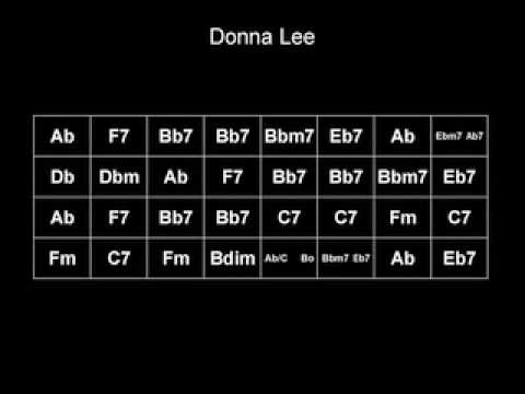

    Gypsy Jazz Play Along - Chord changes to Donna Lee
    Gonzalo Bergara

    I think it is essentially the same form as Back Home in Indiana? That's one of the tricks that beboppers (and others) used- take a harmonic structure from another song and put a new melody on top of it.
  • edited September 2014 Posts: 3,707
    Donna Lee is based on that tunes @Bones..... according to Mark Levine...author of the Jazz Theory Book.
    Posts: 1,896
    Yup, same chords as "Indiana" except transposed from F to Ab.
    There's an old joke about two jazz musicians sitting in a diner, reading a newspaper.
    "Hmmm, look at this headline: 'Three die in Indiana bridge disaster'"
    "No way! Indiana doesn't have a bridge!"
