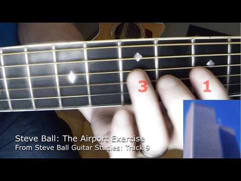

    Hi Dean - I read your original post a while ago, and when I came across Steve Ball's "The Airport Exercise", I thought of it.
    It's simple and nice - and if you have a look at the video, you'll likely have an idea to take away and try by about 0:35.
    I know very little about this player; I came across his name in the Wiki article about Fripp's "New Standard Tuning", which I was curious about for a minute or two. I love Fripp but I'm suspicious of any cult of personality - and I wrote that with a straight face into a forum named after Django Reinhardt. How we do delude ourselves. Anyway Steve Ball is or seems to be a fairly successful follower of Fripp.
    The exercise involves playing a series of major second intervals on one string, changing fingerings from 1-2, 1-3, 1-4, 2-4, 3-4, 2-4, 1-4, 1-3, 1-2, and so on. He actually makes kind of a nice piece out of it, if you happen to like meditative stuff.
    I'm trying to adapt it to my long-scale guitar by starting somewhere on the second or third string, and around the seventh fret, going through all the fingerings of a major second, and then moving down towards the nut along that string; then, going down a string, back up to the seventh fret, stepping through the combinations at each position, moving down towards the nut, back to fret seven, down one string, then walking down to the nut again ...
    One thing I like about Fripp is that he endeavours to think carefully about things and is big on intention, and this is a good exercise for practicing that.
    I can tell it's helping my hand a lot. Maybe check it out, if you are curious.
