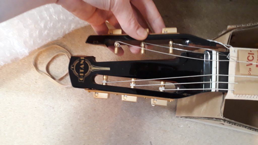

Hi guys. I have the chance to buy a DG 255 for £200! Only problem is that the slotted headstock has split off. It looks like a fairly clean break, I'm thinking that a good glue and clamp will hold it? Does any one have any experience with a break like this?
Thanks

    Make sure all the pieces of wood are there. Even any little chips. Easier to glue the original pieces back in than to try to fit new ones. Should be fixable judging by the picture.

    That's a bad place for a break...gonna want a good pro repair done on that. Gonna cost as much as you're paying for the guitar. Suddenly not as good of a deal.

    @jeffmatz I have got two quotes so far. One for £200-250 and one for £35. Not quite sure how that works out. The more expensive guy is probably the one I trust more with this type of repair...

    I would put some wood glue, and some wood screws and call it a day. It doesn't need to look pretty...just stay in tune and not fall apart!

    Wood glue, clamp, new strings, tuning, enjoy. In that particular order.

    I would buy it and, if it's a clean break, glue and clamp it using cascamite glue and then two short dowels at the ends of the broken section. For 200 quid I think it's not bad.
