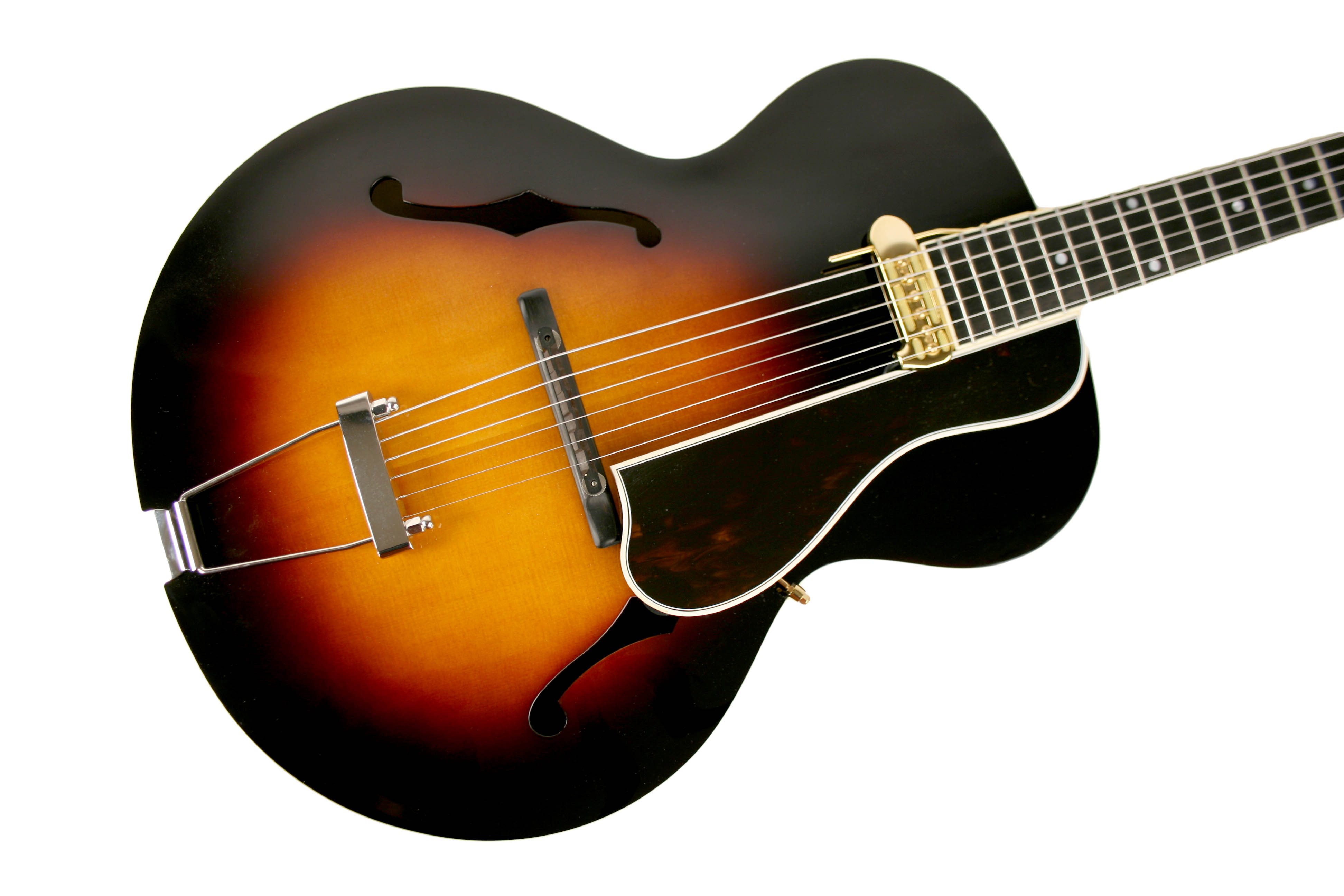

Party Like it's 1939!
imageParty Like it's 1939!
Customized with DeArmond Rhythm Chief, Pickguard, and Thumbwheel Volume Control!

    It's so nice having these DeArmond Rhythm Chief pickup reissues!
    Posts: 248
    This is so cool!
    MichaelHorowitz
    Posts: 461
    I had one installed on my '46 Epi Broadway, and it has pretty much the sound I'd want from that guitar--fat and a bit dark. Interestingly enough, the pickup it replaced is a Rowe-built gold-foil single-coil from the 1960s that I'd had adapted for floating (had its mounting ears cut off). As much as I liked the Rowe, the modern repro sounds better to me. Of course, being 50-ish years younger might help.

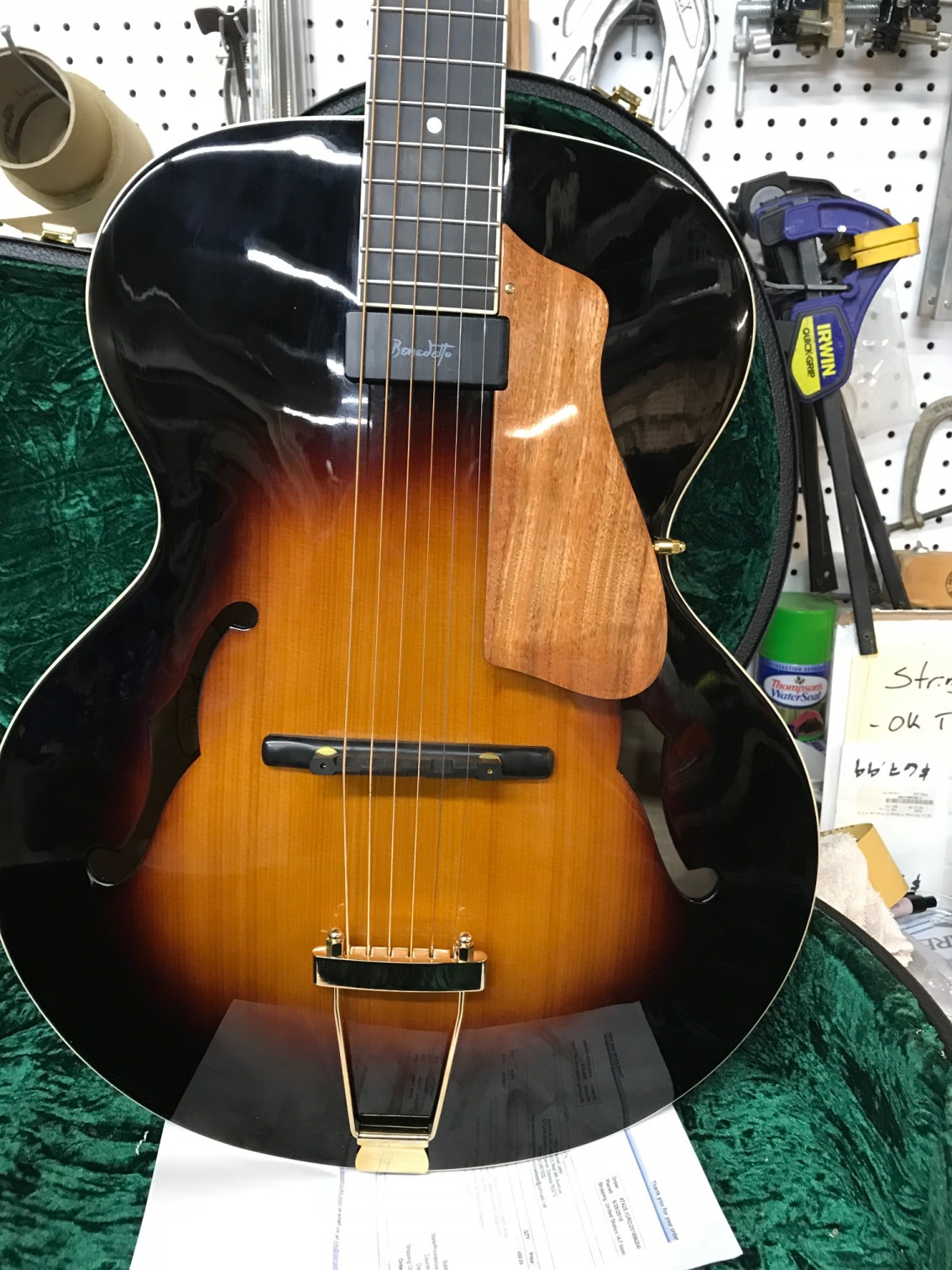

    And here's one with a Benedetto pickup:

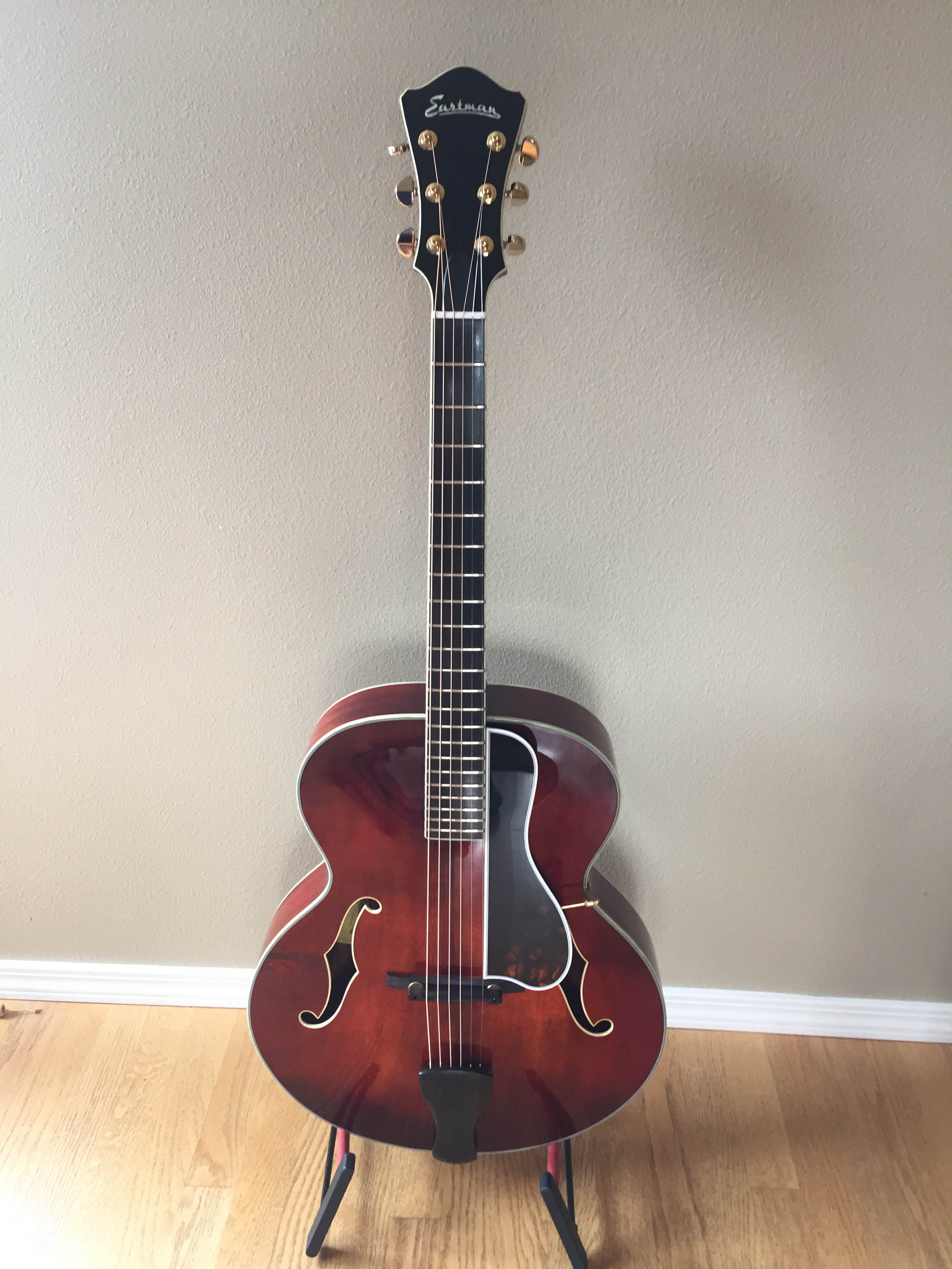

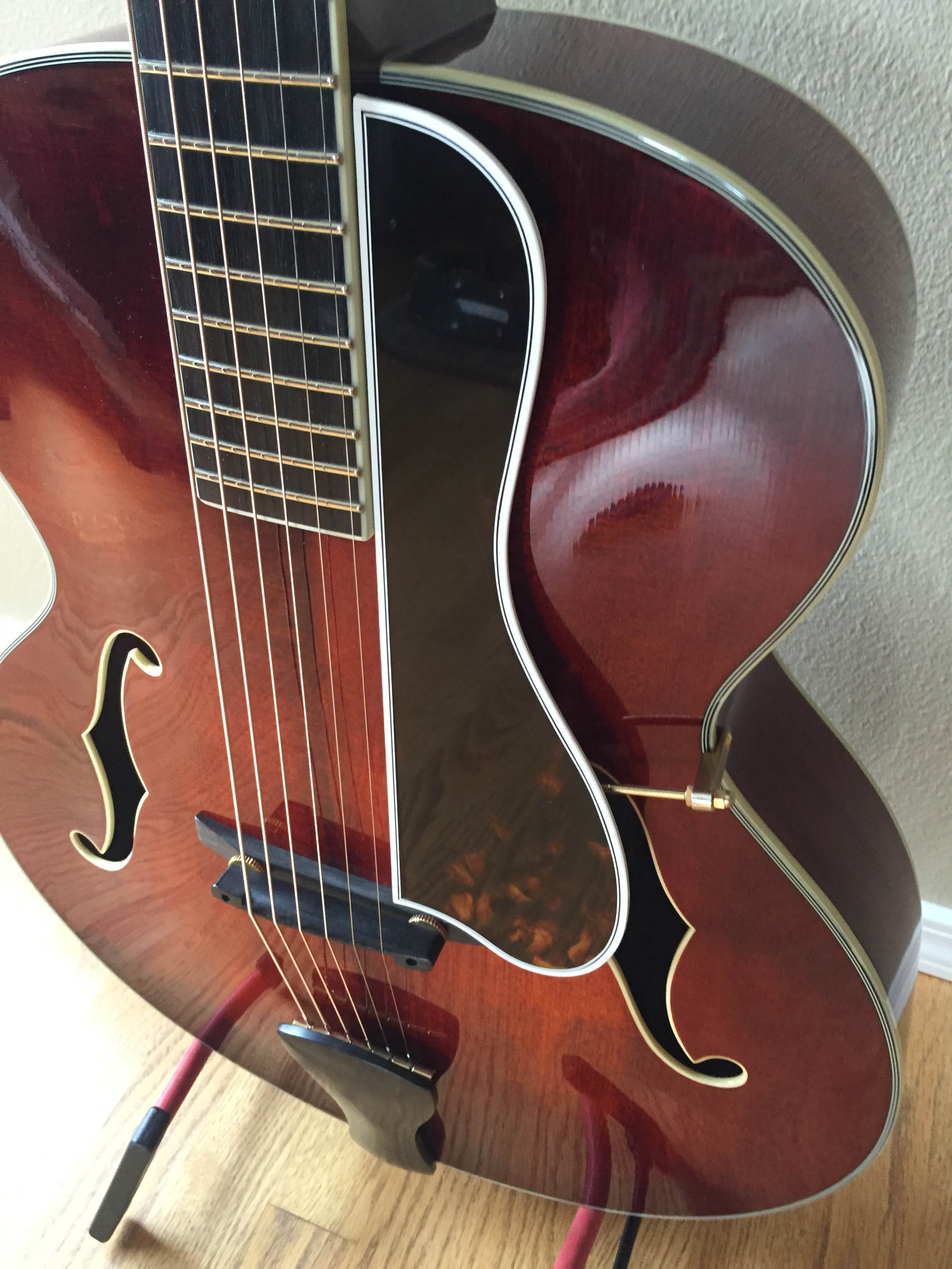

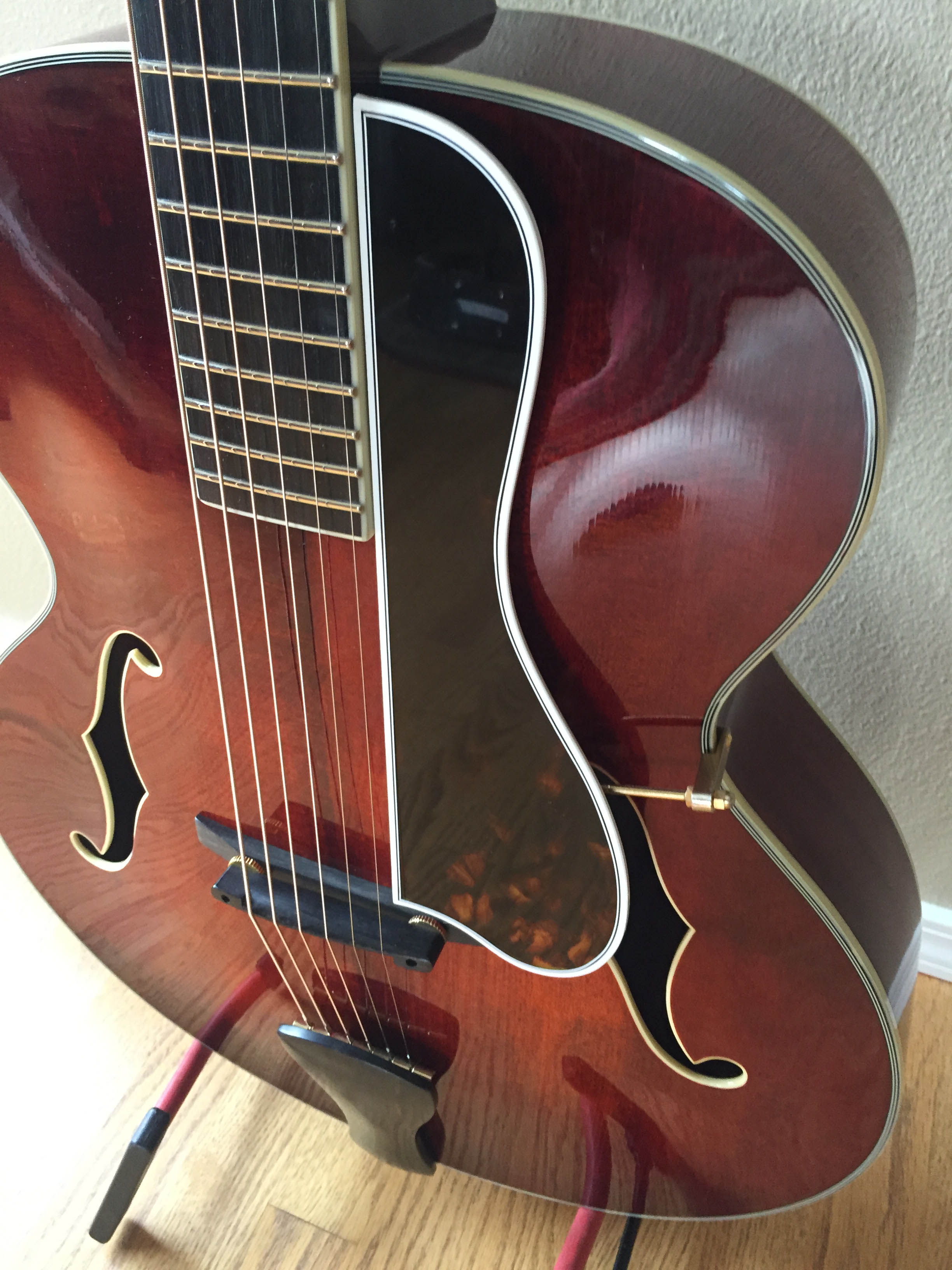

    Here's an AR610 we just added a deluxe pickguard to:

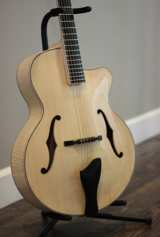

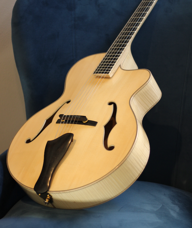

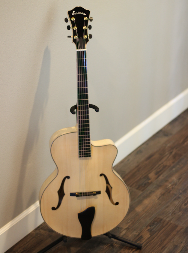

    Here's my new Eastman 905CE-BD that I just received yesterday from Djangobooks. I wanted this model , but as an acoustic archtop (it's acoustic sound is so nice). Thank you Michael for the mods and helping me get it where I wanted it!
    The modifications included: removing the floating pickup and pickguard, installing an internal K&K Pure Archtop piezo pickup wired to the end-pin jack, moving the 9th fret side dot to the 10th fret (I've gotten used to Gypsy guitars and it makes so much sense), and setting it up with Martin Retro Monel 13 gauge strings.
    MichaelHorowitzBillDaCostaWilliamsBucomac63000rudolfochrist
    Posts: 6,288
    Thanks @plaidgadjo !
    This was a fun project and it turned out great....

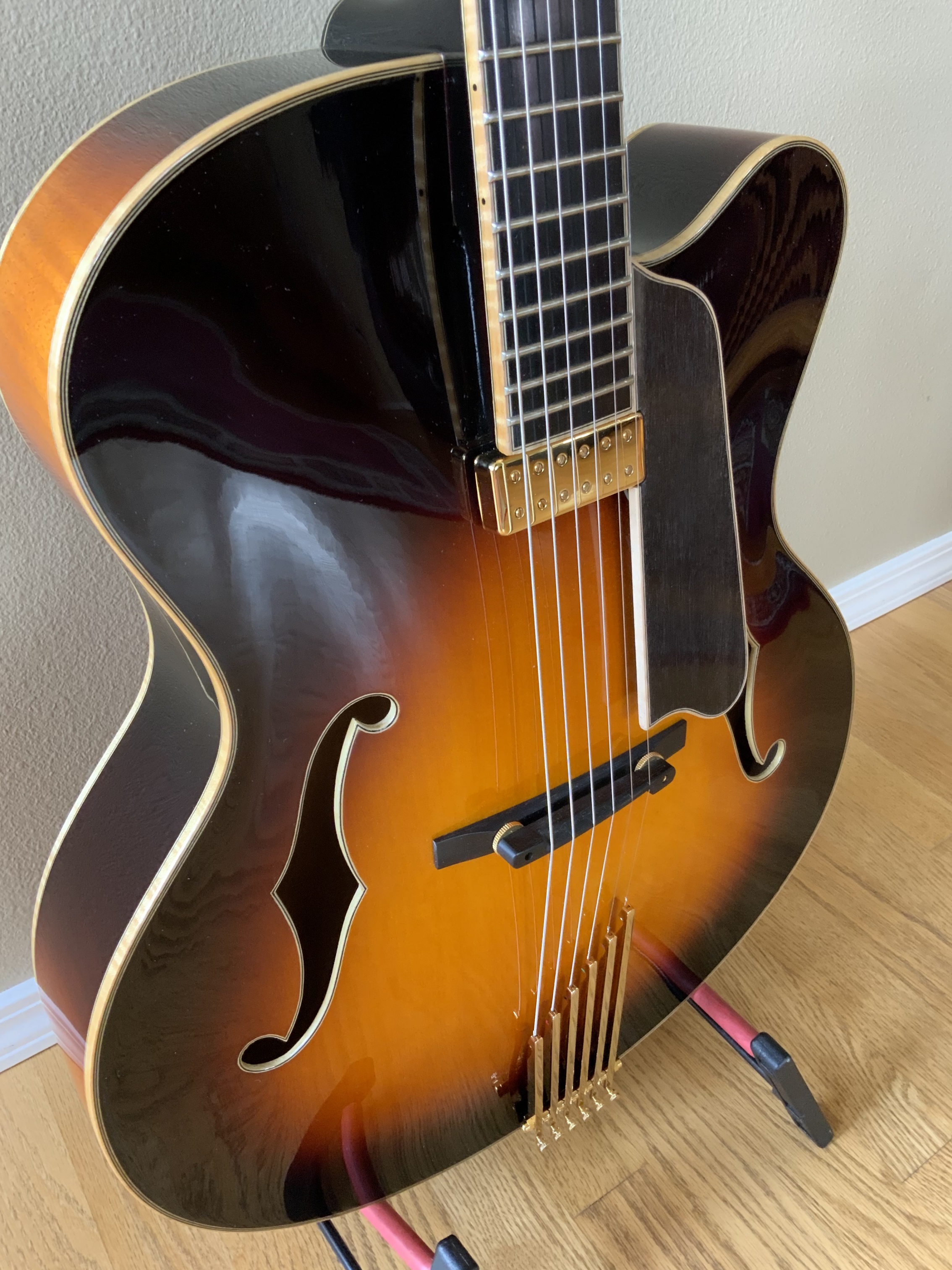

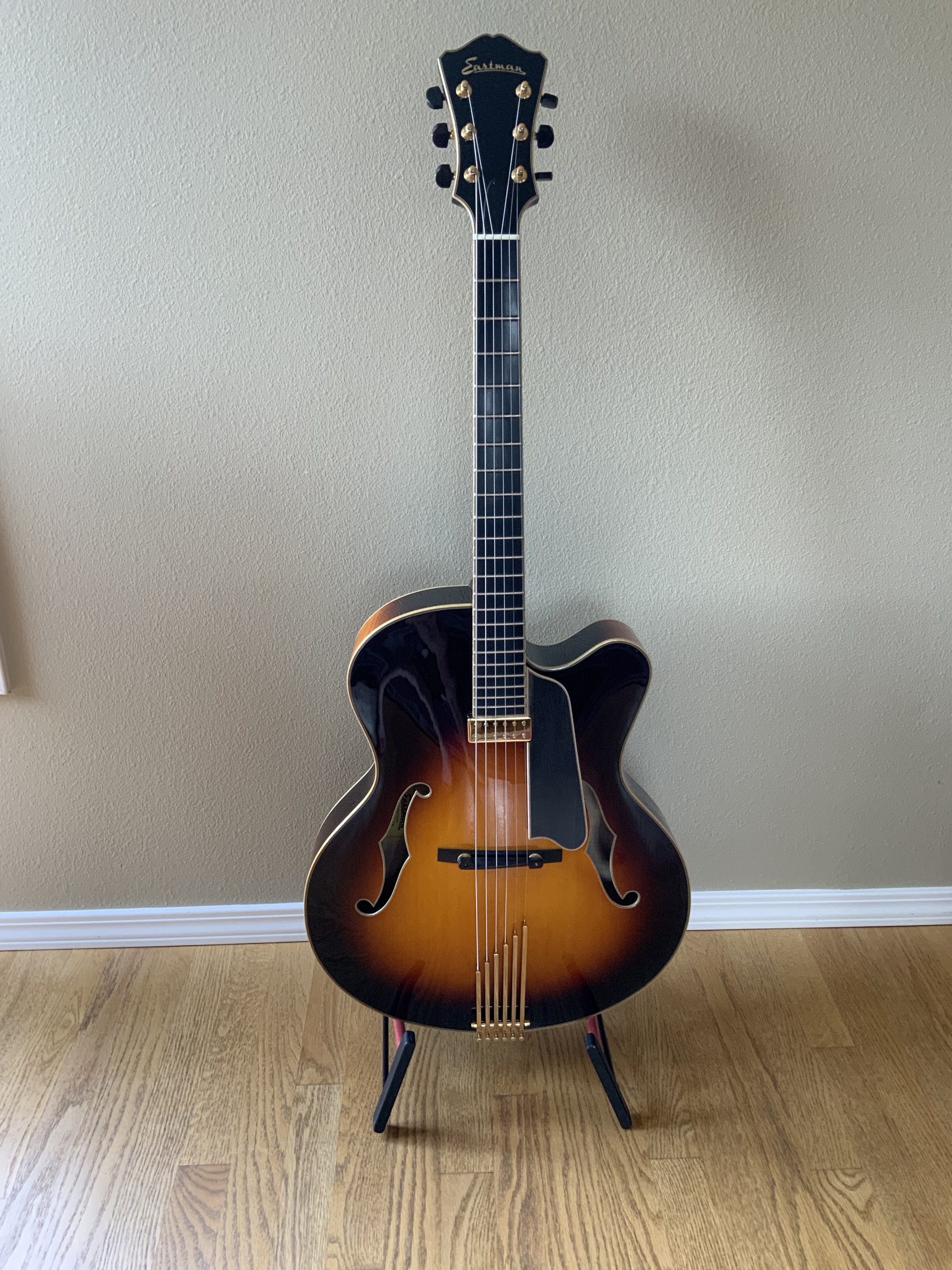

    Here's an AR910CE-SB that we tricked out with a Kent Armstrong Johnny Smith floating pickup and a fingered tailpiece.
