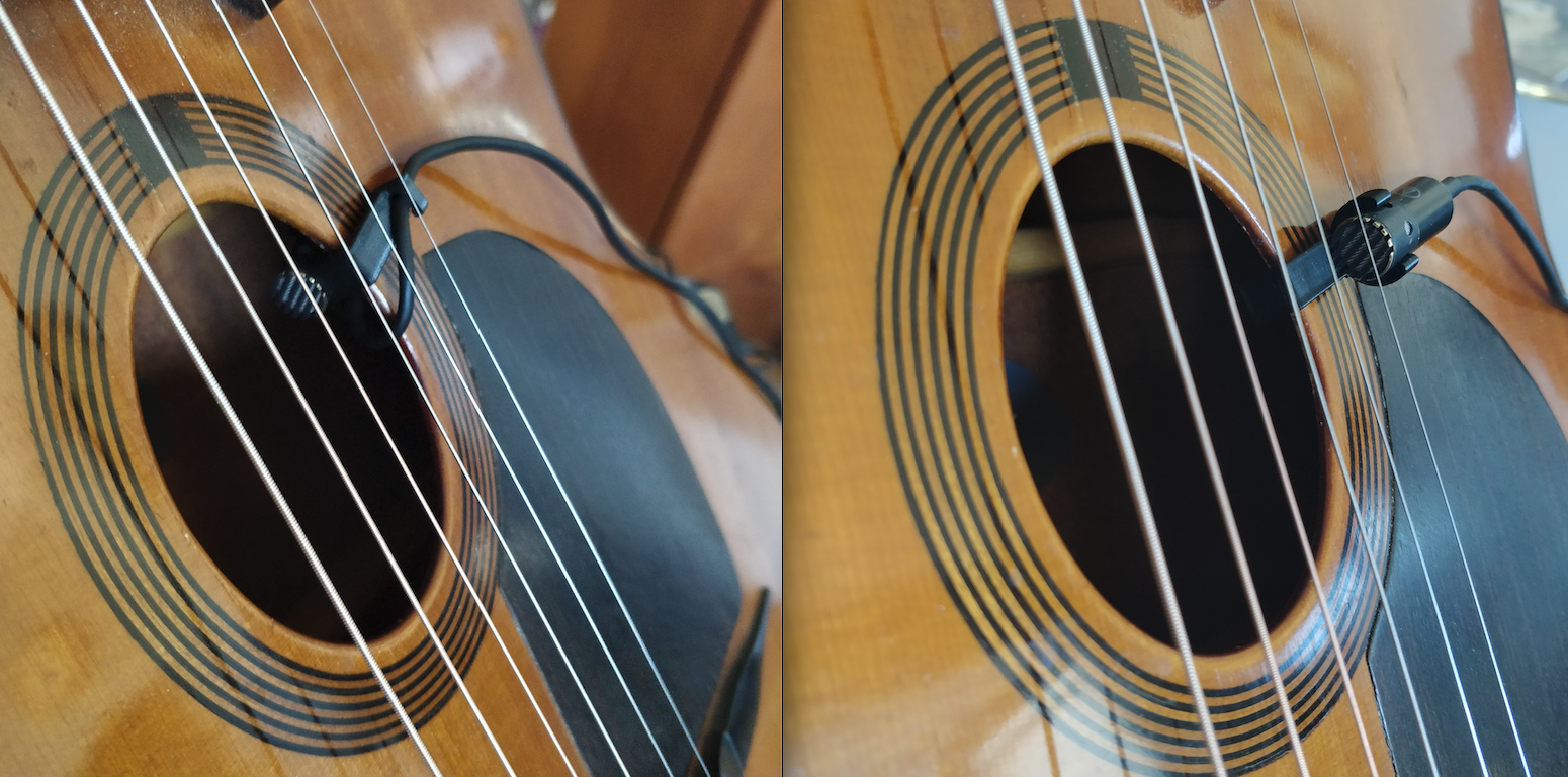

    I'm not sure what Joscho does, but most people find the soundhole clip to be problematic. Since it puts the mic right in front of the sound source, you get proximity effect (i.e. huge bass boost) which leads to a lot feedback. Most people have much more luck with the gooseneck mount which gets mic away from the soundhole and reduces feedback:

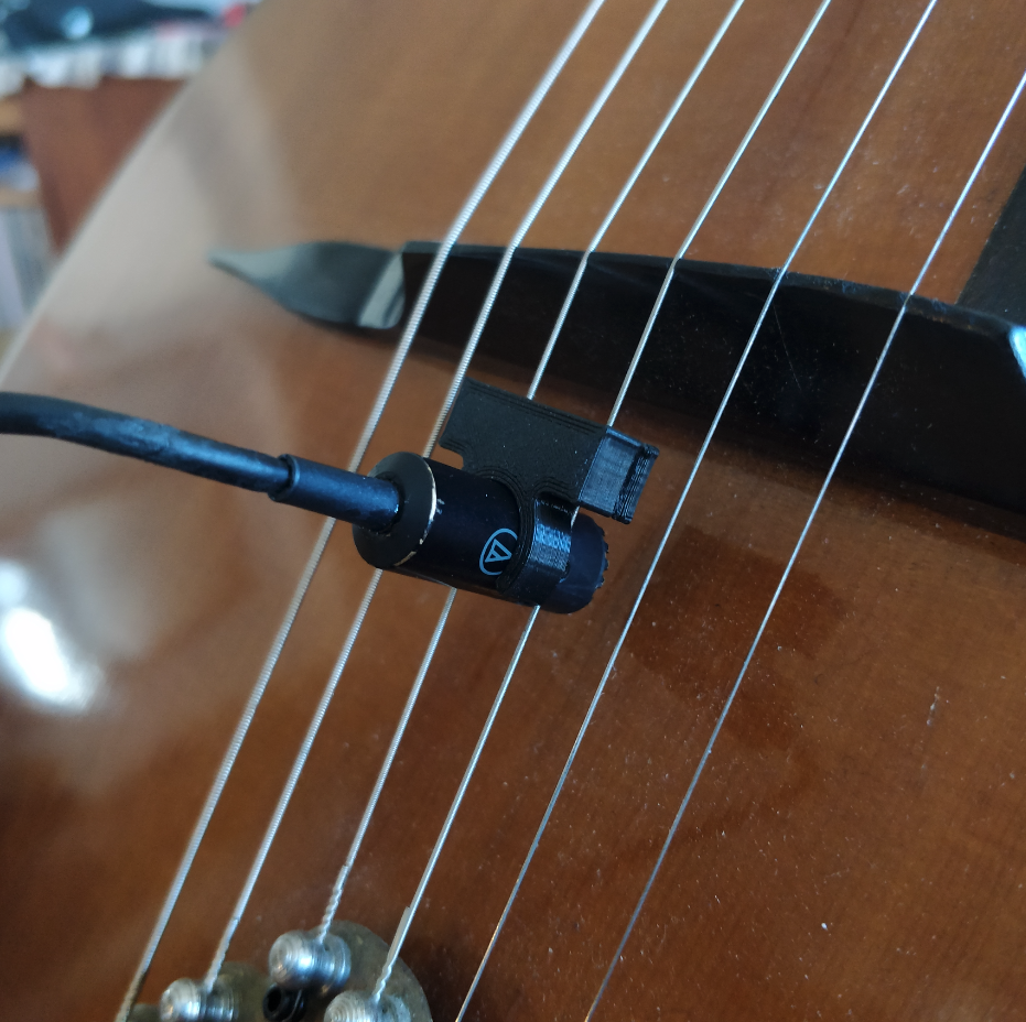

    For oval hole guitars, I find that the best volume/feedback reduction combo is reversing the clip and putting the mic INSIDE the guitar. You can see a lot of professional players doing this.
    For a D hole, I mount it behind the bridge.
    I even designed my own mounts for both these situations. You can 3d print them yourself if you have the means, or I do sell them on my store ( http://www.paniquejazz.com/store )
    I've also experimented with suction-cupping a DPA-style gooseneck mount for these. Honestly, it's not very practical. I found I was getting more feedback than just going with the bridge or soundhole clip. But it depends on the guitar.
    http://paniquejazz.com/blog/project-dpa-style-gooseneck-mount-for-audio-technica-instrument-microphones/
