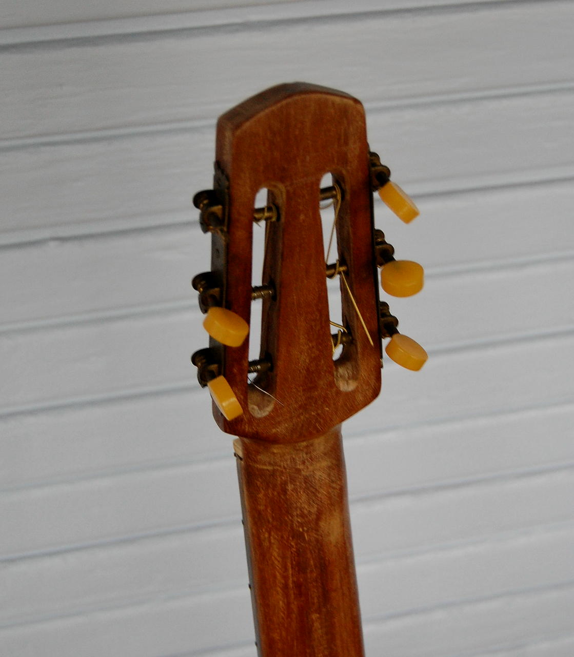

I am fixing up an old Castelluccia which needs a few little repairs. It has the original yellow button Delaruelle tuners which seem to work ok except one has lost the plastic button. Luckily I have some old spares I kept just for such an opportunity but the question is does anyone know how to remove one of the buttons from a scrap set and then fit to the usable one, were they glued on? I am obviously reluctant to use any excessive force, it will just break, but I wondered if there is a known 'trick of the trade'; y'know like submersing in near-boiling water, or leaving it in the freezer overnight?

    Posts: 1,041
    The original Delaruelle tuners are not like you describe. They are all brass and the shaft where the button fits is a straight square section with no barbs. The buttons appear to be made from a phenolic resin similar to Bakelite which would make sense as they were standard fitment on a lot of old guitars before modern plastics were available. However, I have several old part sets I have kept for spare parts so I will experiment with the soldering iron to heat the shaft and see if that softens one enough to pull it off in one piece, then try to find an adhesive that works with phenolic, probably a urea formaldehide type.
    As the gears and shafts are made of brass of course they do not wear very well over the years but I thought I would try for the sake of originality to make one good set from the best parts, but I suspect I may still eventually replace them with a spare set of the Selmer style covered Schaller Deluxe tuners I have here anyway.
