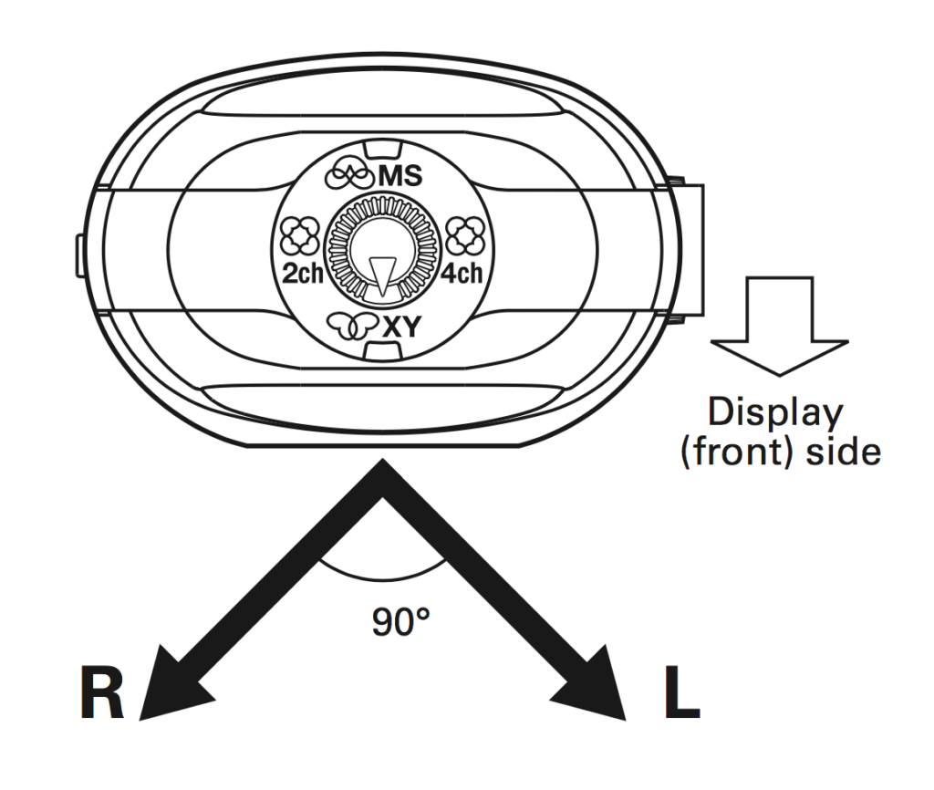

    @Buco - stereo 90deg setting for each, rejects side sounds great, even when sitting close together.
    These H2N recorders are cheap ($169 on Amazon), and are flexible.

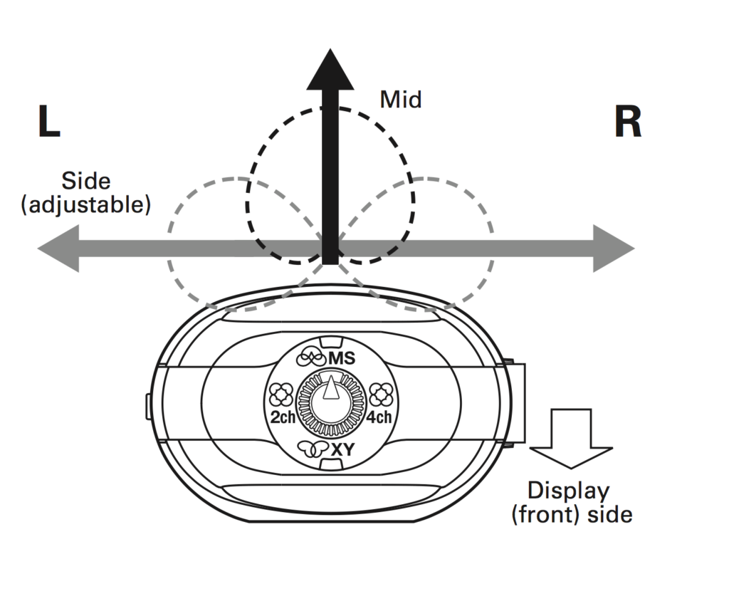

    The above mic settings are one side of the device, and the opposite side can record side/mid combinations simultaneously.
