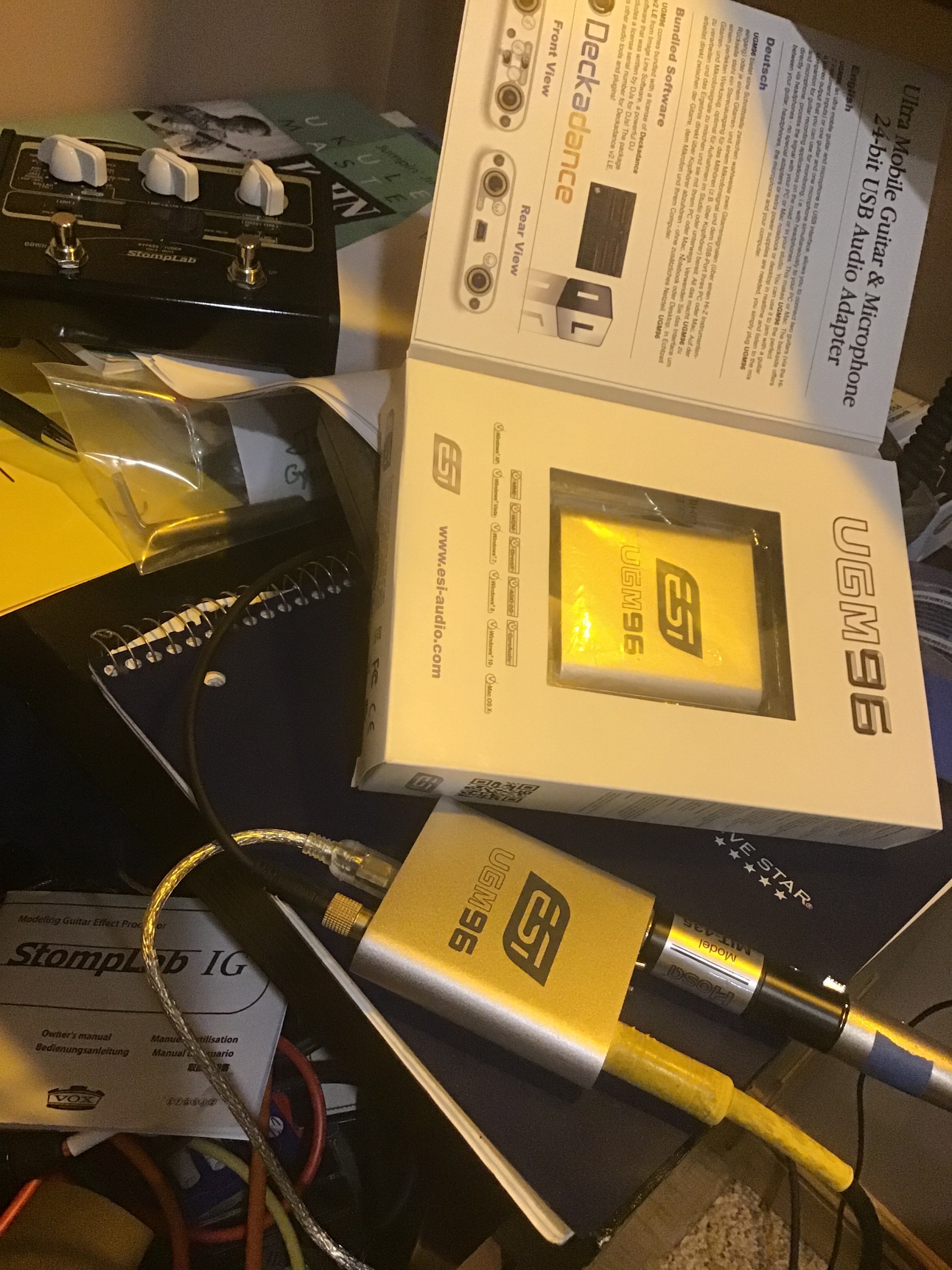

    This is largely correct but a little off. It’s correct that the total latency of the jam is a function of everyone’s individual latency so even if you’re super low, if you buddy is not it’s not going to work. You need fast internet, that’s available to most of us now (I have between 5-10Mbps upload). You need an Ethernet cable connection (not WiFi). The closer your jam mates are to you the better; JK recommends less than 500 miles. You need an interface with a fast driver, this excludes plug and play hardware like the Yeti. I started with my RME FF800, which was a $1600 piece of gear when it was new (around 12 years ago), and it gave me around 7 milliseconds latency. As sound travels roughly 1.1 foot per ms, that would be like being around 8 feet from someone. There is a page on the Jamkazam users group where someone complied a list the the gear everyone is using, much of it includes reported latencies. Someone reported 2.7 ms from a cheap interface I never heard of, the ESI UGM 96 so I bought two on a whim, about $70 apiece (one for my friend). I am using that now with a 10 year old HP laptop and have a reported latency of 4ms. I have a student I teach weekly over JK, and have had successful jam with musicians from my hometown (Milwaukee) and oddly as far away as Kansas City and once even California.
    You can use JK with audio software but you don’t need to. I’ve done it with Reaper to use plugins, but now I jut use the JK program. I play guitar, bass, and sing so if I’m playing bass I run the headphone out of my amp into the interface; for electric guitar I use a Vox Stomplab for amp emulation before the interface (BTW this sounds good through the Compact 60); for acoustic guitar an vocals I just use a condenser mic, no effects.
    My buddy has slow DSL and I guess decided that JK wouldn’t work for him so I have an extra interface sitting here, never opened, I’d sell it for $60 (what they seem to be going for now)
