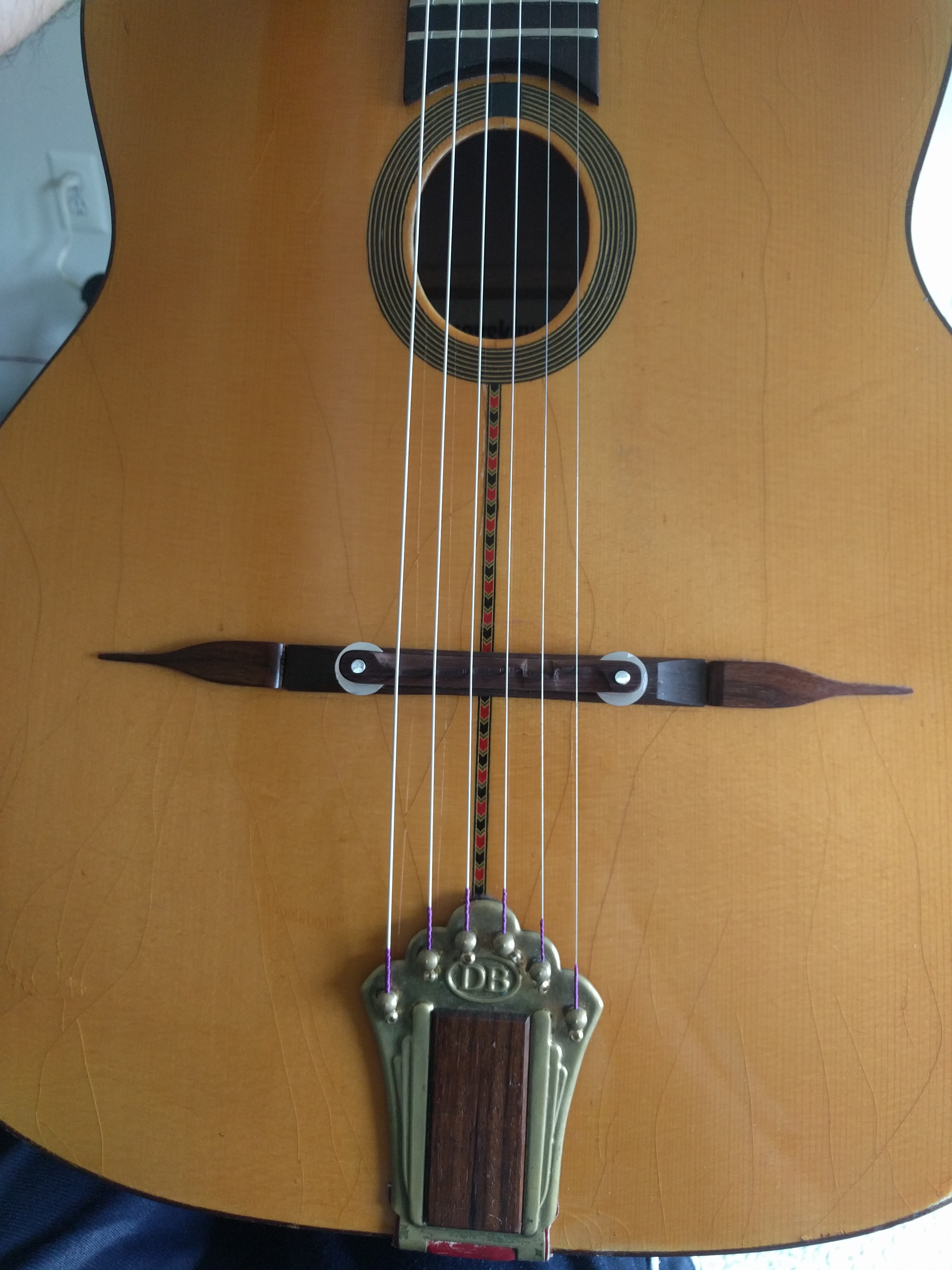

Hello all... last time I tried to remove poly off of a guitar top I used a sander and didn't do a great job. I was wondering if anyone had any advice about using some kind of stripper to chemically remove most of it and maybe just finish it off with a little bit of sanding. I'm looking to brighten up a cheap Asian gypsy guitar with the hope of achieving a little bit more volume with a more natural finish. Thanks - Dean

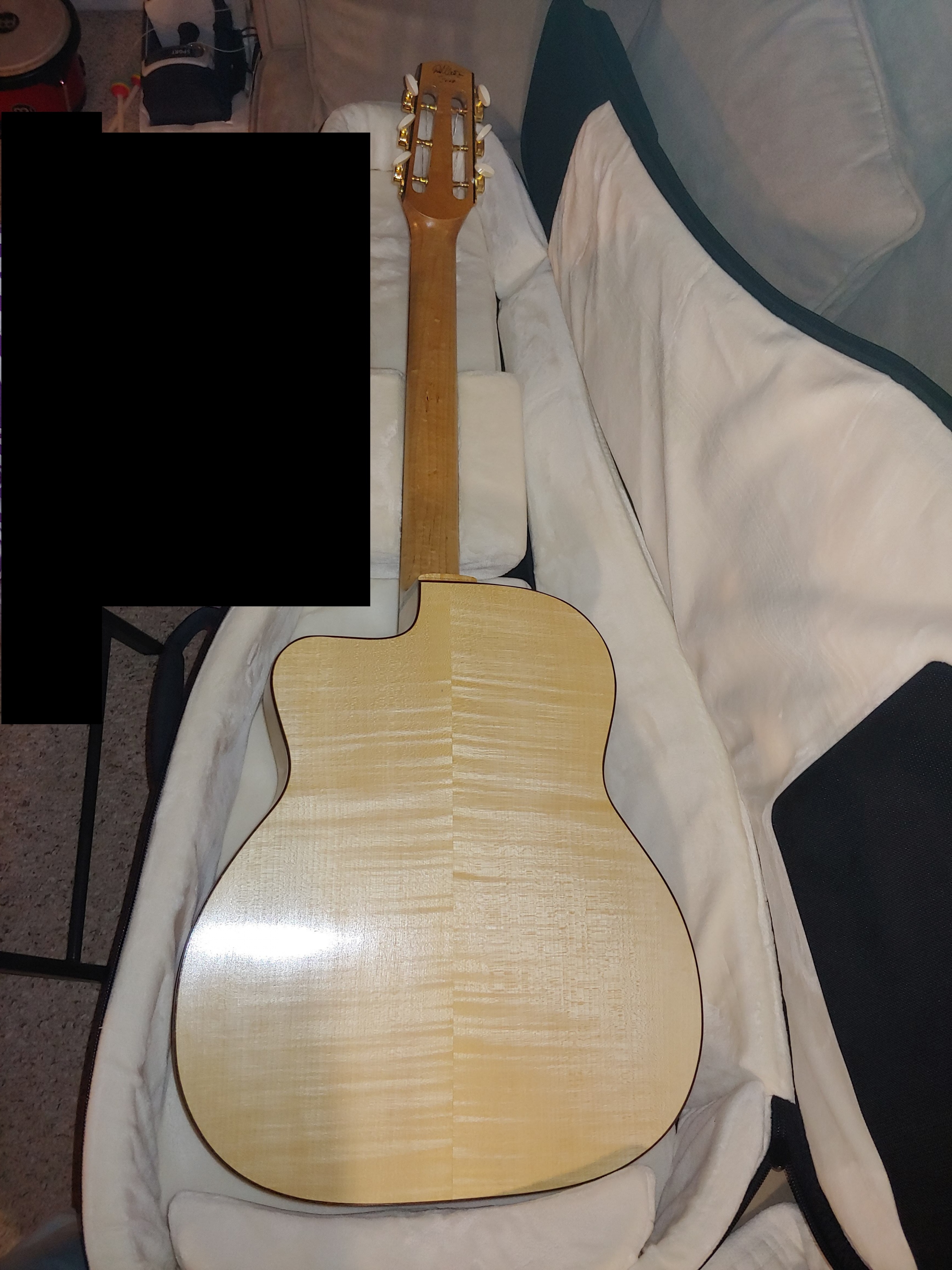

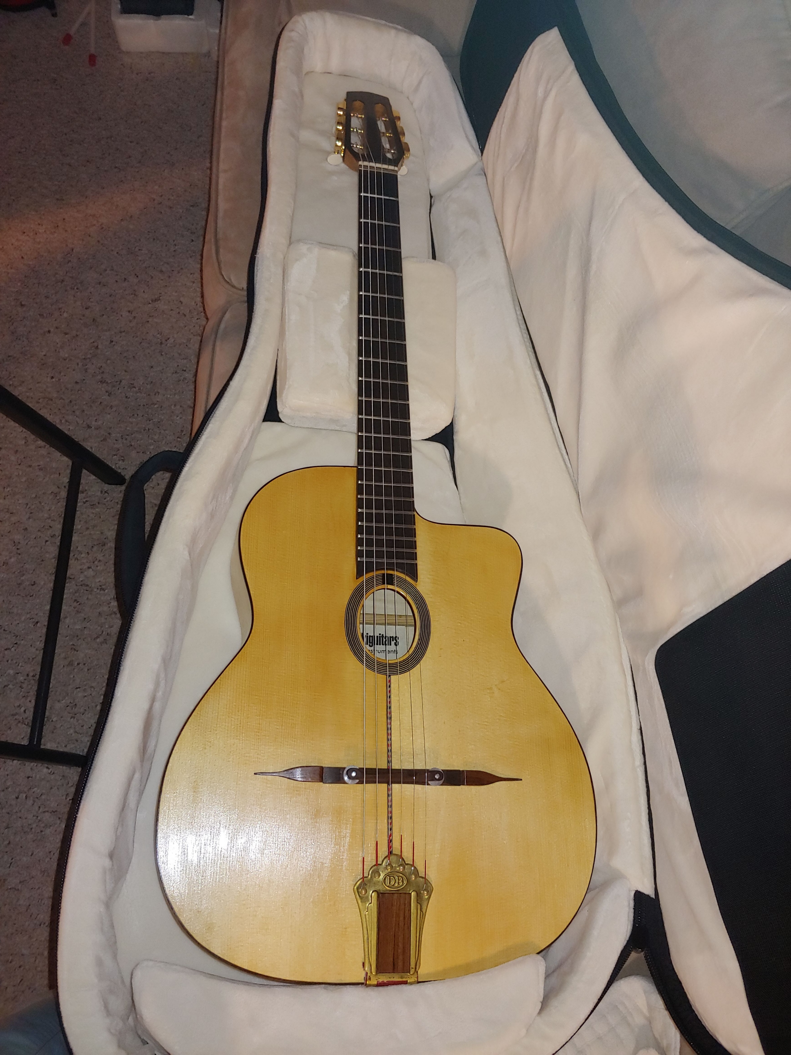

    All hand scrubbed. Long project, at least 40 maybe 60 hours all told. Wasn't a pain though. I didn't have space to mess with chemicals. But also Craig B talked me out of it.

    I used heavy rubber blocks that car body shops use to sand. Only the top coat when I was using grit 80 or could've been 120. Then as I saw it thinning I'd switch to wrapping the higher grit (I'd need to check on what exactly I used as I went along) sand paper to those soft sanding blocks. For hard to reach areas I used a rectangular shaped pencil eraser which was great because it was firm enough to where you can push on it if needed but soft enough to conform to the shape of the guitar.
    The guitar always sounded good to me and it's extremely well built instrument. But with this light oil finish it's breathing a whole new life. Everybody who was familiar with it before said "wow!" after hearing it. Same tone is there but louder, wider, bigger, deeper. A friend who has Dupont and Holo when we jammed in late Feb commented "holy sh!t that's loud". Yeah, I could not be happier.
    I probably would've never taken the project if it didn't have a bunch of these spider web cracks in the top lacquer which happened on the delivery day in Jan of 2009 when Chicago had one of coldest days ever recorded with wind chill factor of -40. And that bothered me but everybody was telling me like oh that adds to the character and similar. I could never make my peace with it. I've been thinking about doing it for years but every time I'd try to "learn" from the internet I'd get put off because dozens of various forum posts (not here, general guitar forums) would claim you should use chemical strippers because otherwise you'll damage the wood, at the same time dozens would claim just the opposite. They usually sounded like they really know the stuff they're talking about. It was only after Craig told me (thank you @Craig Bumgarner ) he only and always does it by hand that I said OK this is what I'll do and went to work.
