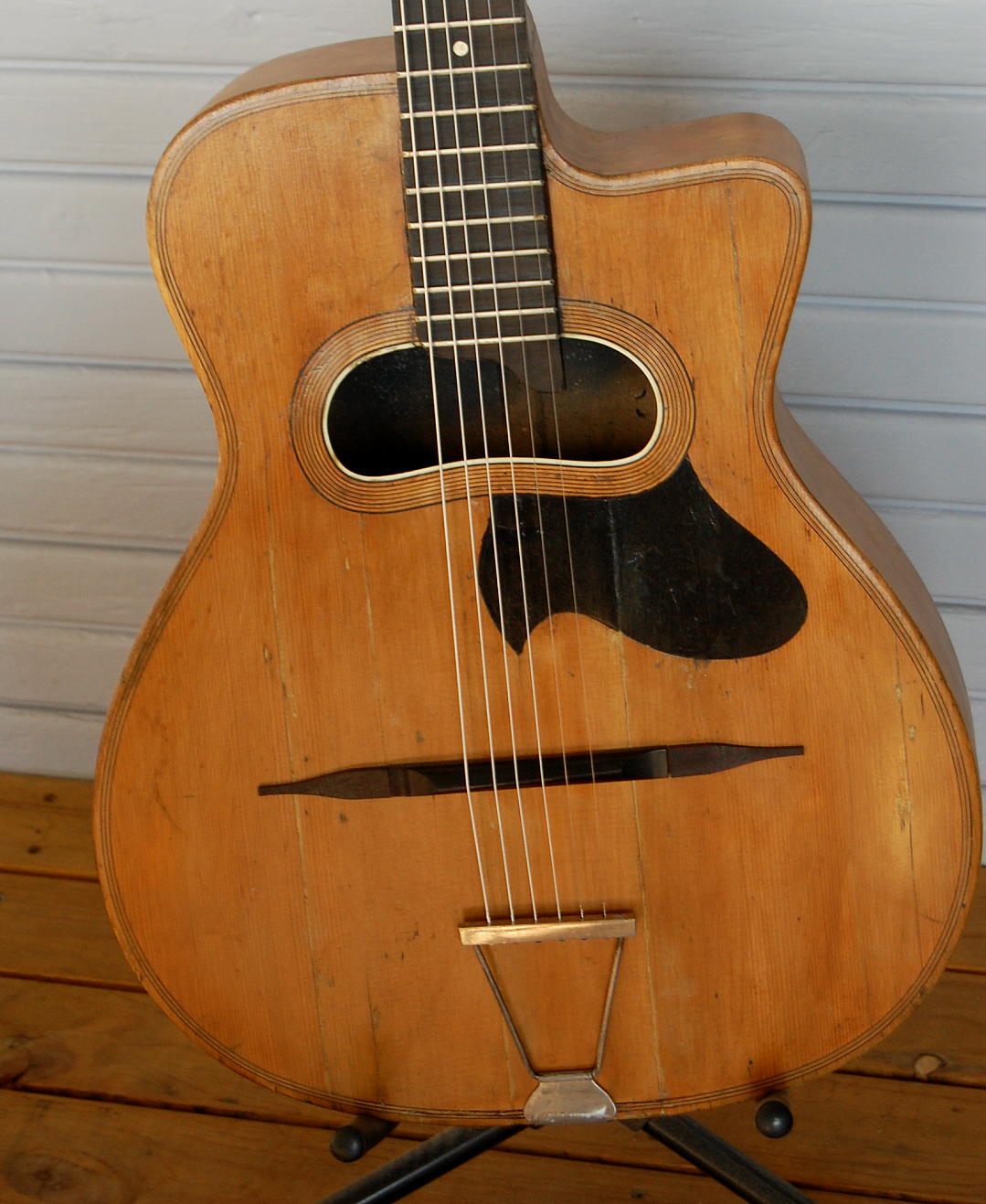

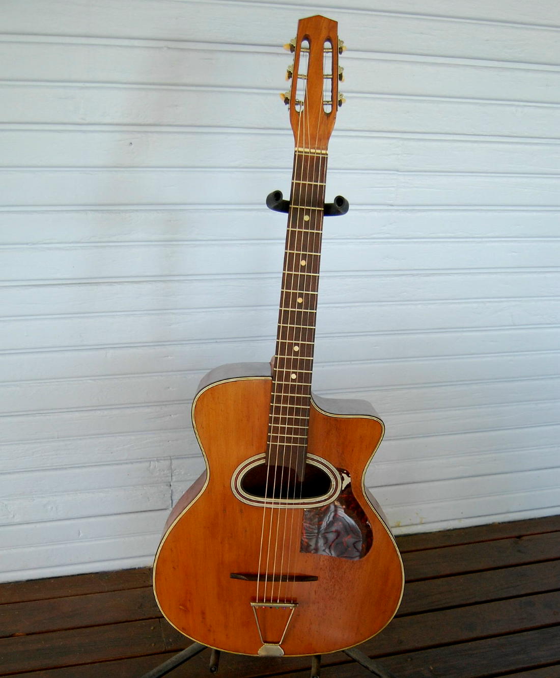

    Trapeze style should work well. Many of the old luthers used them on GJ guitars, very common on Di Mauros (as below) and some of the Mirecourt guitars; Henri Miller, Patenotte etc (see my Patenotte below). They are usually hinged at the bottom so no worries about the break angle, it will set itself according to the bridge height. Brands should not matter, there are many available online, chrome or gold but depending on the distance between the bridge and the bottom edge you might want to go for a shorter length one. Search online images of those mentioned above and you will see what I mean, they are usually not as long as on full-size archtops.
    Of the other replacements GJ style, like Dell Arte, yes, as Bones says they are usually flat from new and you have to make the bend yourself, but that is not hard to work out; likewise filling old screw holes that don't line up with the new one is easy as there should be a substantial tail block inside that area.
