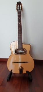

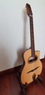

  • apache26apache26 New
    Posts: 4
    Today the guitar has arrived and as I imagined the strings, at least for my way of playing, are too high.
    I have to see how to lower them. In these cases it should intervene on the bridge but maybe I prefer to replace it
    with an adjustable one.
    Some advice?
    edited October 2020 Posts: 1,691
    Uh-oh, it looks like you got sent a M01DT (thin body) 😬
    apache26
    Posts: 1,909
    Either that or somebody pulled the old Flat Stanley trick!
    Posts: 542
    Assuming that the neck relief is correct, yes, you would have to take some off the bottom of the bridge or buy another lower bridge. If you want to lower the action by let’s say 2 mm at the 12th fret, you’d need a bridge 4 mm shorter (i.e. twice the height difference less). Do NOT put an adjustable bridge on a Gypsy Jazz guitar. But I have to admit I have no experience with a thin body selmer type - perhaps this is more electro-acoustic and it mightn’t affect the sound so much.
