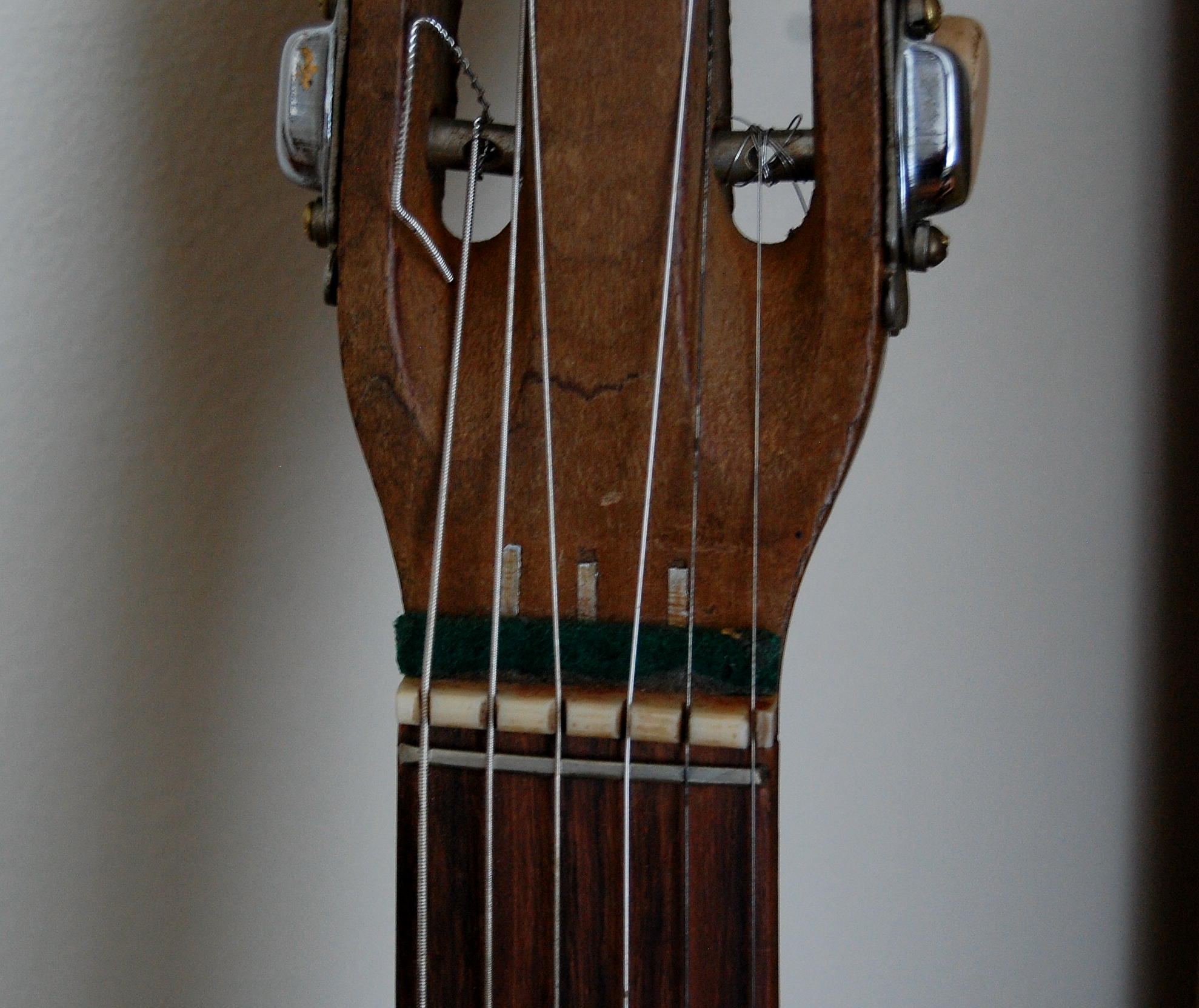

    Many refer to truss rods as in the modern adjustable type, but some old guitars had fixed rods of varying materials added for stiffness. It is not hard to add either a straight rod or two, or an adjustable one if desired. Using aluminum in the past, or more often these days, carbon fiber, certainly will not add any noticeable weight. In many cases it may not be obvious if there is a rod of another material inside a guitar neck unless it can be X-rayed. On the other hand many old school luthiers knew how to work wood correctly, and depending on the timber used and especially the grain could make a neck that has lasted down the years without any need for additional stiffening.. Then there is the laminate type as used by Favino where a sandwich of timbers with opposing grain patterns would be far more stiff and stable than a one-piece neck, (usually Favinos had five pieces of maple/rosewood/maple/rosewood/maple).
    I have an old Di Mauro that had three thin aluminum strips added some time in the past but I have also routed and glued carbon fiber rods in others. Normally if the neck is otherwise good and it is all clamped straight while the glue is setting it will stay straight. As these are not adjustable you can add some neck relief by shimming between the fingerboard and a straight edge but whatever you do at that stage will be permanent. If you do not want to risk that, then yes, adjustable is the way to go.

    The only way I know there are three thin aluminum rods in the neck of this Di Mauro is because the ends are visible extending a short way above the nut.
