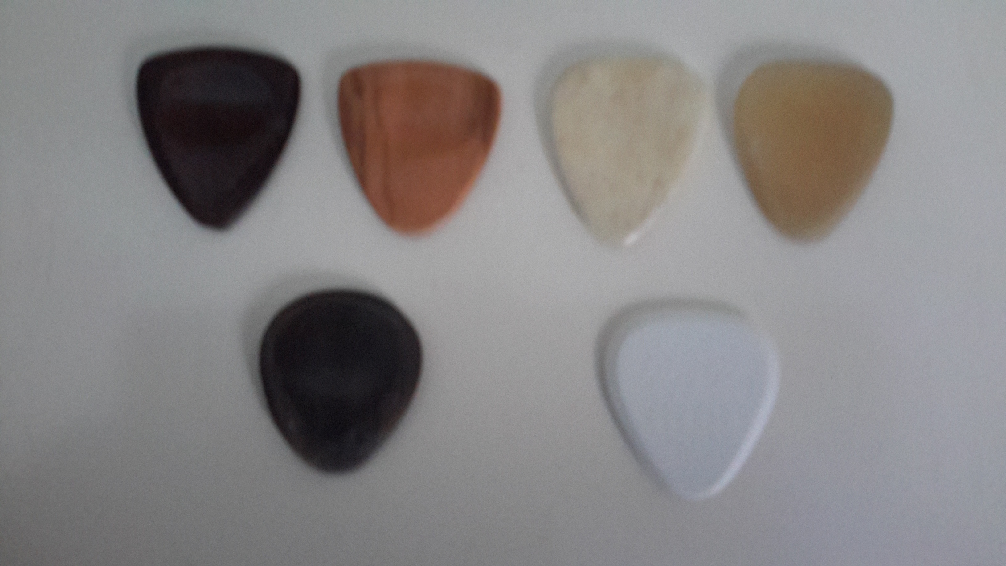

    Hello Twang and everybody else here,
    the "pickposts" made me grab my nail file and begin to work on picks I didn't really like to play with.
    Upper row left: Ortega wooden picks before and after shaping, right Dugain. Much more sound after work! .
    Below: my good old "can't-remember-which-brand-pick" (mahagoni, my favourite darker and more robust sound, didn't need to work on it) and Chicken Pick (no result: same thin and plinky sound before and after shaping).
    I will continue and try to remove even more mass. I didn't dare to do that shaping job before reading your posts, thank you all for the inspiration.
