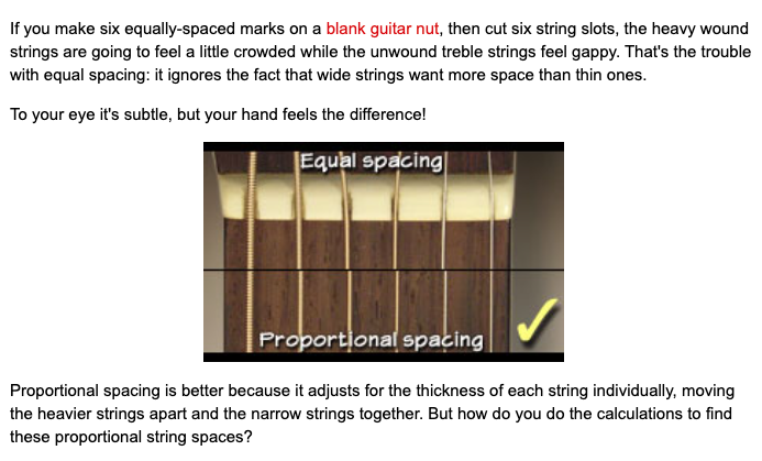

What's the standard string spacing at the nut?
  • Would anyone recommend something along these lines: (?)
(this is from a StewMac page)

    The widely-available Selmer 807 plan shows a width of 46mm at the nut. 1.75" nut width is common on many steel-string guitars and that is 44.45mm. Somewhere around 44 or 45 is more comfortable for me so I do that. The whole point of building your own is to do what you want and like. Proportional spacing is definitely the way to go. A good player will usually feel poor string spacing quite quickly. The nut/bridge spacing ruler from Stew Mac is a bit expensive, but is one of the best time-saving, quality-improving tools I ever bought.

    The "standard" spacing IS even spacing (or very close to even spacing) between outside "edges" of the strings. IMO even spacing between string centers is really just poor thinking/design/workmanship. It generally feels really crowded on the bass side of things. Of course there is no accounting for taste and the various odd things that people might get used to.

    I make the empty space between each string the same. I guess that is what Stew mac calls Proportional. That is pretty typical I don't really think anyone does it by just marking the equal distance on the nut and then cutting the slots.
    You take the neck width at the nut, subtract the spacing from the edge of the fingerboard/nut to the OUTSIDE EDGE of the low and high E strings, then subtract the diameters of all the strings. Then divide that result by 5 (for a 6 string guitar). The result is the spacing between all adjacent strings. The spacing BETWEEN each pair of adjacent strings is the same. I hope that is clear it's a bit hard to explain. I think it is easy to confuse the term "equal spacing". That means the distance from the CENTER of each string is the same. THAT IS NOT RIGHT. I think what Stew mac is calling "proportional spacing" means the distance between each adjacent pair of strings is equal, which is the "correct" way to do it.
