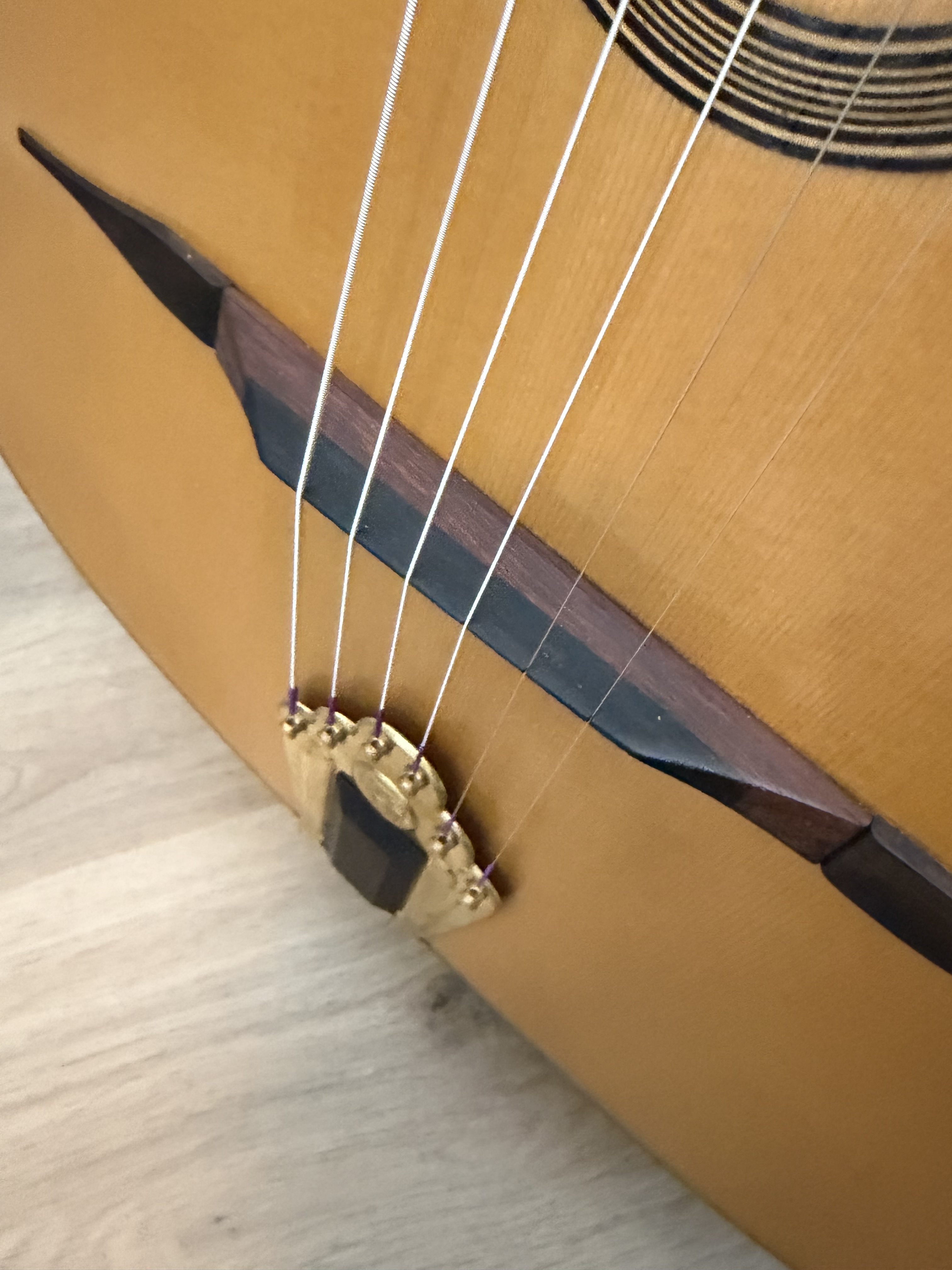

  • jmanjman New
    edited September 21 Posts: 27
    My Vit Cach guitar has a two piece bridge. It's rosewood with a strip of ebony along the top edge that contacts with the strings. I think it's a fantastic solution. None of the problems with string crushing the slots and all the weight advantages of rosewood.
    edit: added image
    billyshakesBucowim
  • Posts: 27
    Many thanks for your replies. I would possibly make the bridge from scratch. A good idea to have the ebony top.
