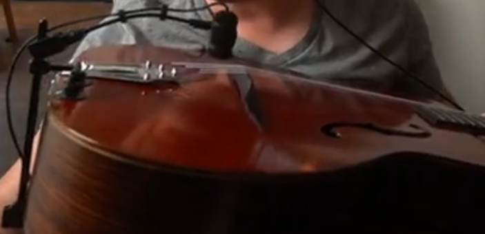

    I use a AT8418 Gooseneck mount, and a guitar suction cup mount to position the mic just behind the bridge. It has a pretty balanced tone (still make sure the bass rolled off though), and is the most resistant to feedback.

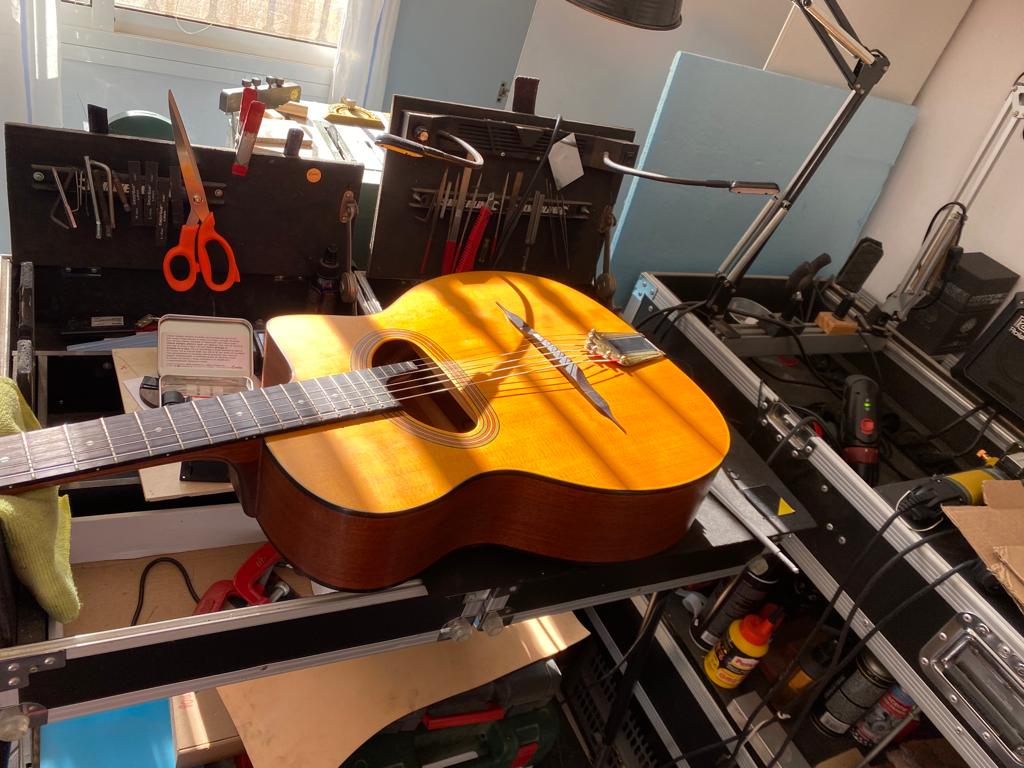

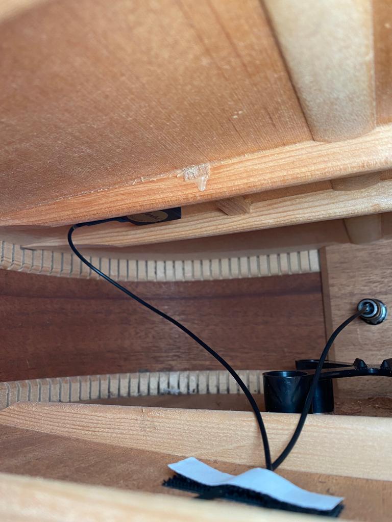

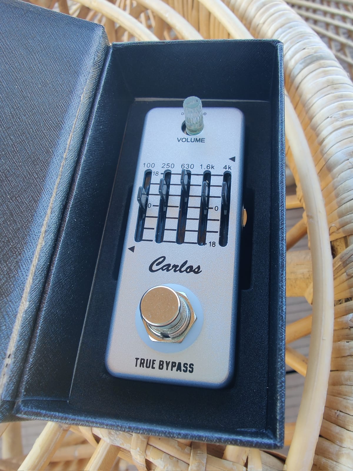

    So I just came back from Carlos' place. He was really nice, and did such a great job finding my guitar's sweetspot and installing the CS sensor. I opted for the 'CS "Stochelo" Set', which includes the limited "Carlos 5 band EQ pedal". I'm sure the "VIP DM", which includes a microphone placed inside as well, would sound great. But I'm extremely pleased with the "Stochelo" set.
    As I said, I am incredibly pleased with the sound – especially in tandem with his EQ pedal. I will upload a demo as soon as possible. I am planning to try blending it with my AT831b (Still really interested in that guitar suction mount of yours Christophe 🧐).
    I know my Cigano GJ-15 isn't particularly expensive, but I love how it plays and I'm very pleased with it. With the system I have now, it's a very reliable and great sounding gig guitar.
    Here are some photos of today's guitar excursion:

    Finally, though you didn't ask, some friendly advice on EQ in general: take away, don't add. Artificially boosting can actually cause more problems (i.e. feedback) than increasing total volume. So I'd practically kill (take to -18db) that 100hz band, slightly lower all others, but leave 630hz at 0db to achieve a similar curve. Then, just use the volume knob to boost your signal.

    Our member @V-dub has a mic attachment solution (not sure if it's worth the shipping cost), go about 1/3 of page down
