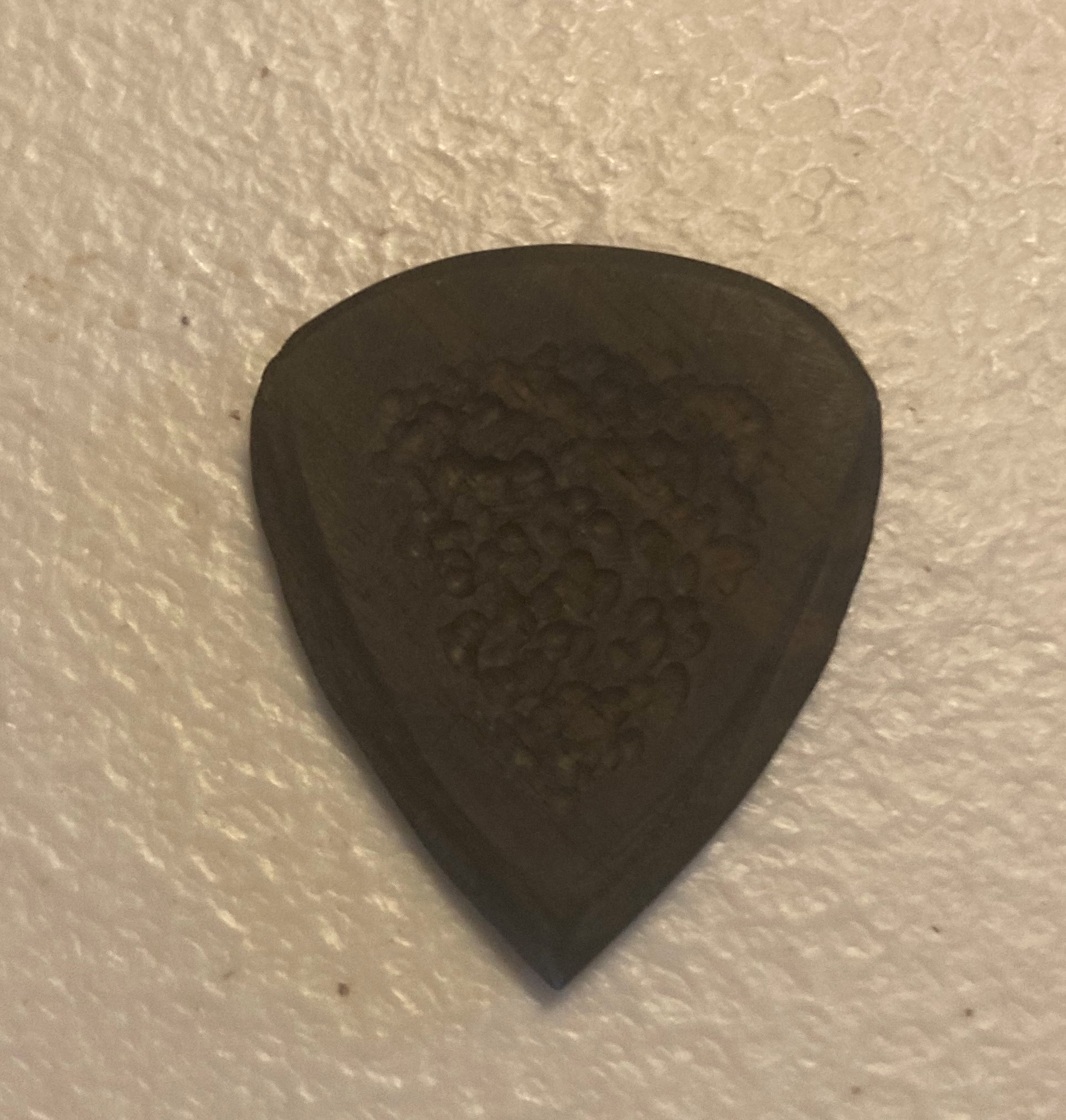

    I made one out of ebony. I cut a 3mm strip out of a small ebony board with a band saw. It's pricey stuff but I had some scrap lying around. I think there are cheaper hardwoods that would work. You could use a table saw for that part or even a jig saw or hand saw if you're patient. Then I traced the shape of another pick on the 3mm strip and cut it out with a scroll saw (band saw or jig saw or coping saw would work) and then I used a dremel for the bevels. I used the little sanding cylinders with the coarsest grit (60 I think) - they come in the set if you get the dremel with accessories. I use the "pen" attachment for the dremel, which also comes with the set, so I can hold it like a pencil. I also dished out the inside with a little steel dremel cutter and roughed up the pick so it doesn't slip.
    My first one was too sharp of a point - I made it before I found the joy of dull tipped picks. My daughter says it smells like beef jerky. That's what ebony smells like I guess.
    I'm going to try making an epoxy mold next out of silicone, so I can make exact copies of my favorite 3mm dunlop pick. Lotta time on my hands.... Covid...
    I don't even know if wood or epoxy are acceptable pick materials but from what i've seen online (bone?) it looks like anything goes.
    sorry about the ginormous picture - I don't know how to make it smaller!
