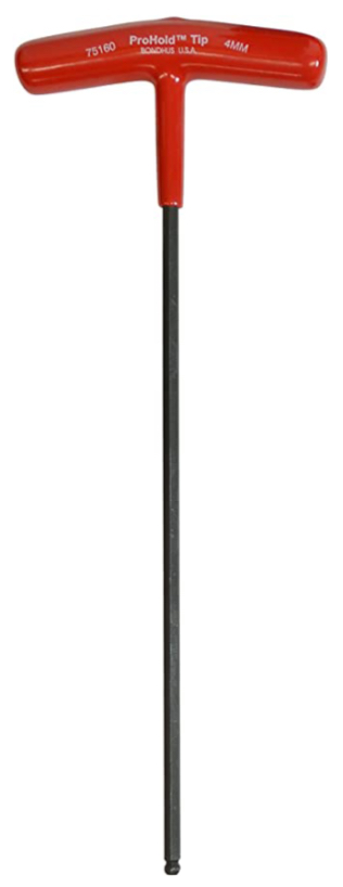

I need to do some setup tweaks on an unbranded O-hole. The truss rod requires a 4mm allen ball-head wrench, and is adjustable through the oval soundhole. Distance from the northern top of the O-hole to the truss rod nut is 6”. No possible way can I get my gorilla-hand inside the soundhole, so I need something like an 8” 4mm angled wrench, or (possibly better) a 7 1/2” - 8” allen key that affixes to a fine-toothed ratchet.

    Solved:
    This worked perfectly, got it on Amazon. From the ball tip to the T handle is just over 8”, and the T of the handle is fairly small and lands close to the center of the O-hole.
    Bondhus 75160 4mm ProHold Tip Ball End T-Handle w/ProGuard Finish, 220mm
