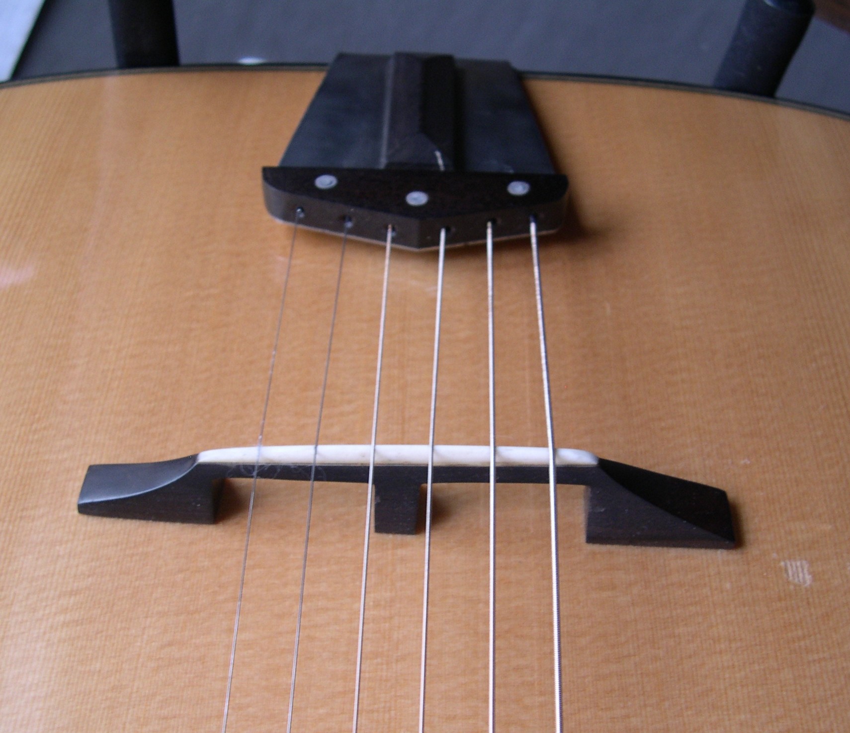

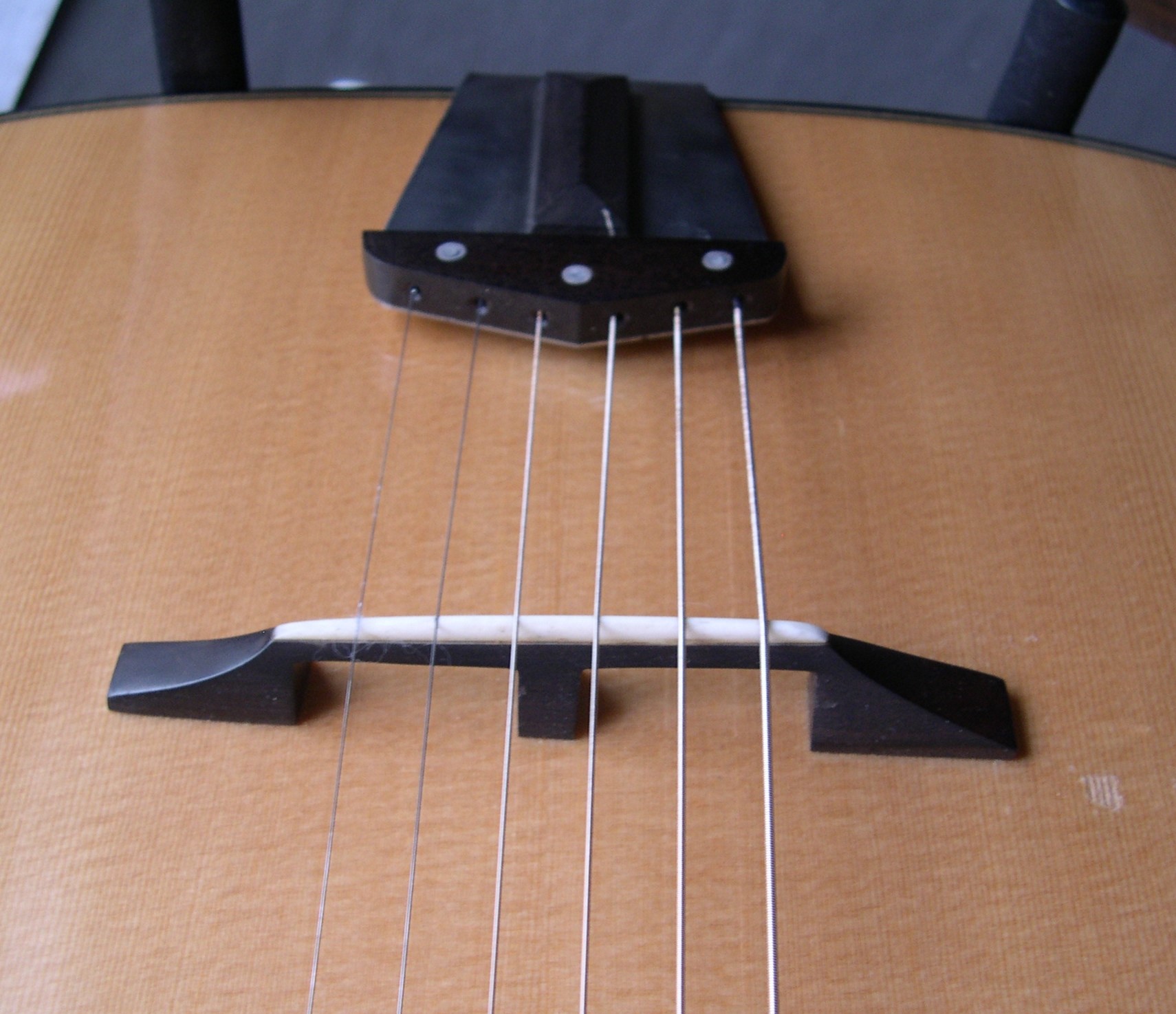

    I'm a tinkerer and always think that I can make improvements on anything, guitar, amp, motorcycle, whatever. This bridge and tailpiece were made for a maple Saga. The bridge was originally all wood, but did not improve the sound, so I put the bone saddle on it. That did not especially improve the sound either. The tailpiece was a design prototype for an adjustable length tailpiece that I never got around to building. I wish I had tried this type of bridge on a guitar that didn't sound this bad to start out with. That guitar was weird, when you picked it up by itself it sounded OK, but next to a good guitar, no thanks.

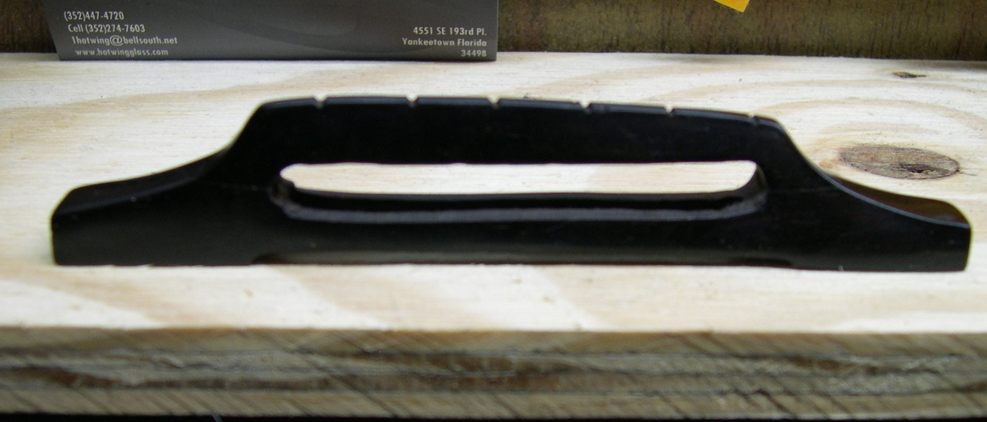

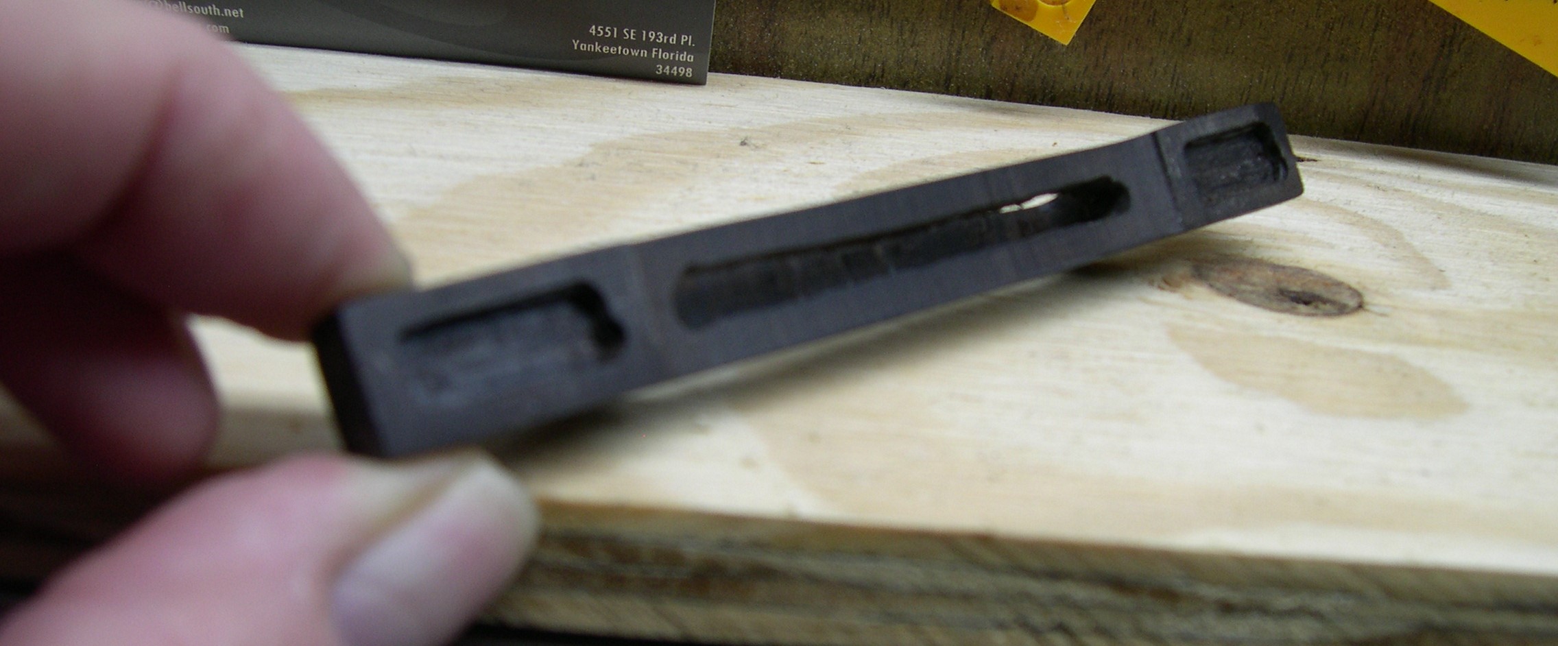

    I made this bridge for my mid-80s Favino, a guitar with a dark and ringy tone with it's original rosewood bridge. This was the last of several bridges I made for that guitar, using different ideas I had, and it worked pretty well for me. I liked the essential dark tone but wanted to air out the sound a bit. I played fairly far from the bridge near the center of the sound hole and this bridge gave me almost exactly the tone I wanted. It was structurally sound and did not deflect much under a load, and I always intended to make an even lighter bridge by opening up the slopes above the feet and removing even more wood, but because I liked this one so much I never got around to it. The guy who bought the guitar put the original bridge back on it, though.
    I guess the point here is that there's no harm in swapping a bridge or otherwise trying out new things. Sometimes they work and sometimes not, but the process is always fun.
