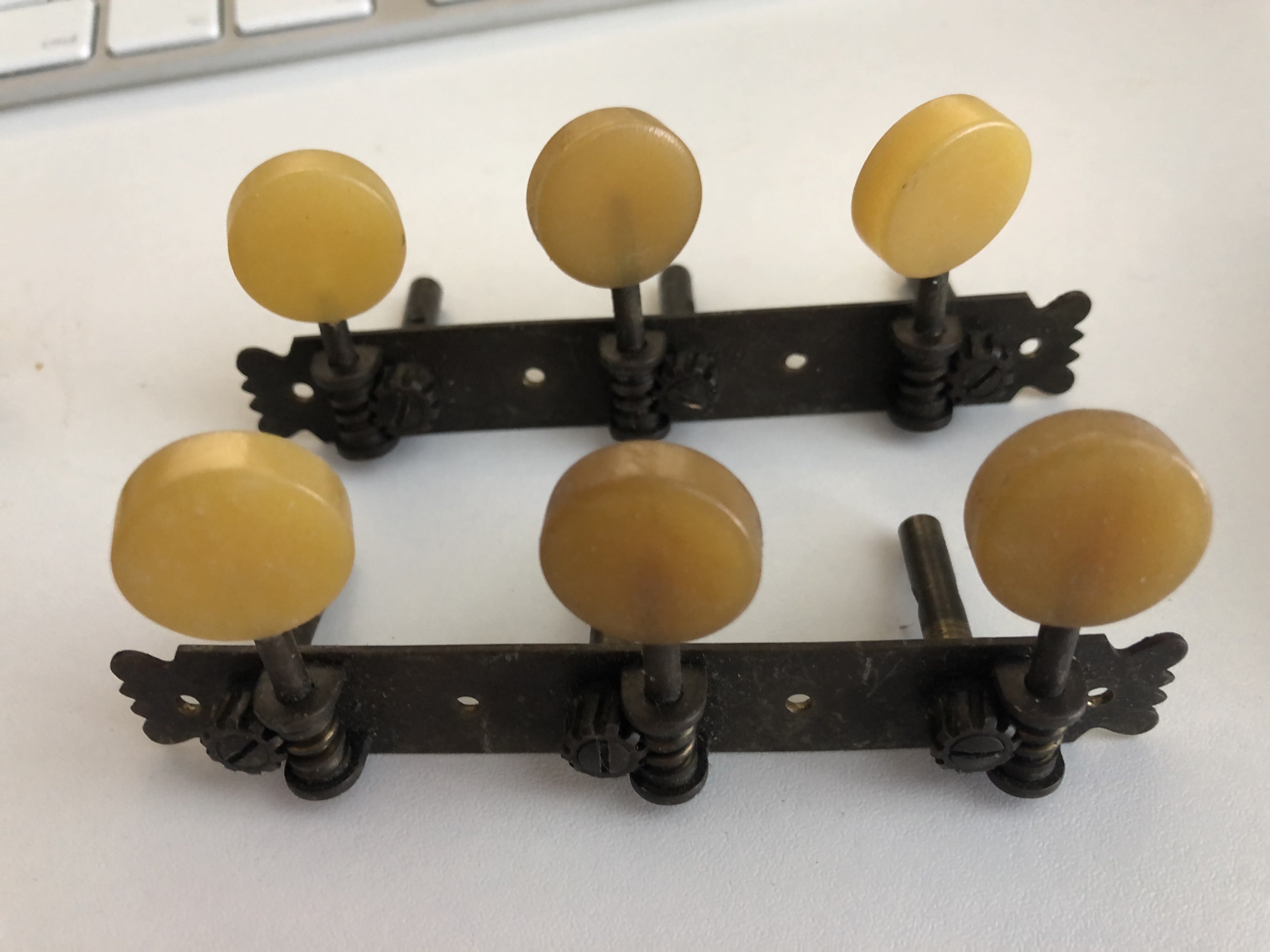

Hello everyone, I'm searching four spare buttons for a pair of Delaurelle tuners of my Di Mauro, might someone have some?
They have a diameter of 1,8 cm ( 0,70 inches) .

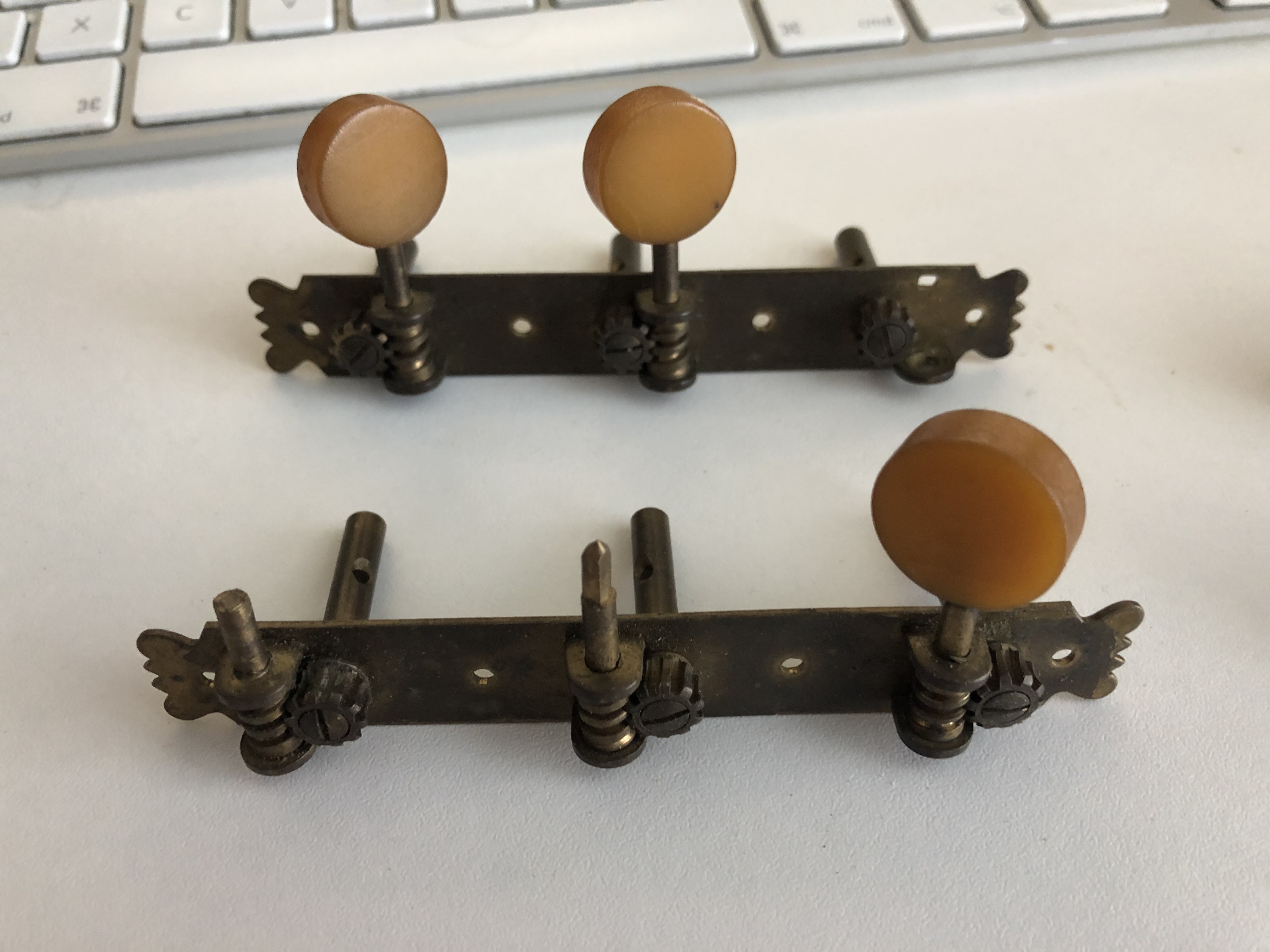

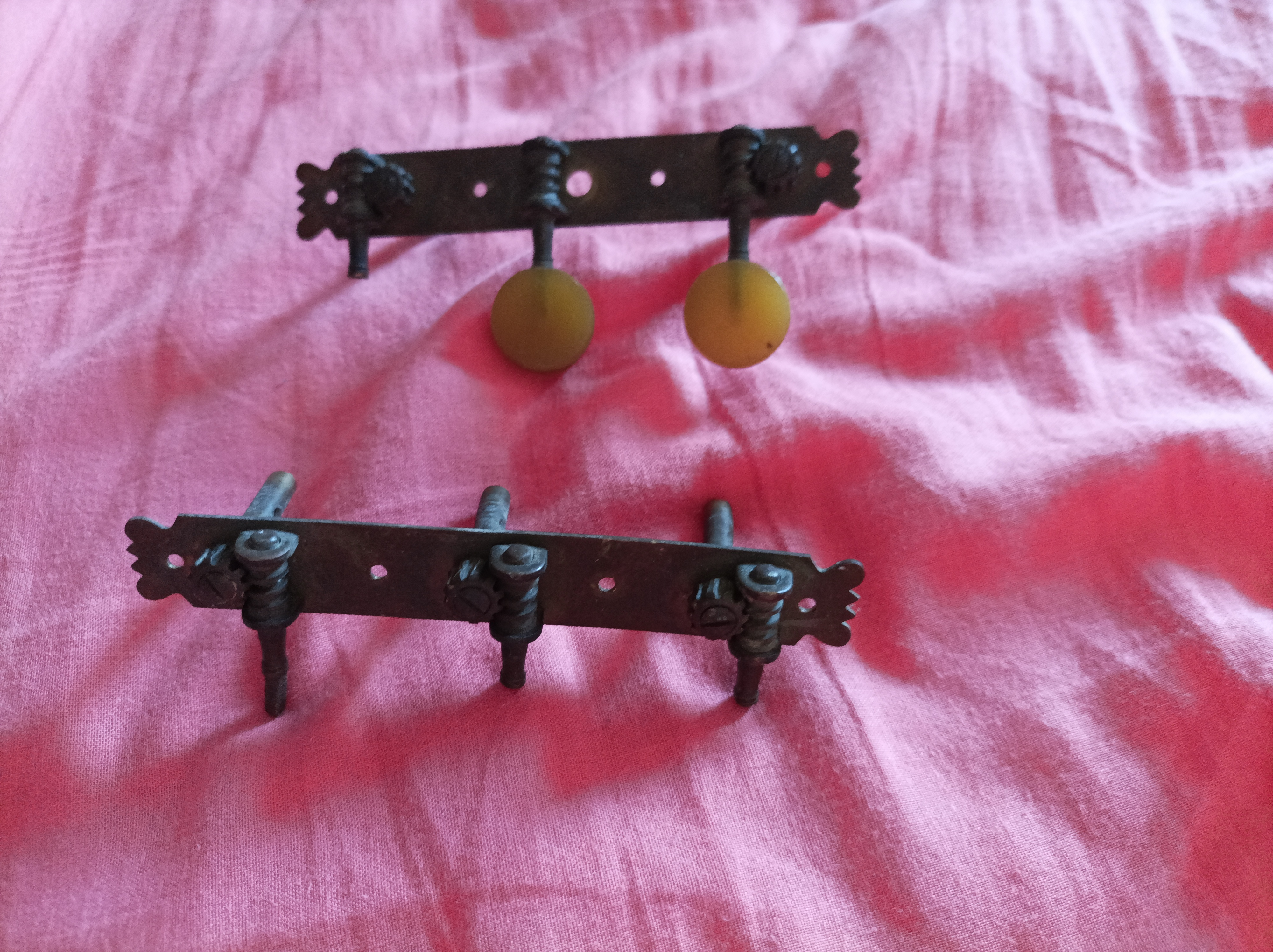

    It looks like 3 of the little posts that go up into the holes on the knobs are broken off??? Not much that you can do to fix that. Nothing for the buttons to attach to.
  • elianuelianu New Caponnetto Di Mauro
    Posts: 46
    My idea was to weld a little piece of brass there and shape it a bit with a file. Might be a crazy thing to do.
