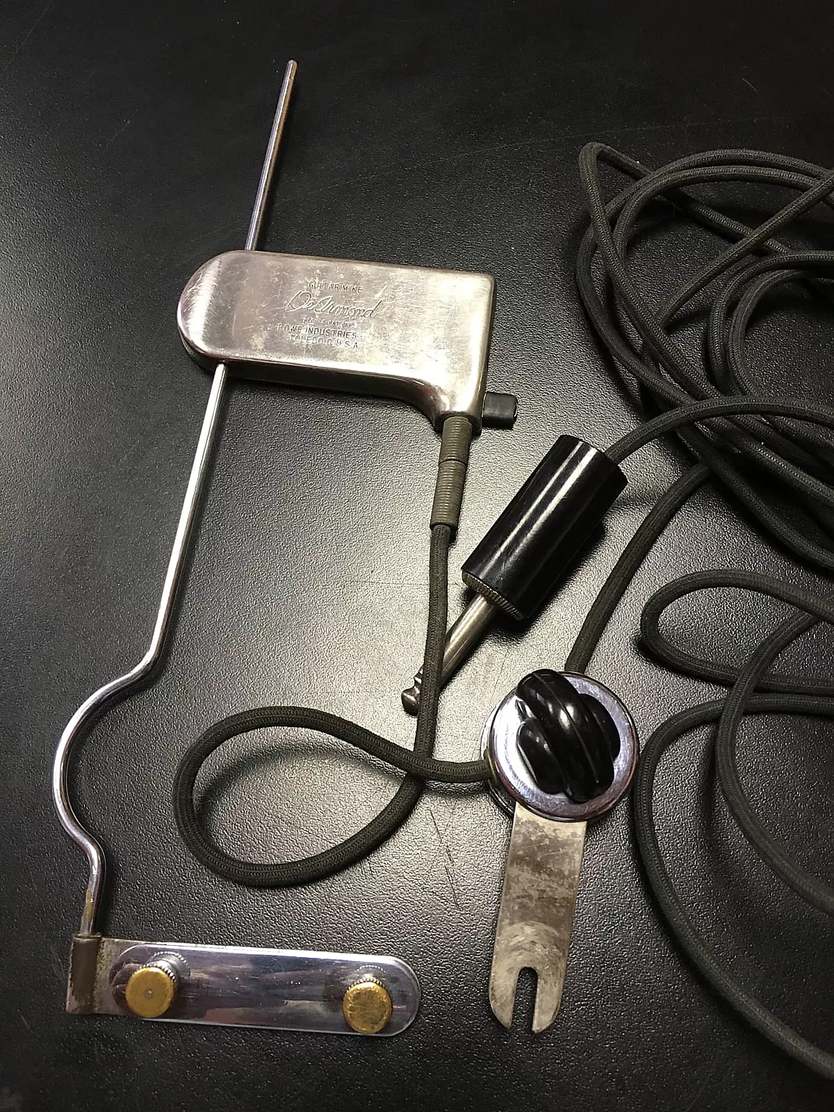

    It's a DeArmond "Monkey on a stick" pickup. The ones made after 1945 had two slots in the pickup cover, so Django has one of these earlier ones. There's a comparison video of different pickups here and you can instantly compare the cleaner sound of the Stimer with the more distorted sound of the DeArmond. https://www.youtube.com/watch?v=b__7Ty9JNh4

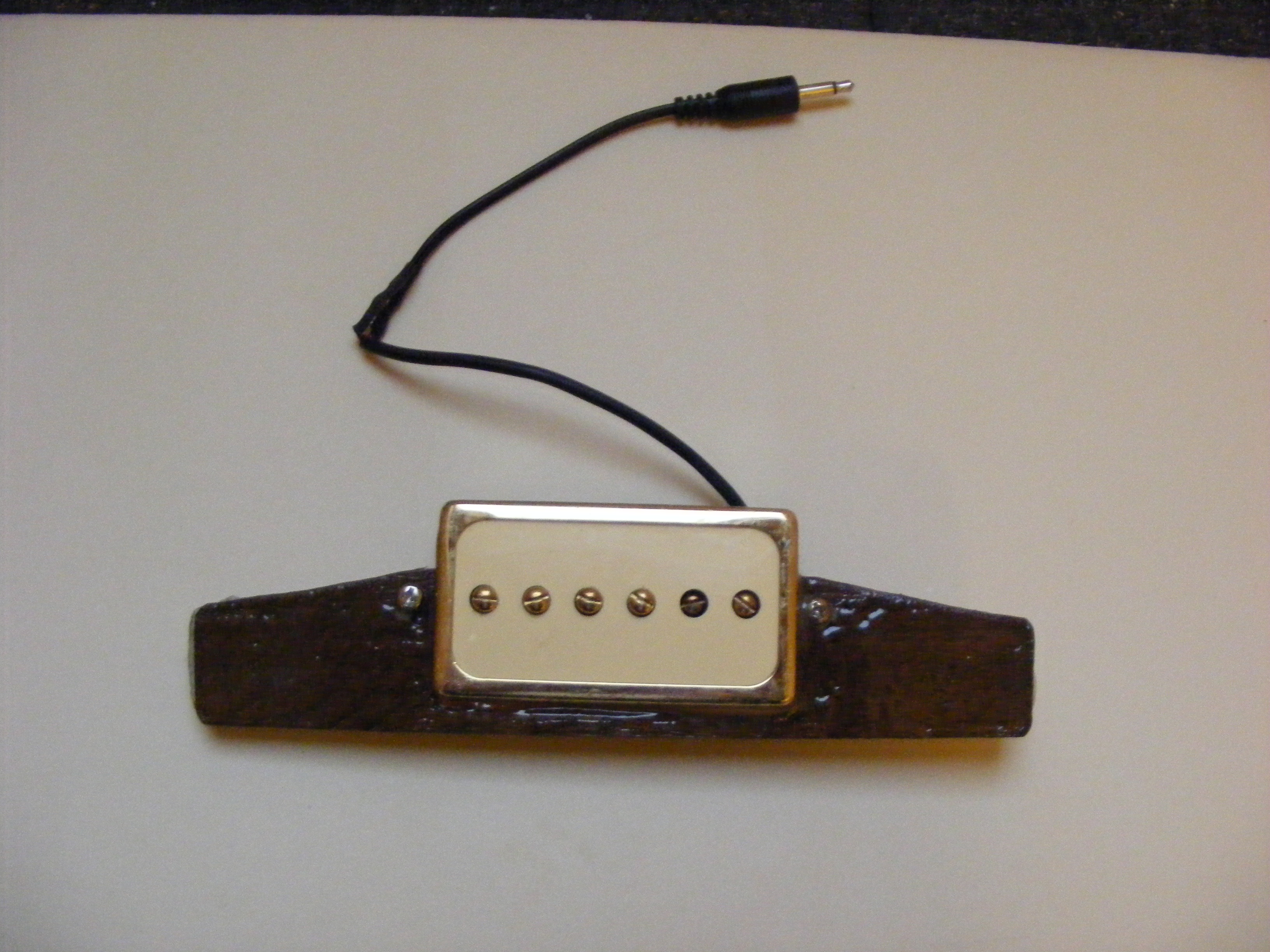

    oh man, is there anything similar on the market? i hear in reality these kind of pickups have bad string balance besides the peche a la mouche (or whatever it’s called) but i hear that’s more on the clean side
    Posts: 1,686
    That dirty overdrive sound comes more from your amp than the pickup.
    It does seem as though the DeArmond in that demo video is more distorted than all the others, although maybe the effect is exaggerated a little because he's playing double stops there

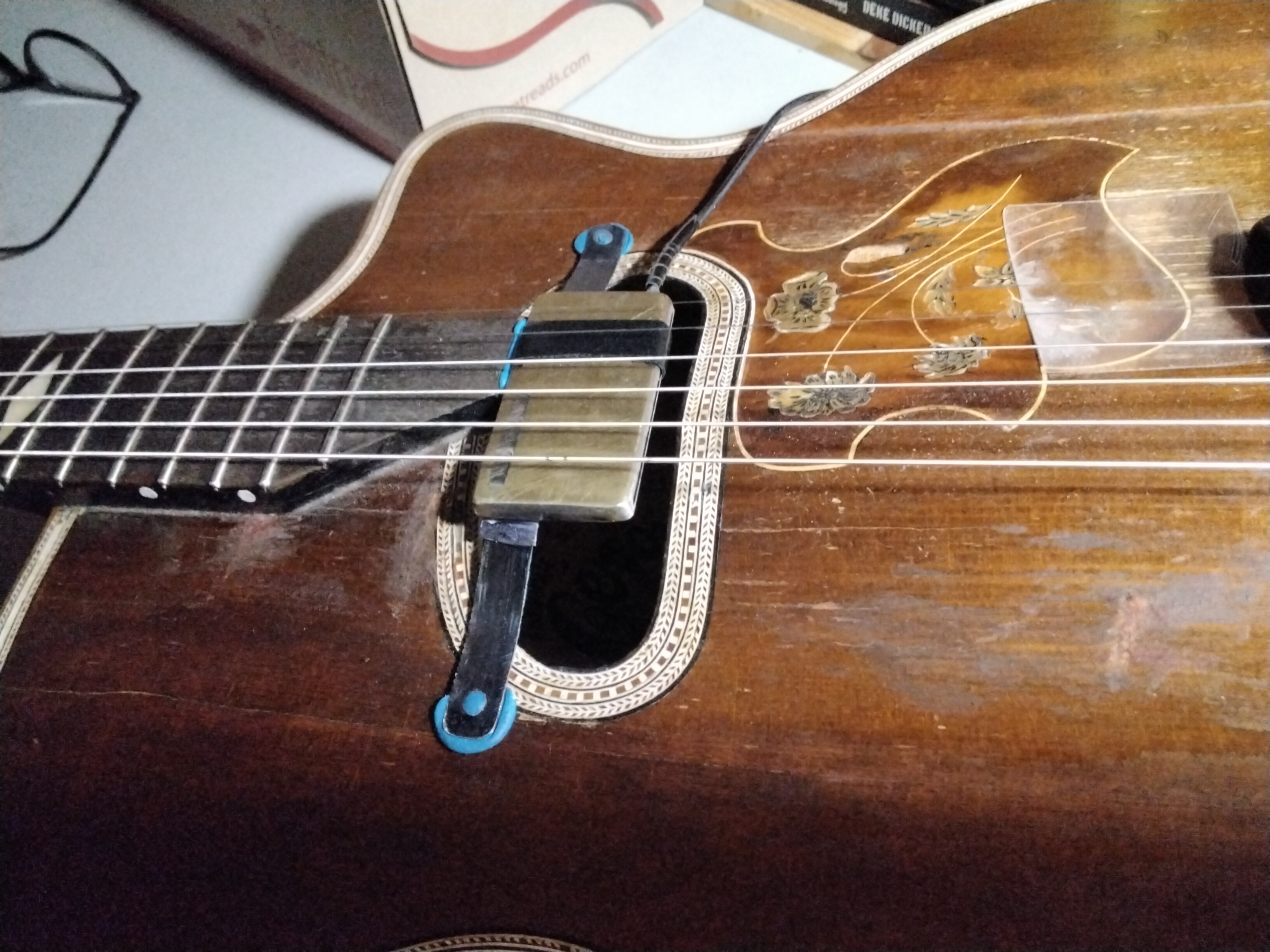

    Posts: 940

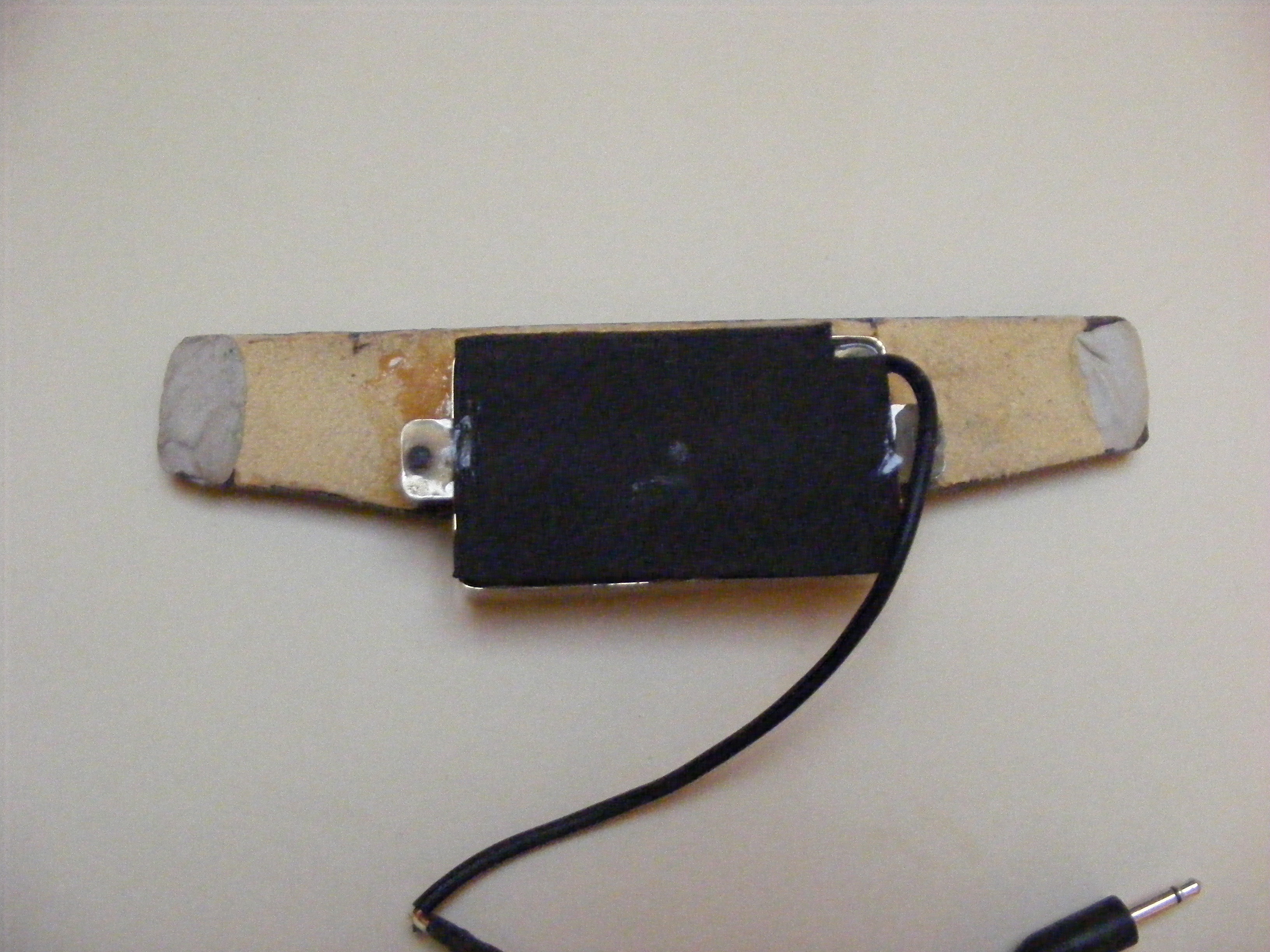

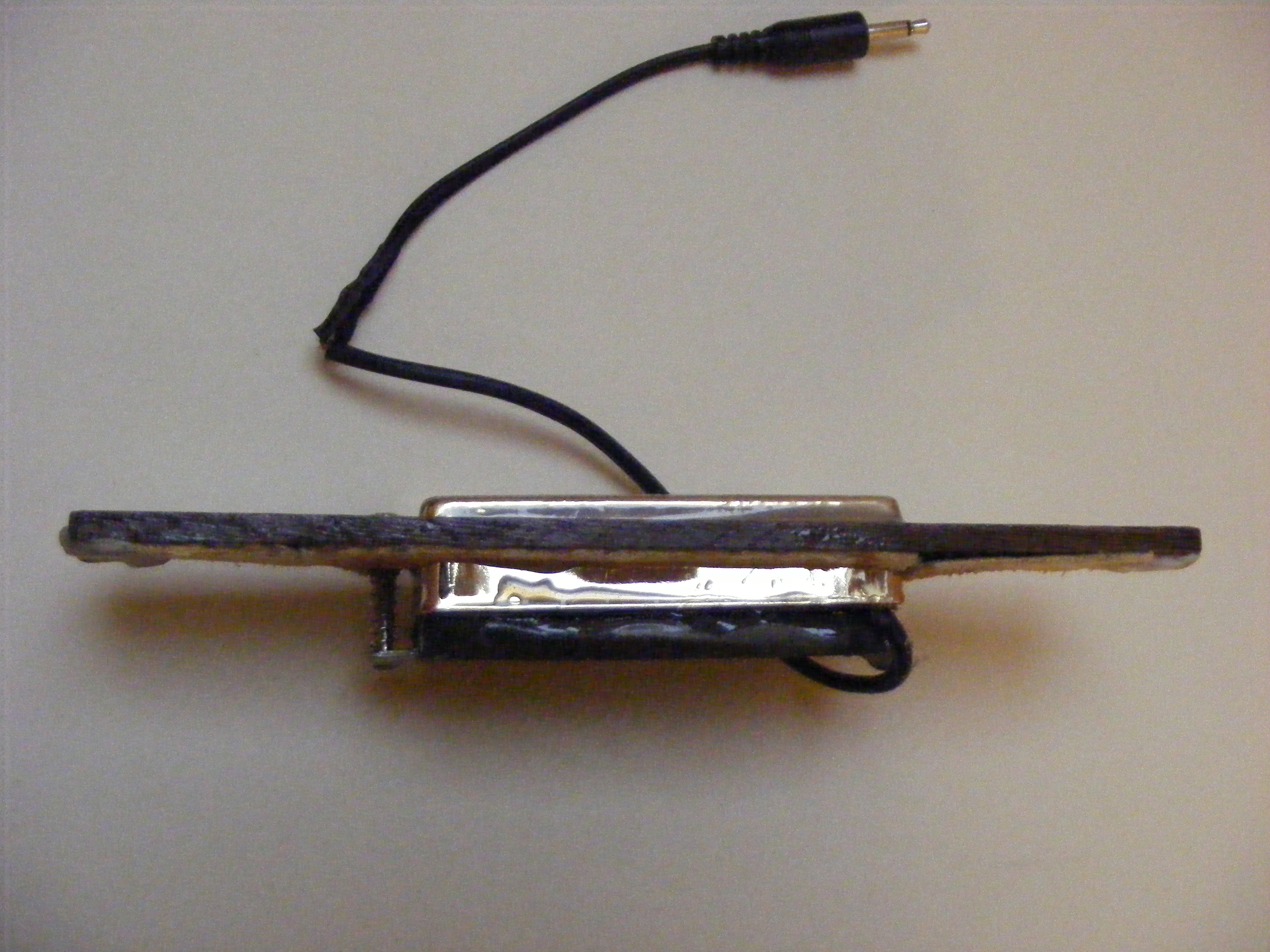

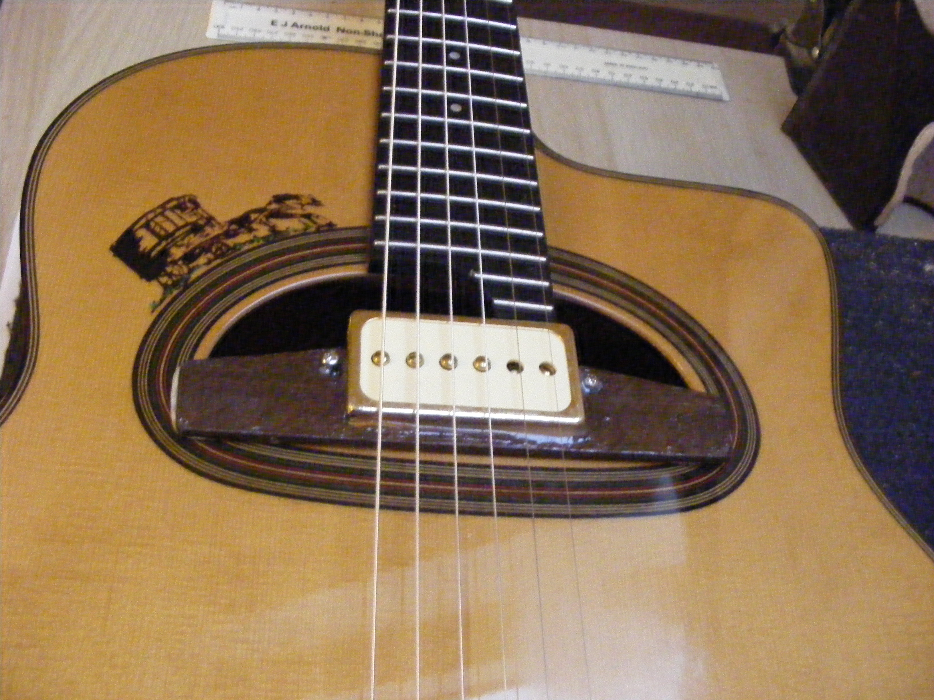

    I think the Gabojo Kleio pickups are well balanced. I agree with Wim the overdrive sound comes more from the amp as most of the modern pickups are not high output. I've gone down a different road and have just mounted a humbucker in a wooden frame and this simply sticks to the guitar top with blu tac/magic putty. That way I have the ability to balance out the strings by adjusting the pole pieces. The down sides are that it will only fit on a d hole and I had to cut off the last two frets to get enough space to fit it in. But then I was never up that end of the fingerboard anyway.
