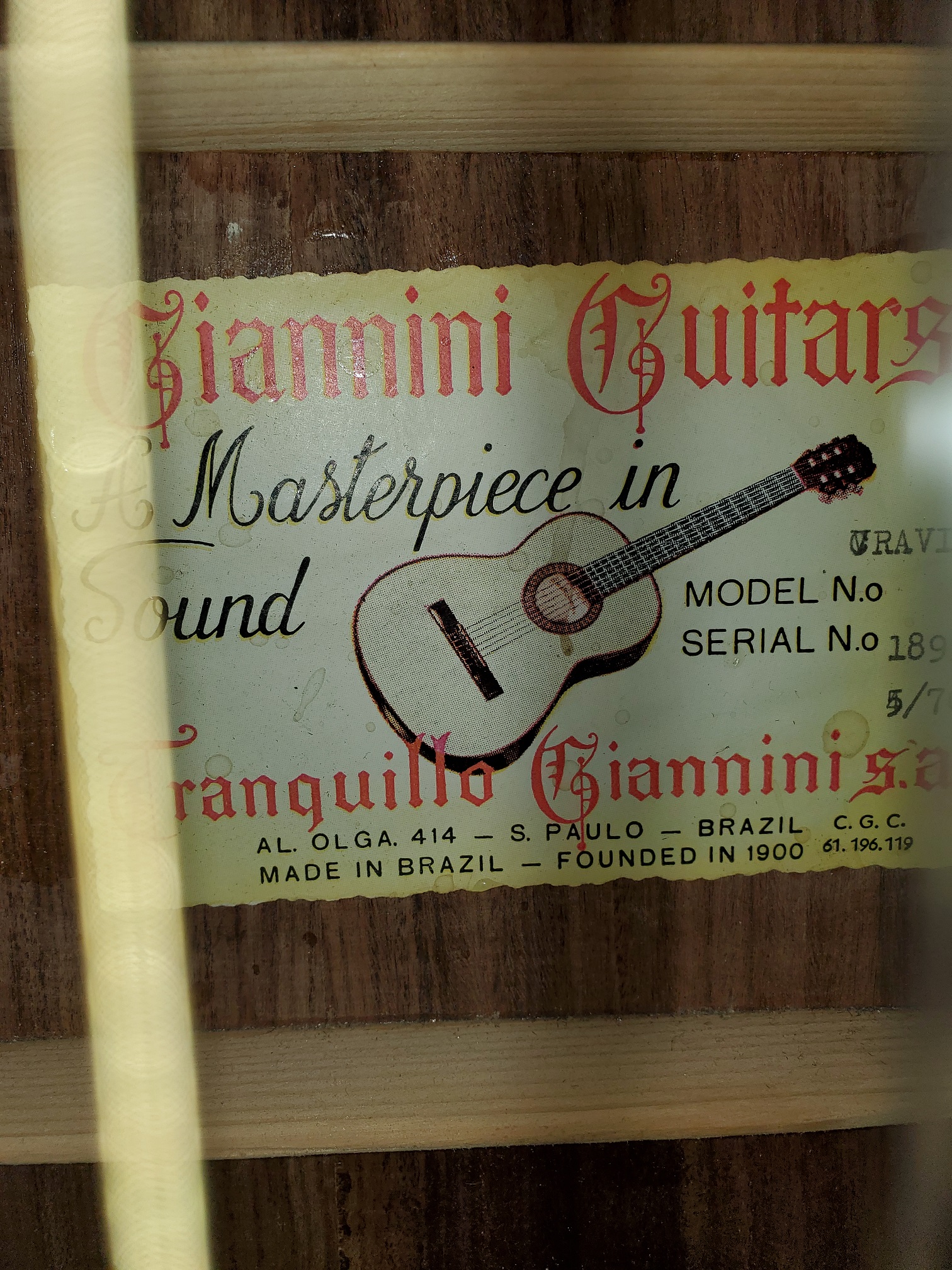

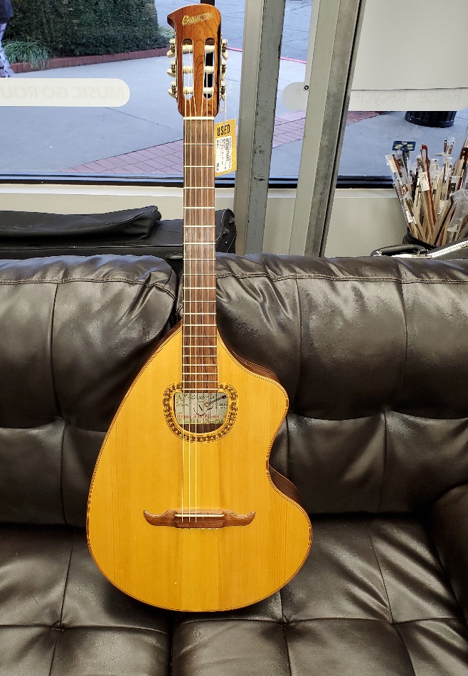

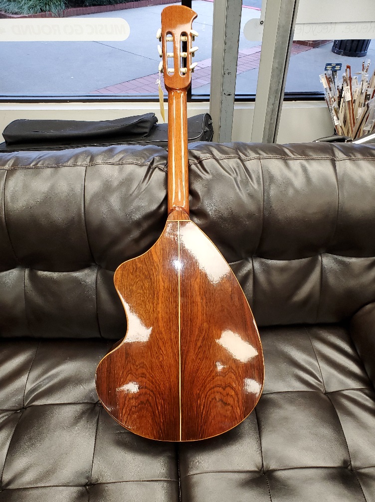

Look what followed me home from Music-Go-Round last night... a Giannini Craviola made in Brazil!!! Wonderful sound and condition, manufacture date 5/1970. Neck is 1-7/8" at the nut and a little chunky, feels a lot like a gypsy neck. Responds well to my gypsy technique.
No electronics on this Craviola. Looking for ways to amplify this nylon-string beauty. Any suggestions?

    Magnetic pickups won't work but a piezo or a (maybe clip on lavalier) mic should work I guess. Nice find!

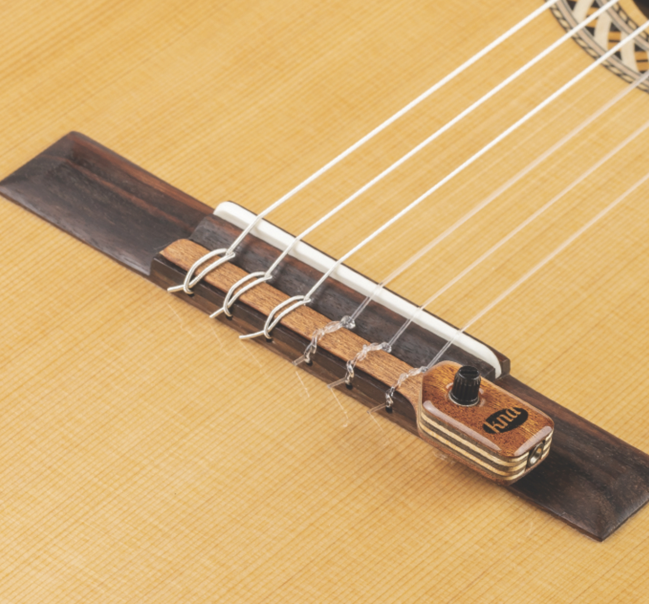

    These are pretty decent for the price: https://www.knapickups.com/en/guitar/uke-pickups/nylon-string-guitar-pickups
    they go on the bridge with wrap around nylon strings, and come the cable. Cheap and non-invasive.
    I had one on my DuPont nylon before installing an internal CS sensor piezo, which sounds great.
