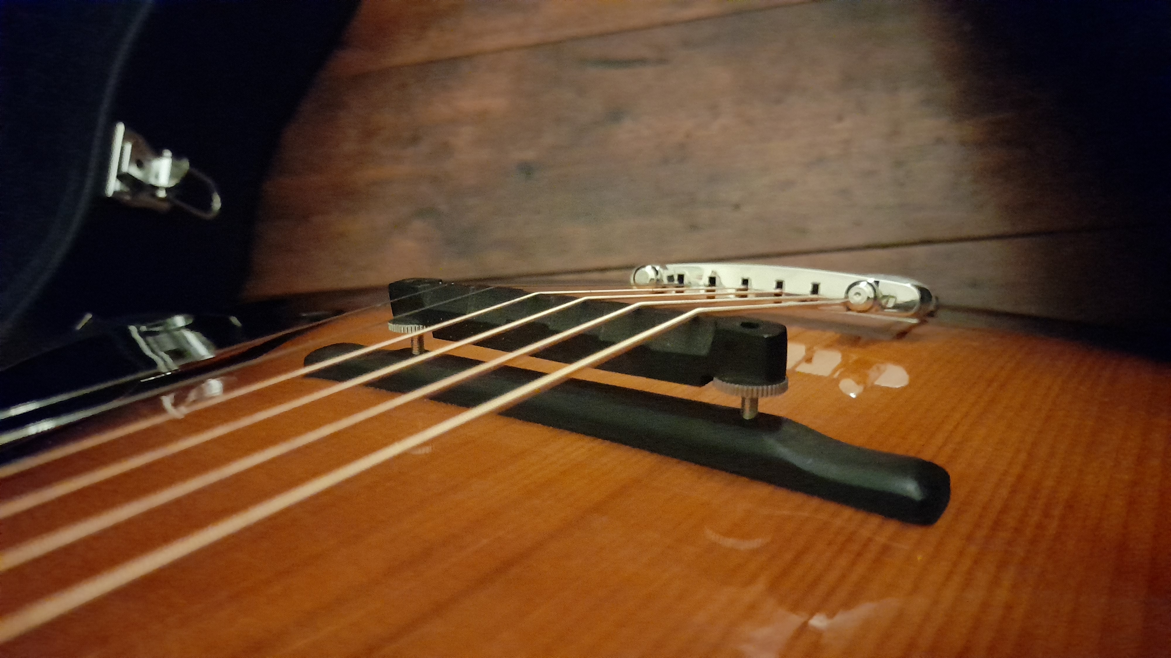

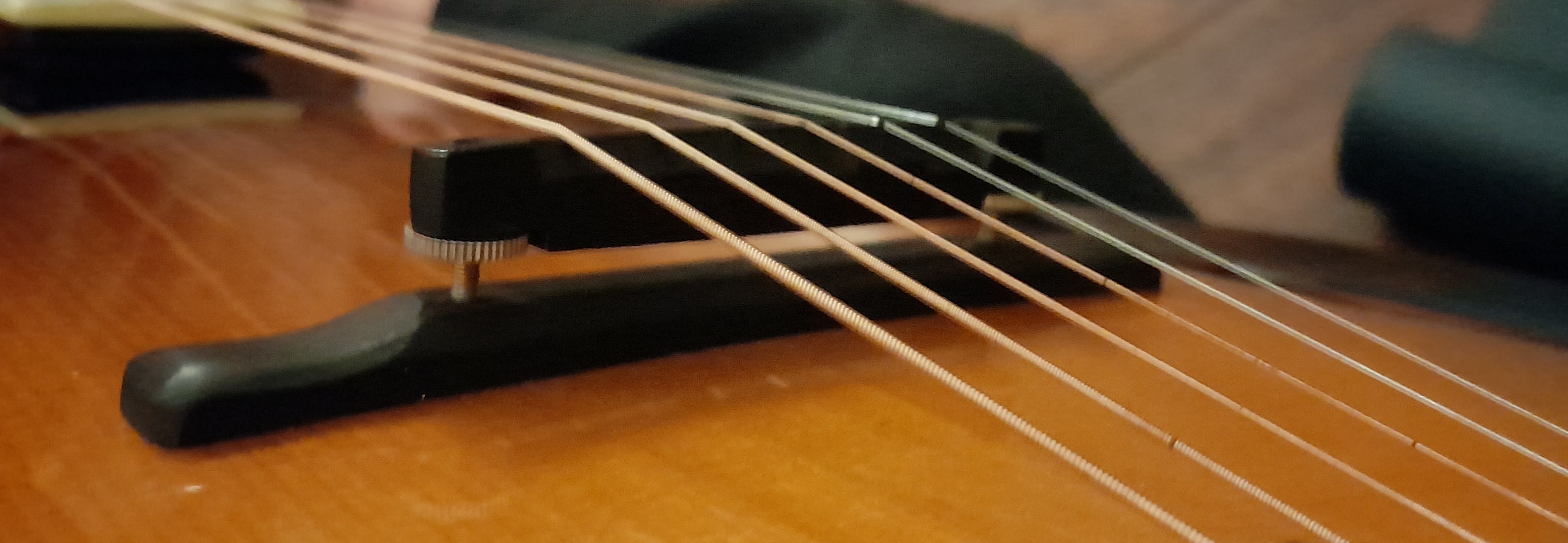

The guitar arrived yesterday after a rather nightmarish fashion and the first thing that stood out was how high the bridge was relative to the rest of the guitar's setup.
I've got the action set at about 2.2mm on the bass side and 2.0mm on the treble side, which suits me and I think sounds good.
But if you look at the two pics I've attached, the bridge is cranked up so high to allow for this relatively low action that it's slightly tilted forward and is barely still resting on the bridge pins.
Every floating bridge instrument I've ever owned has nothing like that much clearance between the bridge and base.
This just doesn't seem right to me. If anyone else here has gone for the above or a similar rhythm guitar setup with a Loar LH600, what was your guitar like out of the box?

    Maybe ask some of the YT reviewers what's their experience. As long as the neck and the rest seem solid, you could replace the bridge.
    Posts: 203
    A very slight lean isn't uncommon on archtop bridges, especially when the posts are that exposed. It usually isn't a big deal unless intonation is being compromised. Most people I've talked to about these guitars have said they needed quite a bit of bridge/fret work out of the box to get them into playing shape.
  • Posts: 6,098
    Better yet, let it settle in for a few months then have all wood bridge made for the guitar.

    How's the neck relief? If the neck happens to be too straight, or even back-bowed, then a slight loosening of the truss rod would improve the neck relief and also raise the action slightly, allowing you to lower the bridge height.

    The neck relief could be better and I think a new bridge would be a good idea. I had a new bridge made for my GJ guitar and it made an enormous difference.
    As is, the Loar plays well. The intonation is good for the 3 and 4-note big band swing chords I play and it speaks well, too.
    I'm going to take it round to a luthier I know on Tuesday for his advice and enquire about a new bridge and adding a pick guard / scratch plate. Once that's done, hopefully he can fit the pickup as well.

    My luthier says he reckons the wrong bridge was put on the instrument at the factory, but he can easily put things right.

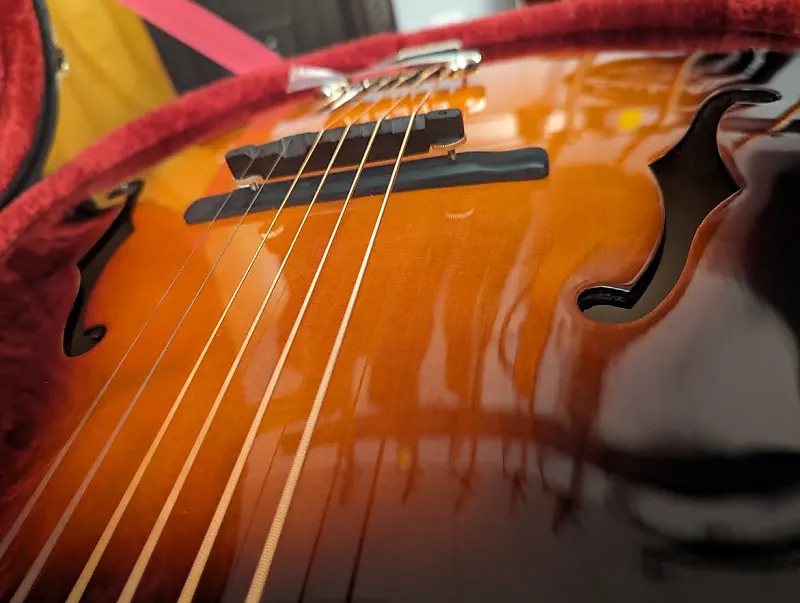

    I got the luthier to build up the base of the bridge and that has helped - some.
    He also tried adjusting the truss rod, but it's buried so far back into the neck, it can't be seen with the naked eye. :(
    He had to take an alternative Allen key to be able to reach the truss rod. He then found that it only turns slightly each way, so there is no realistic way to adjust the relief. It's still a flat neck.
    Now that the guitar has settled and I've had more time to play it, it's clear that it doesn't intonate well the length of the neck. If I tune it so that basic barre chords (barre chords based on the low E string), some of the chords are more or less in tune (but not completely), but they vary at different points on the neck. The secondary barre chords (based off the A string) are very out of tune. Very out of tune.

    I don't know anything about these guitars. Never seen nor played one. But, I just saw this listing on Reverb for the same model as yours. And it shows an adjustable bridge at a pretty high setting as well. So, that leads me to think either that is supposed to be normal for their setup or something is up with the design. It does seem to be odd to me that you'd have those two narrow threaded dials supporting all that tension and torque.
