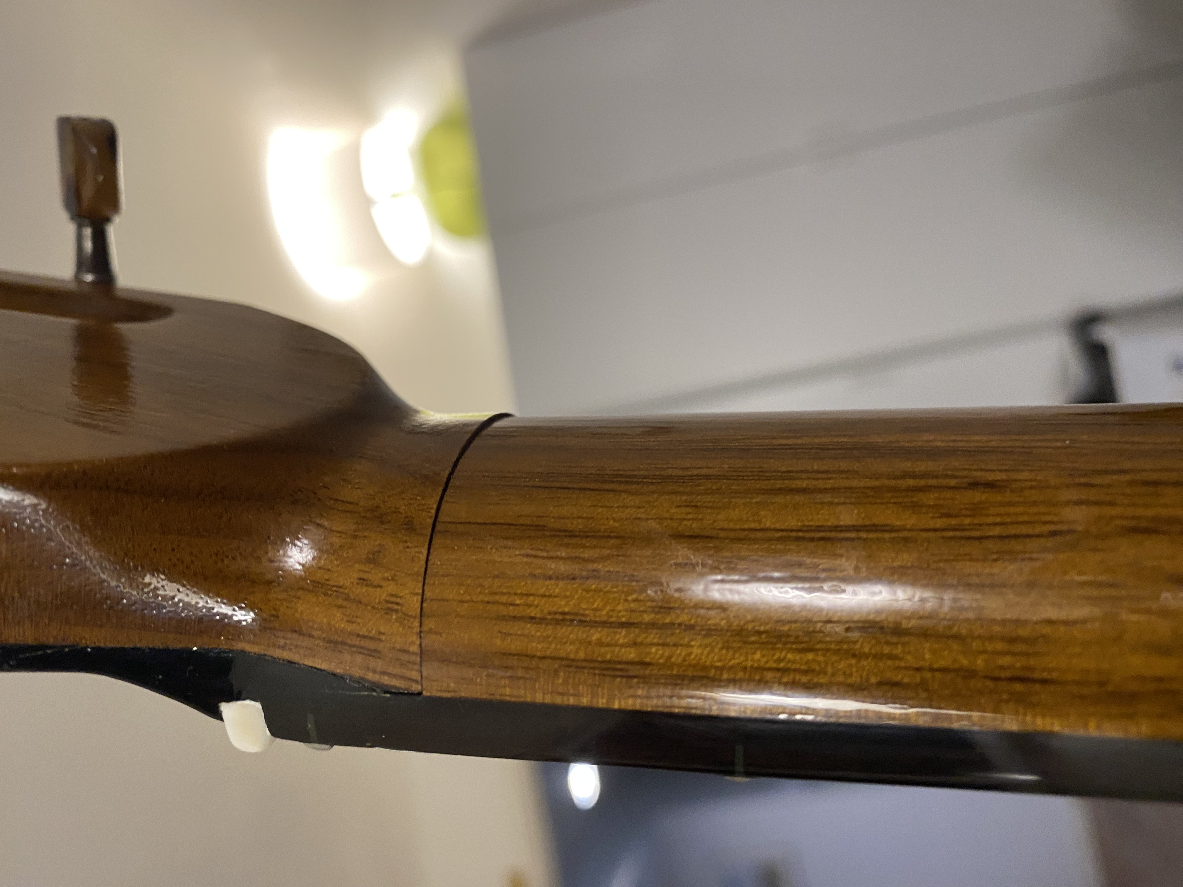

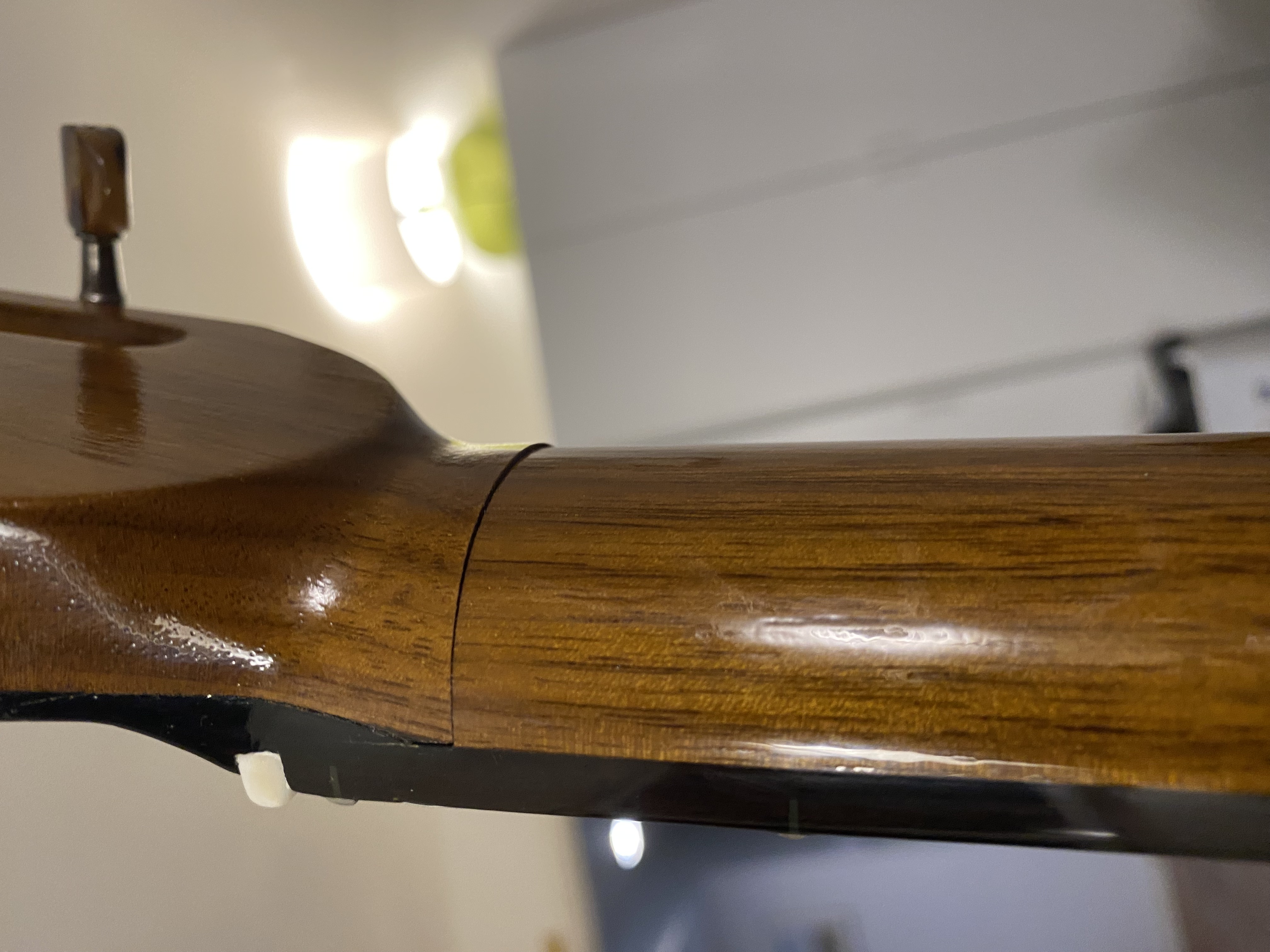

I have a repair question and I would appreciate getting anyone's wisdom before I hand my guitar over to a luthier.
My Stringphonic Advanced model suffered a fall and now the seam between the headstock and neck has cracked/opened—though it snaps back into place.
What’s the best route for repair with breaks like this?

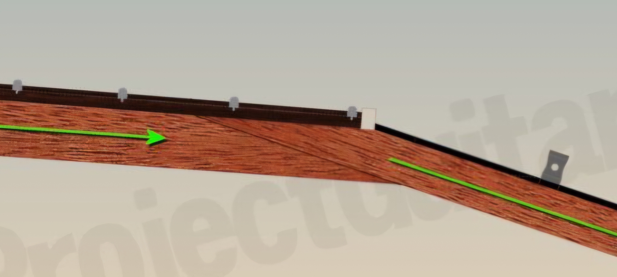

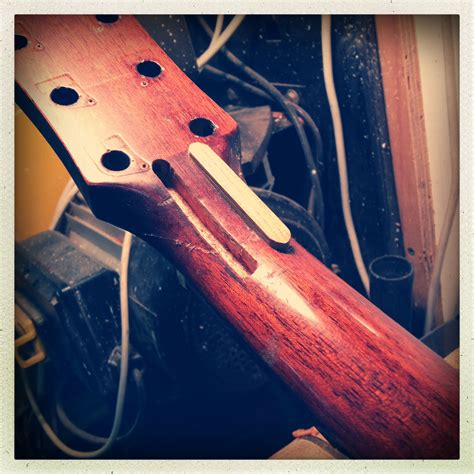

    Seems to be whenever you see a neck joint failure on these types of guitars its on that original selmer type neck joint. some interesting info on it on Frank Fords site http://www.frets.com/FretsPages/Musician/Guitar/JazzStyles/SelmerFix/selmerfix.html

    Thanks for this! My local luthier--the only good one left--was not aware that the headstock is joined with a tendon joint.

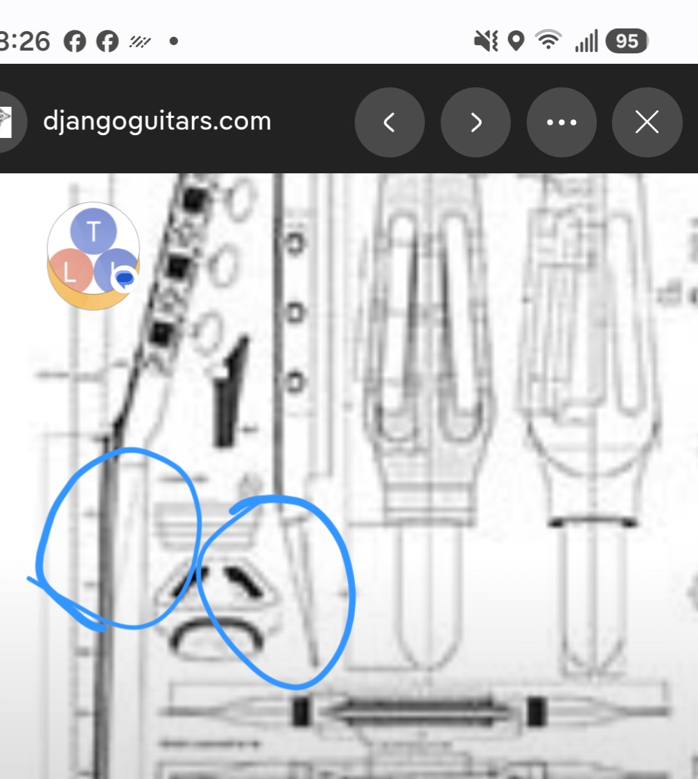

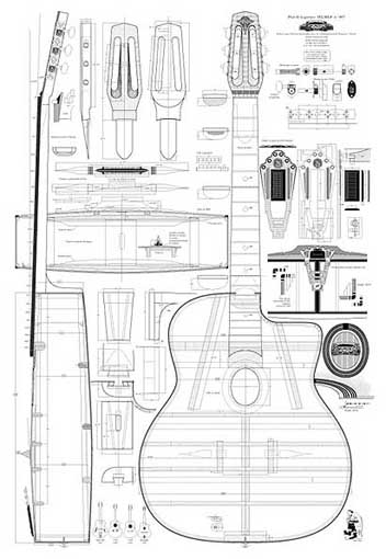

    Plans are easily looked up. Not a high res version but the headstock joint is visible
    BillDaCostaWilliams
    Posts: 940
    This is a totally weird Selmer specific joint. I'm not sure if any other type of guitars have it.
    I also don't know if the stringphonics use the joint as pictured or in some other internal design.

    My friend also has Stringphonic Advanced and the same thing happened to him. The guitar fell and the headstock came apart in a clean break. He brought it to a luthier who specializes on upright basses and got it fixed pretty quick. He said that it broke off cleanly and just had to be glued back and clamped. Very simple repair apparently and you would not know that it was repaired just by looking at it since it broke cleanly at that joint.
    Apparently this is pretty common with that type of joint and have seen it happen to several guitars from different builders who use that method.
